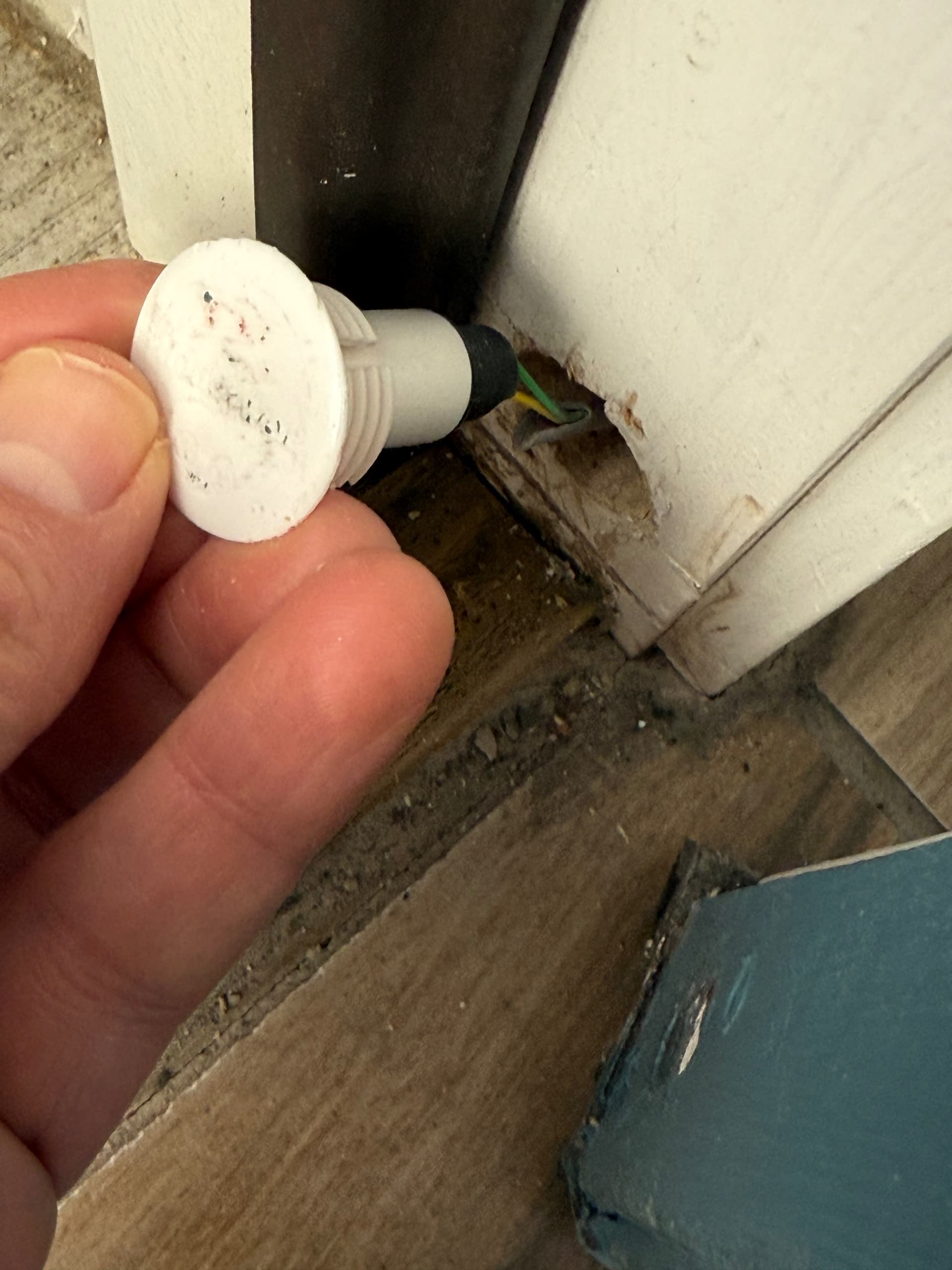

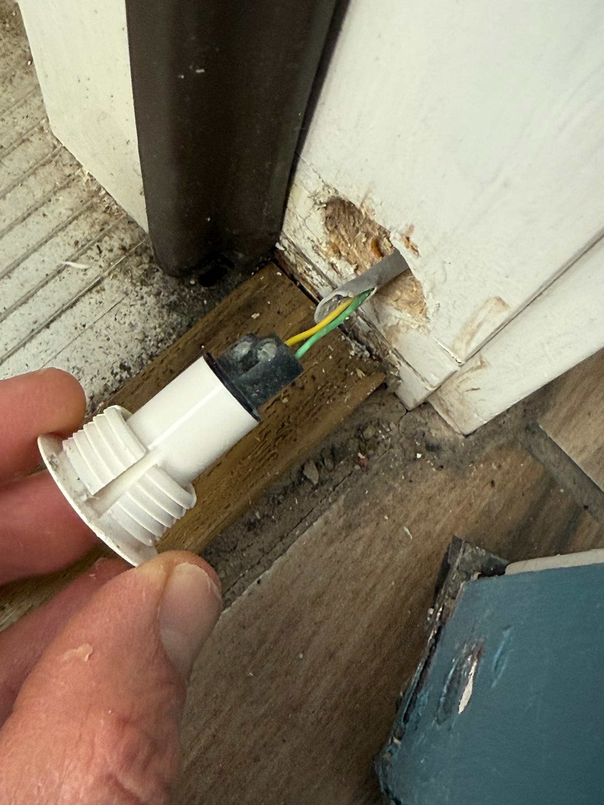

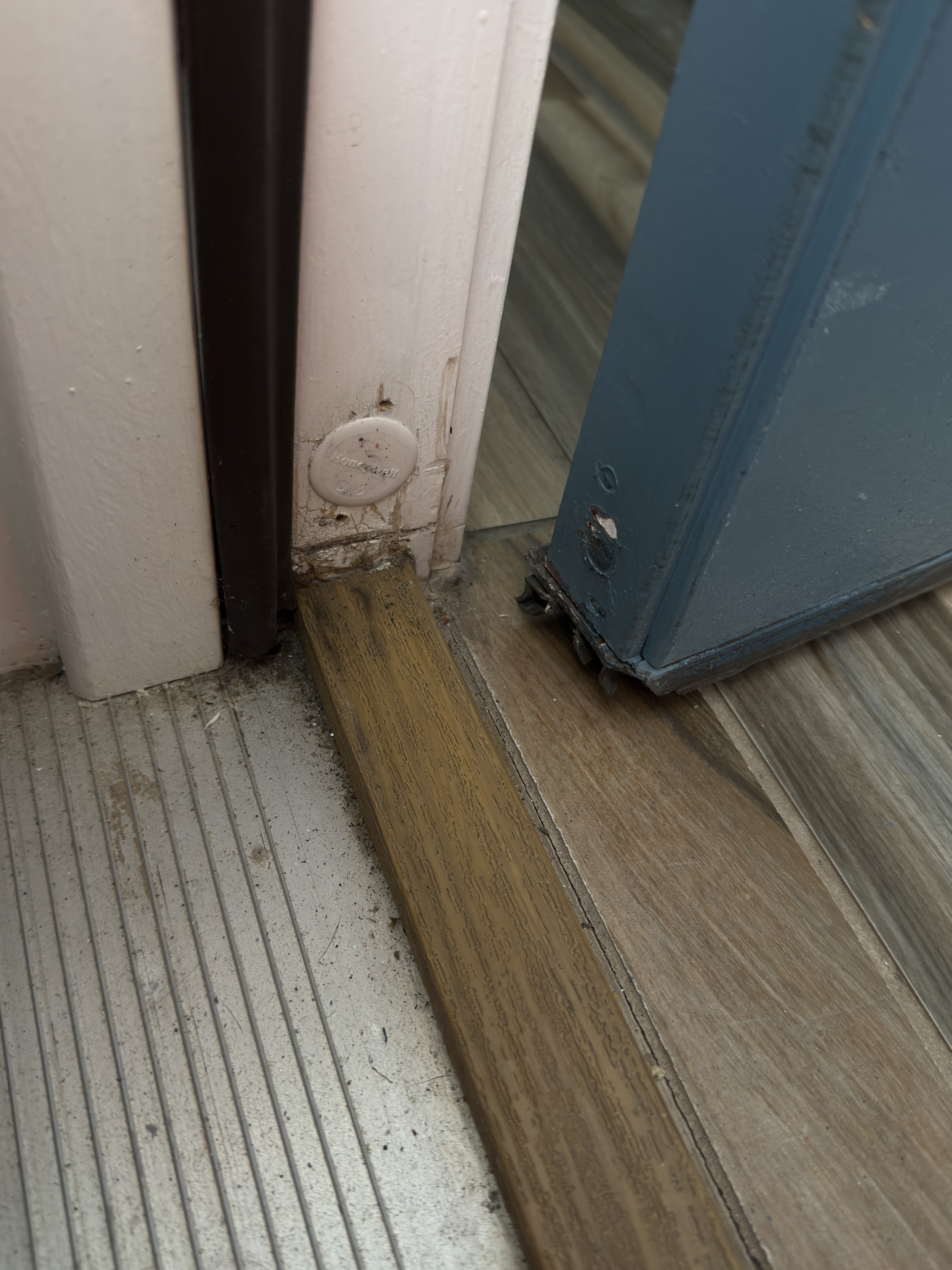

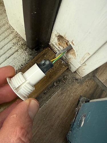

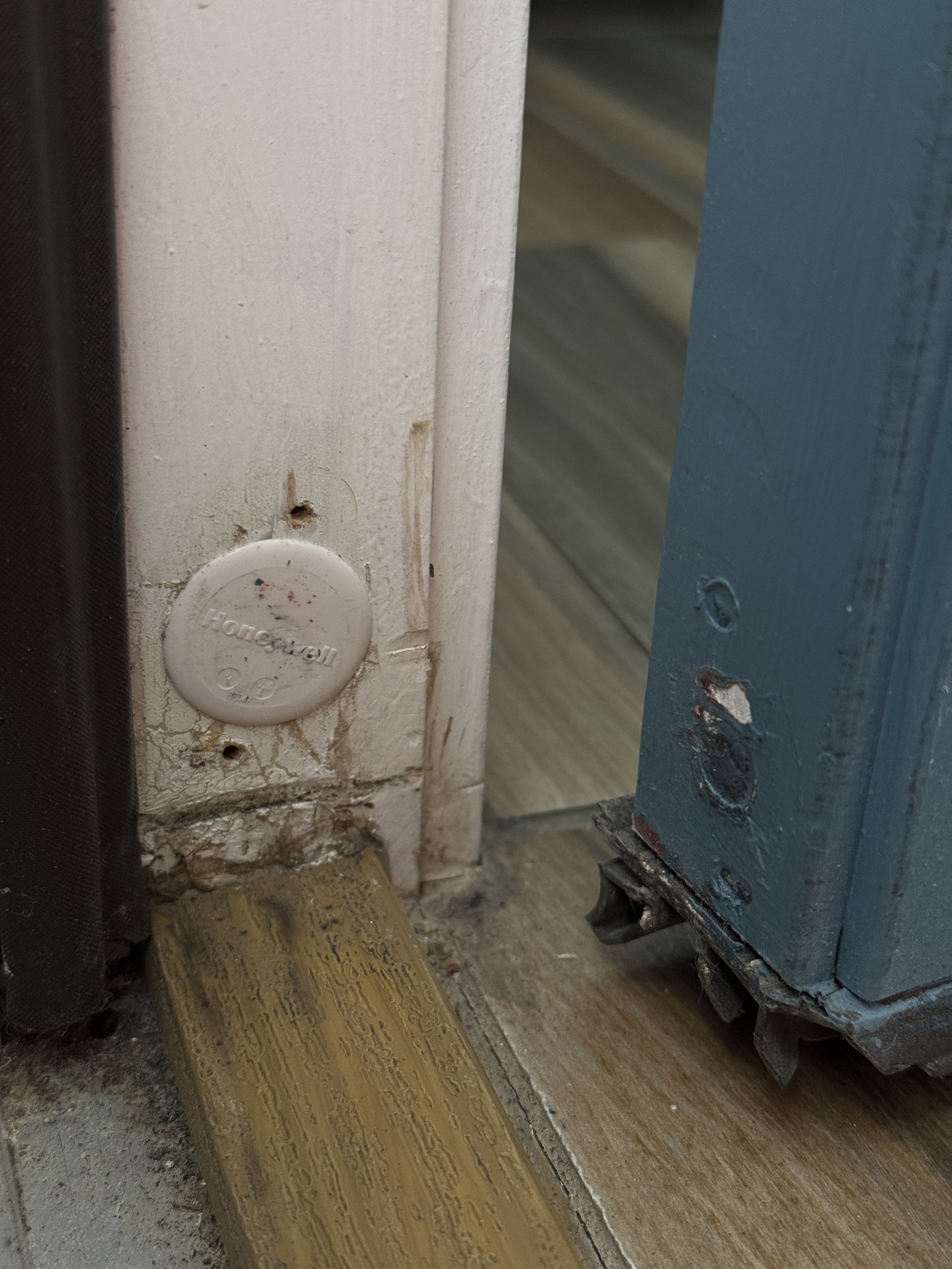

I believe this is a wired sensor - photos of door install attached.

I feel like you most likely have an issue with your front door. You will need to pull out that sensor on the door frame in order to troubleshoot.
Could you pull out the sensor and send us a picture.

Finally, I did take a look at the front door sensor (photos below). Nothing unusual and some basic testing today showed the sensor working normally.
One thing that may be contributing to the confusion, in addition to the sensor not being an entry exit sensor, is the placement.
A wired magnetic contact should typically be installed on the opposite side of the door. In your image it looks like it is installed on the side of the door with the hinges, is that correct?
When a magnetic contact is on the hinge side of the door, the door motion required to break the contact is much more than the handle side. The door can be opened a little bit without tripping the sensor, how far will depend on the sensor magnetic gap/strength of the magnet used.
If a magnetic sensor is on the handle side, the door may only need to be opened less than an inch to trip the alarm.
If the magnetic sensor is on the hinge side you may need to swing it open pretty wide before it triggers.
In this case, if you were not swinging the door open fairly wide when testing, that sensor may not be triggering.

And you are correct, that front door sensor is on the hinge side and likely explains why it didn’t trip previously.
