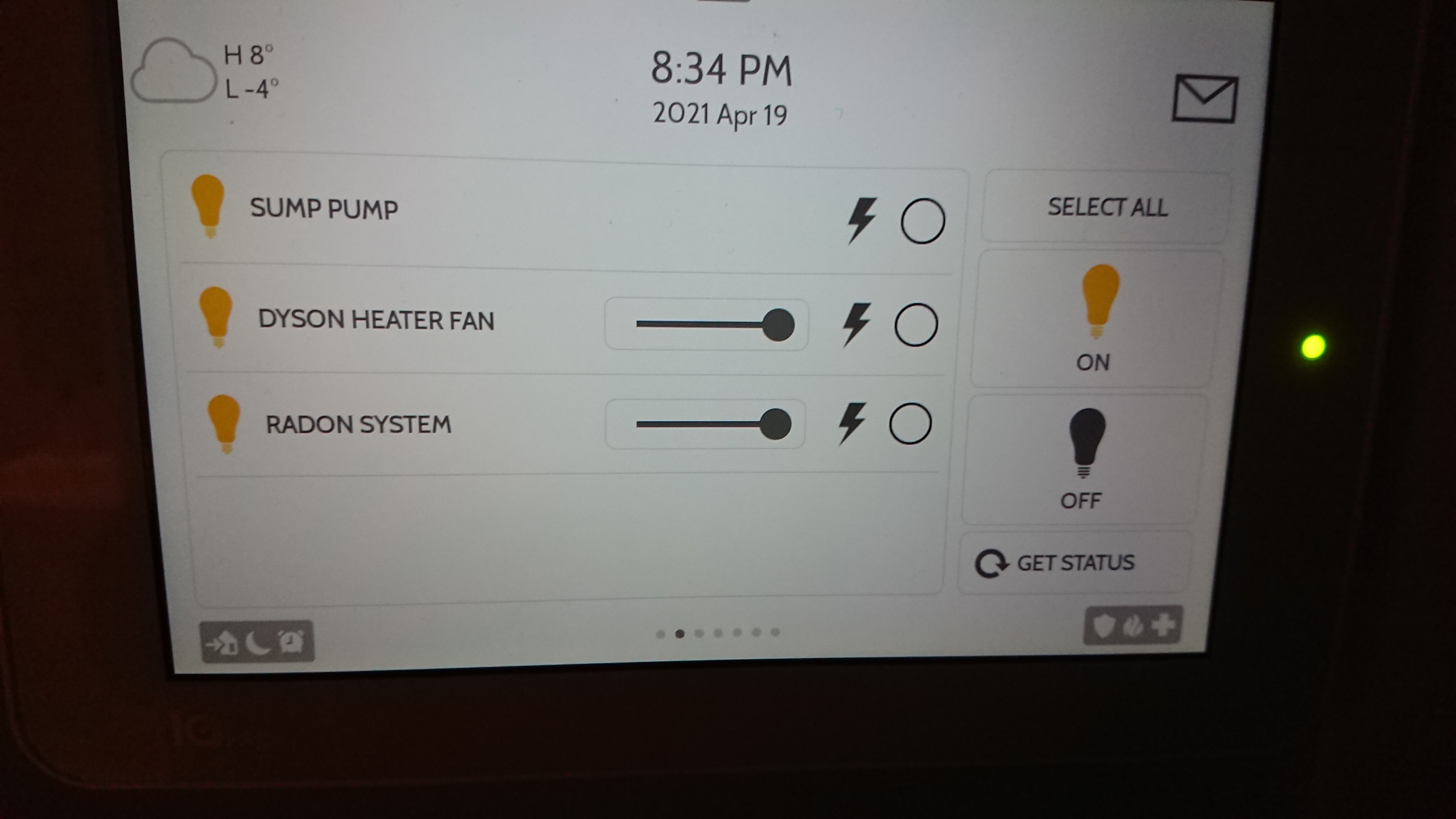

Hi, I noticed on the new firmware for the IQ2 panel, version 2.6.0, you can now dim your lights and/or switches at the panel with a slider. However, I have Aeotec Smart switches 6 which are not dimmable and sliding it does nothing. I’m just wondering if in any way, shape, or form does it actually lower the voltage/output of the Smart Switch, which I do not want. Thanks
If you have a standard on/off Z-wave switch, an errant dimmer slider would be sending Z-wave commands the device couldn’t process. The physical switch wouldn’t be equipped to alter the output.

Looks like this is a bug, as an Aeotec Switch 6 shouldn’t be recognized as having dimming capabilities. For example, before 2.6.0 it was not there, and after 2.6.0 the dimmer abilities showed up.

I just updated and I’m experiencing same
Issue. They show up as dimmers when pre 2.6.0 they did show correctly as non dimmers.

FYI they don’t show as dimmers on alarm.com app, only on the panel for me.
