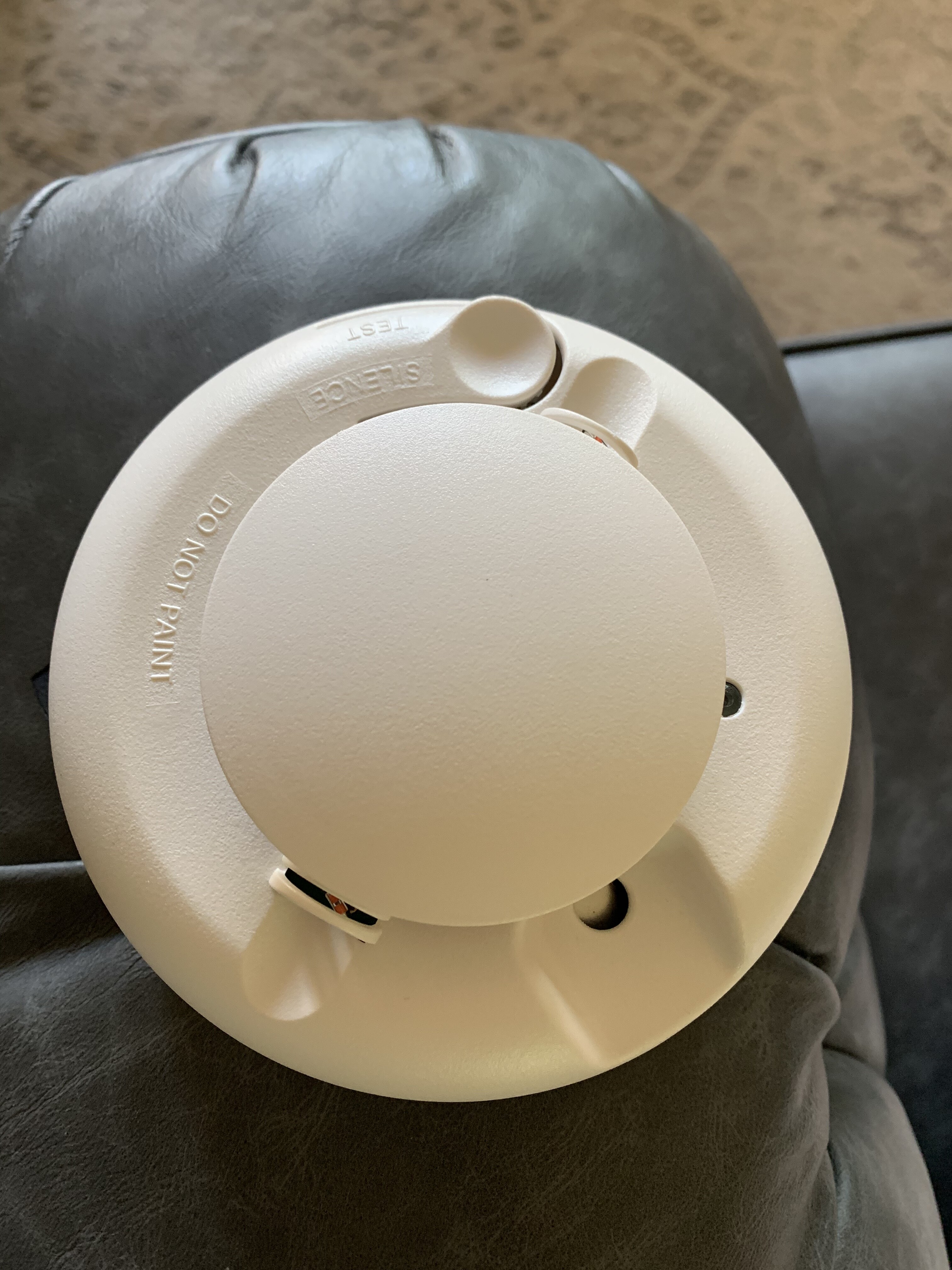

Smoke alarm is a Interlogix TX-8010-01-1
I currently have the panel off because I couldn’t get the alarm disabled. After I put the disarm code it will go back to alarm in about 10-15 seconds. The smoke alarm is down and laying on the floor without batteries. Hope this helps

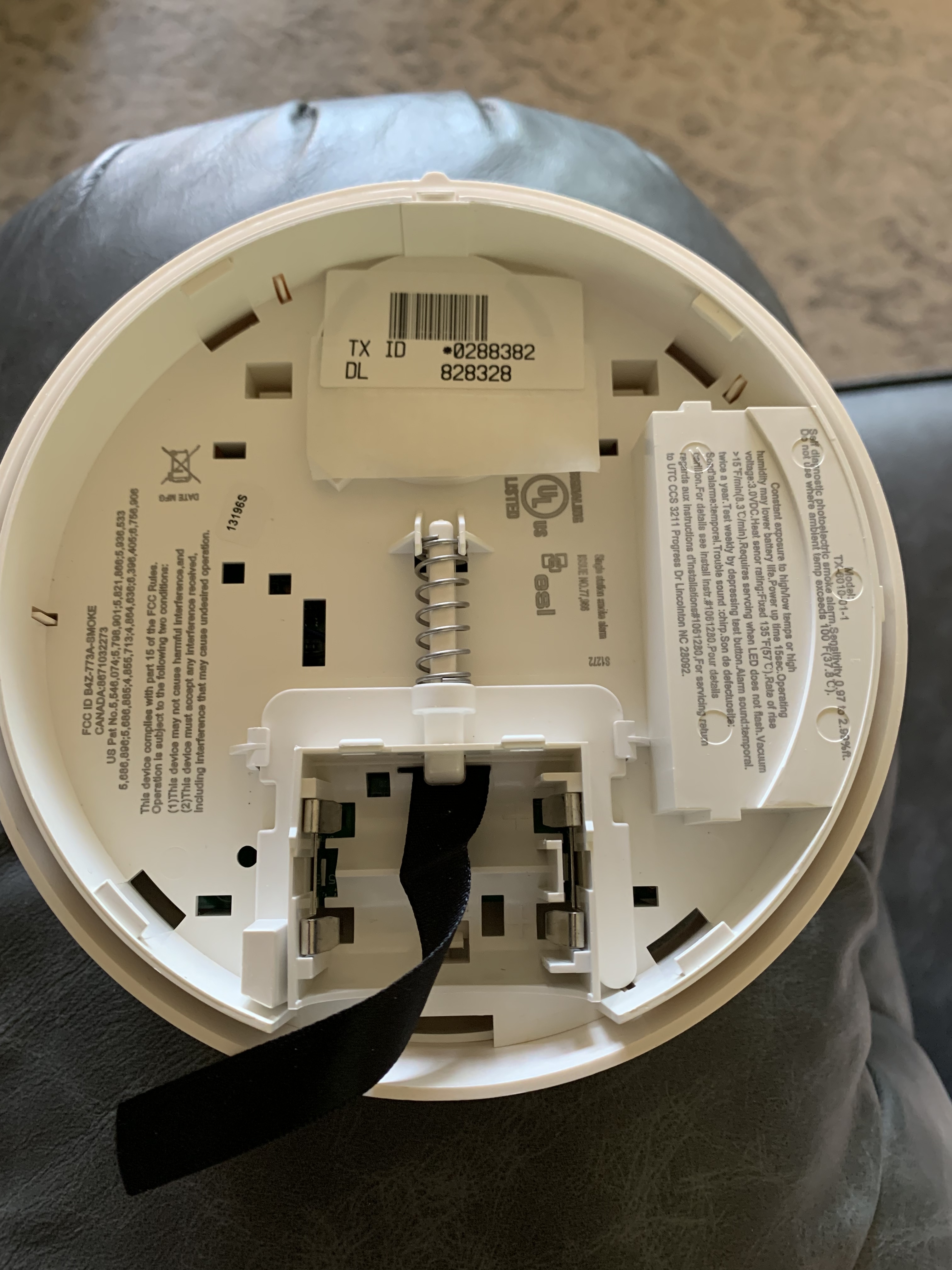

However, if the smoke alarm is powered off, something else is amiss. Can you post a photo of that smoke detector’s DLID/TXID? it is a 6 digit hexidecimal value.
After rebooting I did try disabling the alarm , it disabled then about 10 seconds later it alarms again and so on as many times I try. Also there is no smoke alarm sounding in the house.

Check the replace by date on all of those smoke detectors, it appears that one is likely expired. I believe that date code sticker is showing manufacture in 2013. 10 years is the expiration for those smoke detectors and they will throw malfunctions if you try to use them past the expiration date.
Yes they are all past the expiration date. I’ll change them this weekend.
