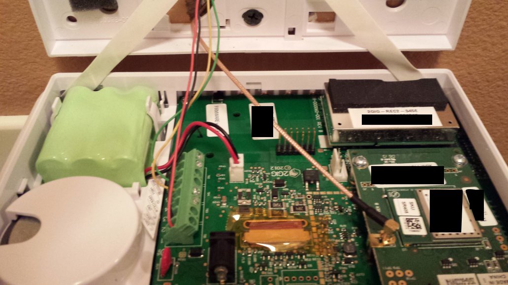

At that time I had some concerns that I may have damaged the battery connector during the process
What caused you to think this? Can you provide a photo of the connector on the panel or a description of any damage?

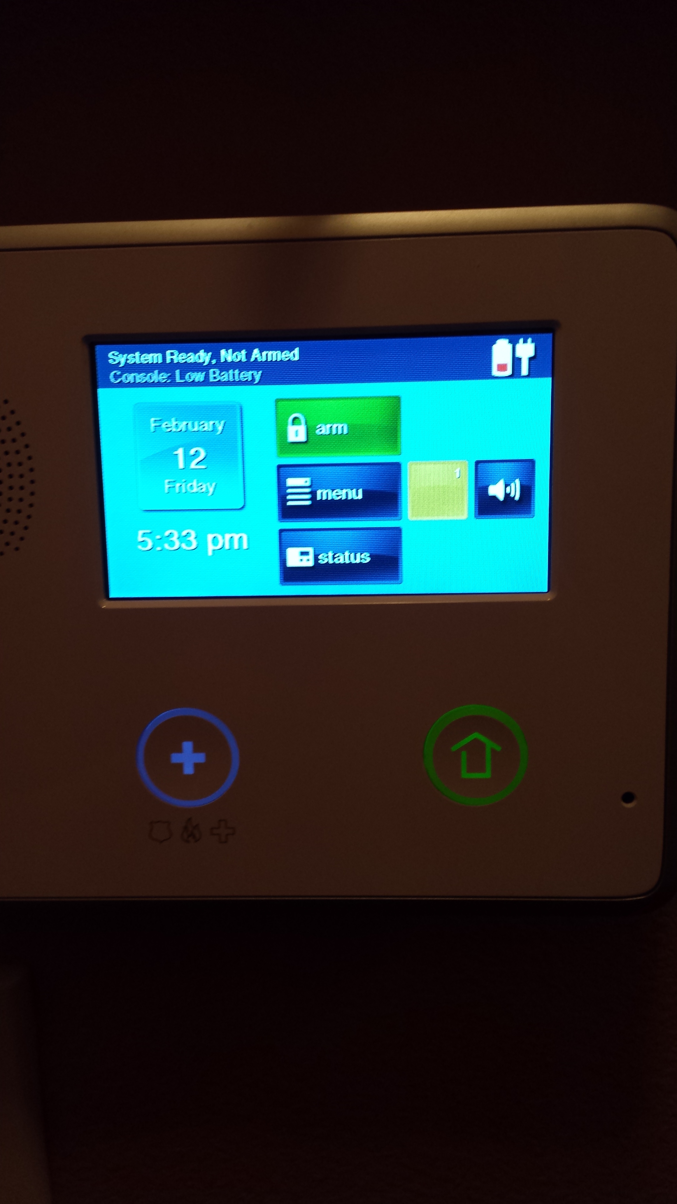

Is the low battery icon on the screen now? The last battery alert I can find in history occurred 1/25/2016 showing the battery ok. No current low battery.
Can you provide a photo of the battery icon now? If your panel screen reports something different than what it sends to ADC then that indicates a different issue. I have actually once before seen a panel show low battery repeatedly on perfectly fine batteries, (the issue was resolved with a reset to defaults, backup-restore)
My concerns were that I had a difficult time removing the battery connector the first time and I didn’t realize that the panel wasn’t designed to start upon plugging the batter in with the AC disconnected. You guys told me that since I wasn’t getting a low batter indicator that everything was probably ok.

The low battery icon is on the panel (along with the alert symbol for an ongoing error). I’ll take a picture and send it once I get home. It re-reports the warning each time the panel is rebooted.

I’m also attaching a couple of shots of my panel and the battery connector.

My guess is you damaged the pin connector, and/or motherboard, and your panel either can’t see that battery or can’t charge the battery. You will most likely need to replace panel in any event.
