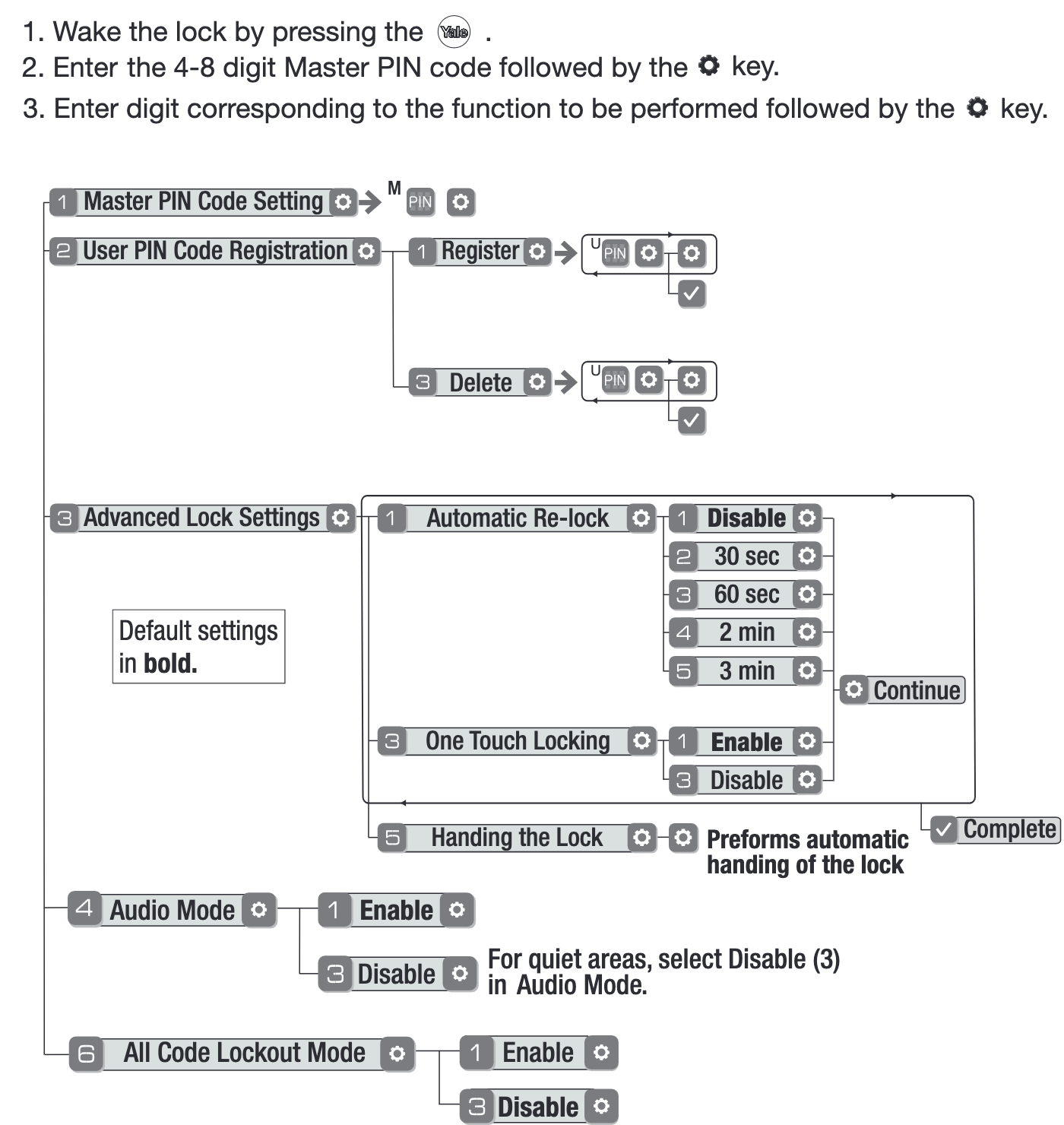

Have a Yale PRO SL (p/n YRD156-ZW2-619). Sometimes I will open the door to exit the house, and before I can close the door the deadbolt has extended on its own and I end up smashing the extended deadbolt into the casing around the door.

Automatic Re locking is not enabled. I also reached out to Yale. All they could offer is that maybe I was accidentally hitting the keypad on the lock and activating the “one touch locking” feature. I don’t think I was doing that either.
