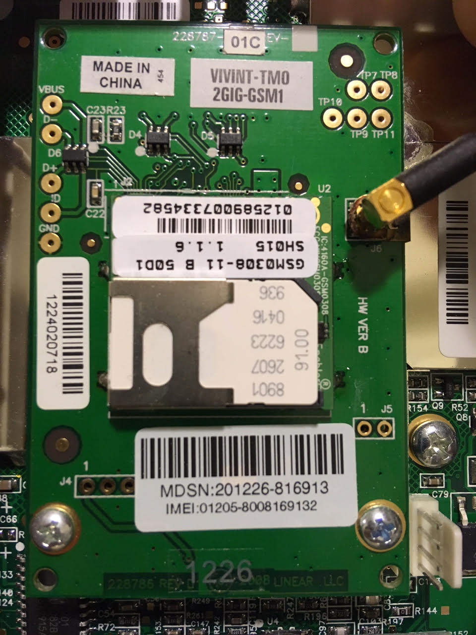

Can you post a photo of the cell module or the model number from the sticker? Or do you know the carrier of your current module?
My contact with the other company is over, so I will be posting a picture of the cell module and modle number from the sticker so I can figure out what module I would need if possible. Thanks
IMEI xxxxx cell module number and what looks like a SN 016960DB
Vivint-TMO 2GIG-GSM1

That would not be a useable module itself, but it confirms it was an old T-mobile 2G. T-mobile is not a current option for 2GIG panels.
