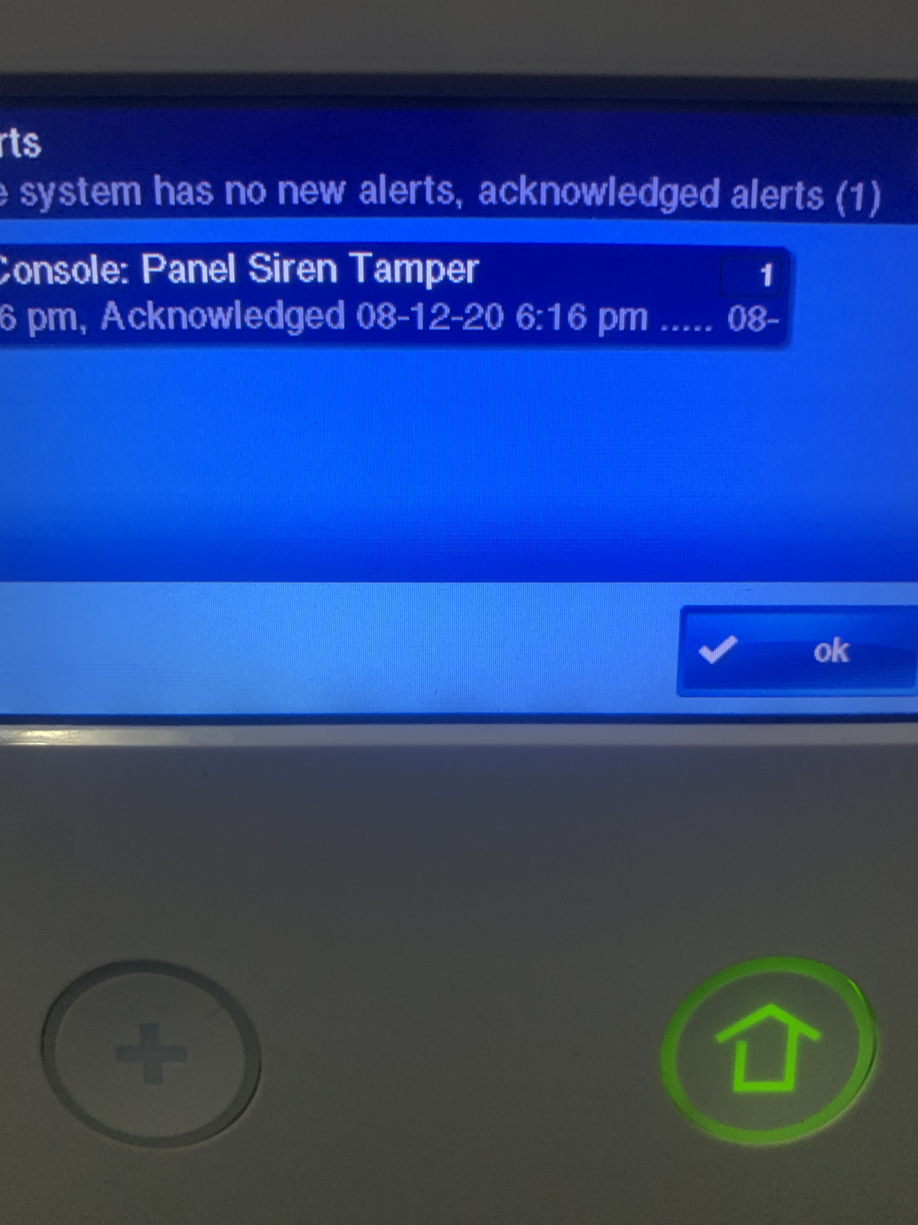

Just got my GC2 4G module installed with Surety, just wondering In the settings how do I resolve this
Hmm, I don’t remember seeing that particular error. However as it is specifically calling out the siren I would physically power down the system by unplugging the transformer from its outlet, then unplug the internal battery. Unplug the siren wires (red and black pair with white connector) and reinsert them firmly in place.
Power up the panel, does this error come back?
As far as having a separate Syrene I do not have it’s only internal Syrene that’s why I feel like it’s in the settings this didn’t come up the last time I was playing with it and I change some of the settings and now it’s coming up
Siren
Did you try the steps I recommended above? The siren connector in the panel may be loose.
I am referencing the internal siren, not an external one.
It was either 86 or 21 now after going through this I have set something else wrong and now it’s saying console phone line failure.
Ok resolved that with number 08 and hopefully last
