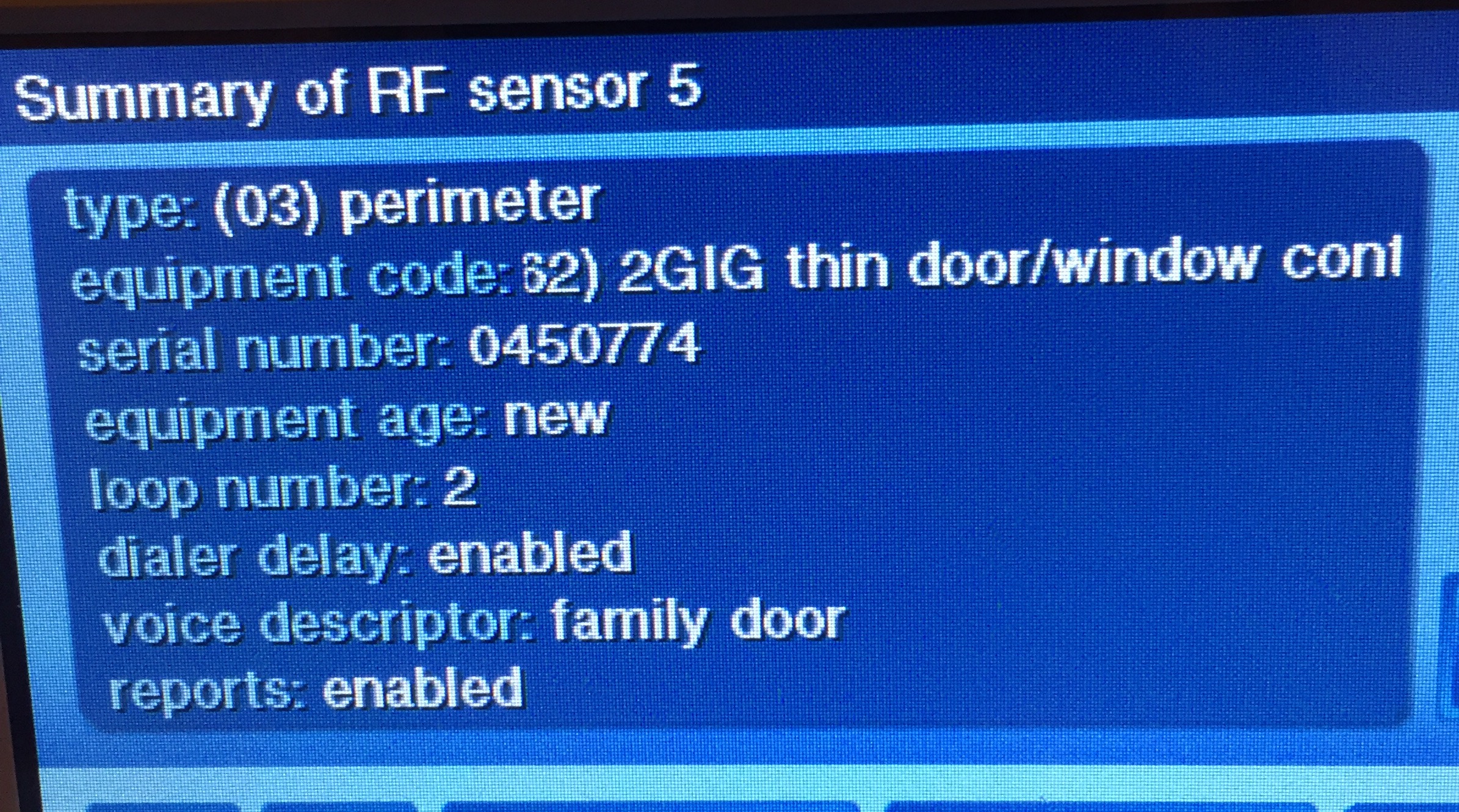

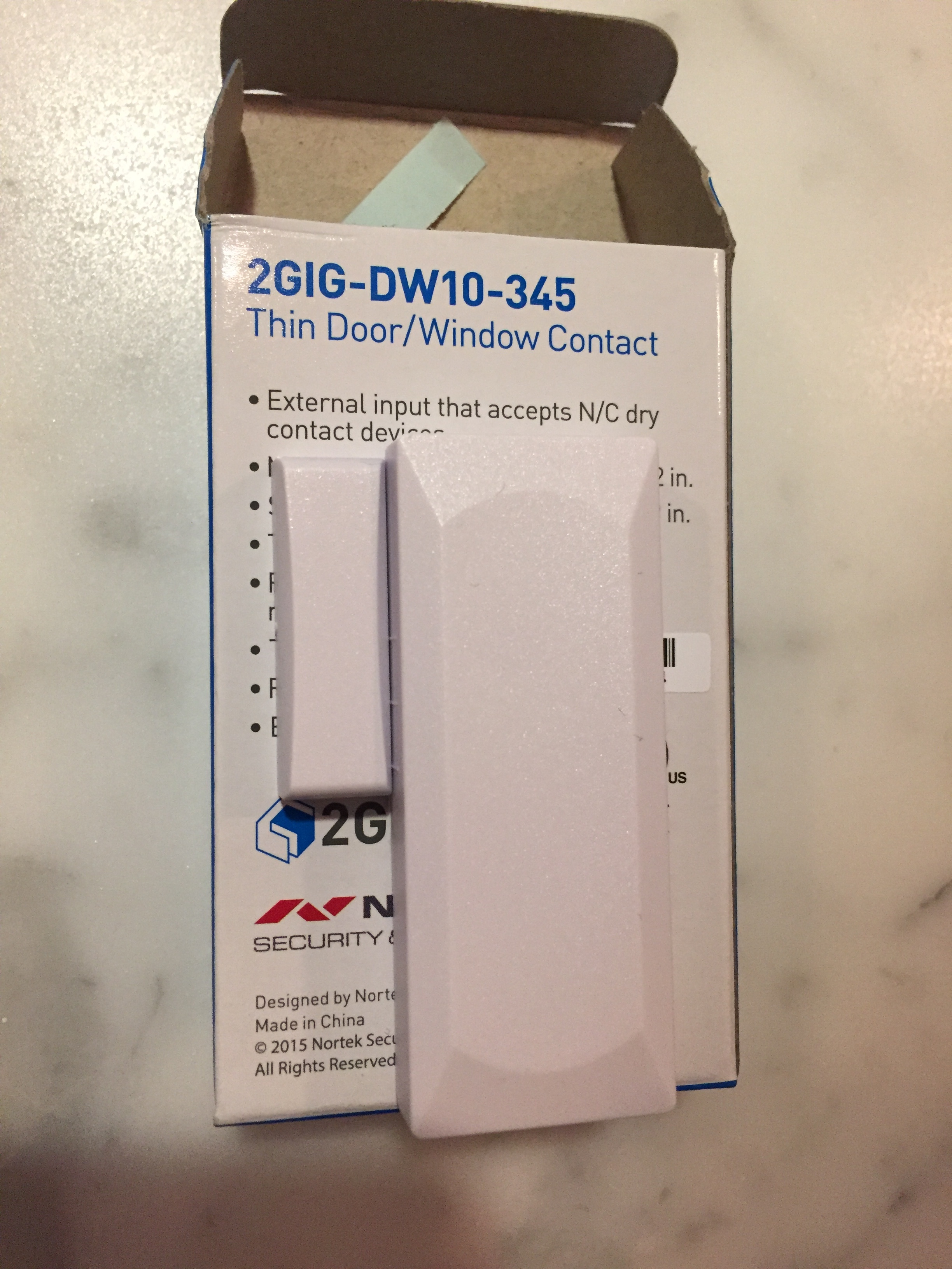

Let me see a pic of sensors and magnet. And screenshot of programming. Sensors may be defective, or improperly programmed.
Since multiple sensors are having the same issue, I suspect programming. Though it is possible they are all defective/damaged. It is possible that they have bad batteries too. I seem to vaguely recall someone else having similar issues and it was the batteries.
Did what you suggested and the DW20R works now. I had it on Loop 2 which I’m guessing was the issue (don’t understand the loops yet).
The DW10s still aren’t working. Is it possible that the batteries would be good enough to handle tamper alerts but not contact alerts? Or are they likely defective?
if you have some other DW10’s, switch out the batteries and see if they work…if they do, replace the batteries (walgreens carries them), if not, then they may be bad.
I had this same problem with one of my sensors. I’m not exactly sure what I did to correct it. I checked programming, removed batteries for a few minutes, lightly banged it on the table a few times, and ran the magnet around it. I got it working, installed it and have not had any problems with it. It always registers with the chime when the door is opened so I assume it is working.
The Fonzie school of electronic repair.
In all seriousness, that sounds like a physical issue if banging it on the table resolved it. Perhaps the reed switch would not separate until that shock?
It was very lightly! I was thinking a switch inside was stuck . It worked a few times out of the box then stopped while I was testing before installing. That’s when Fonzie came out to help.
