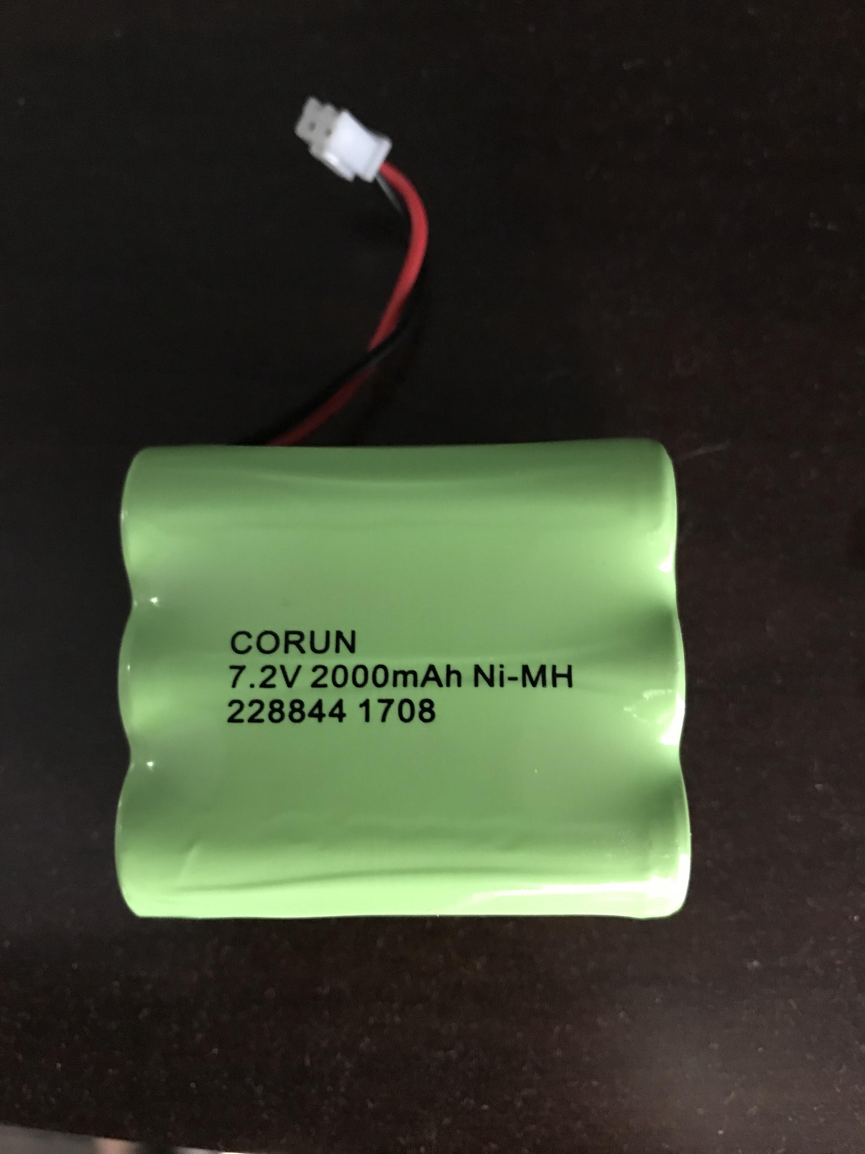

The battery reads “Corun” as the manufacturer. I wonder if this is really the manufacturer for OEM 2 gig for a BATT1?
I knoe the larger battery is made by “Golden Power” for 2 GIG
Interesting. What is the model of battery you purchased?
Could you post a photo of the battery? As far as I know, I believe all are Golden Power. There may have been a recent change but I’d like to make sure.
picture attached. Stuck a volt meter to it and its ready 8.7 volts
Those are the right specs for the basic 2GIG Battery, so there shouldn’t be any issue. To ensure proper reporting, any time you unplug the battery be sure to unplug AC transformer as well, and plug in battery first when powering it up.
