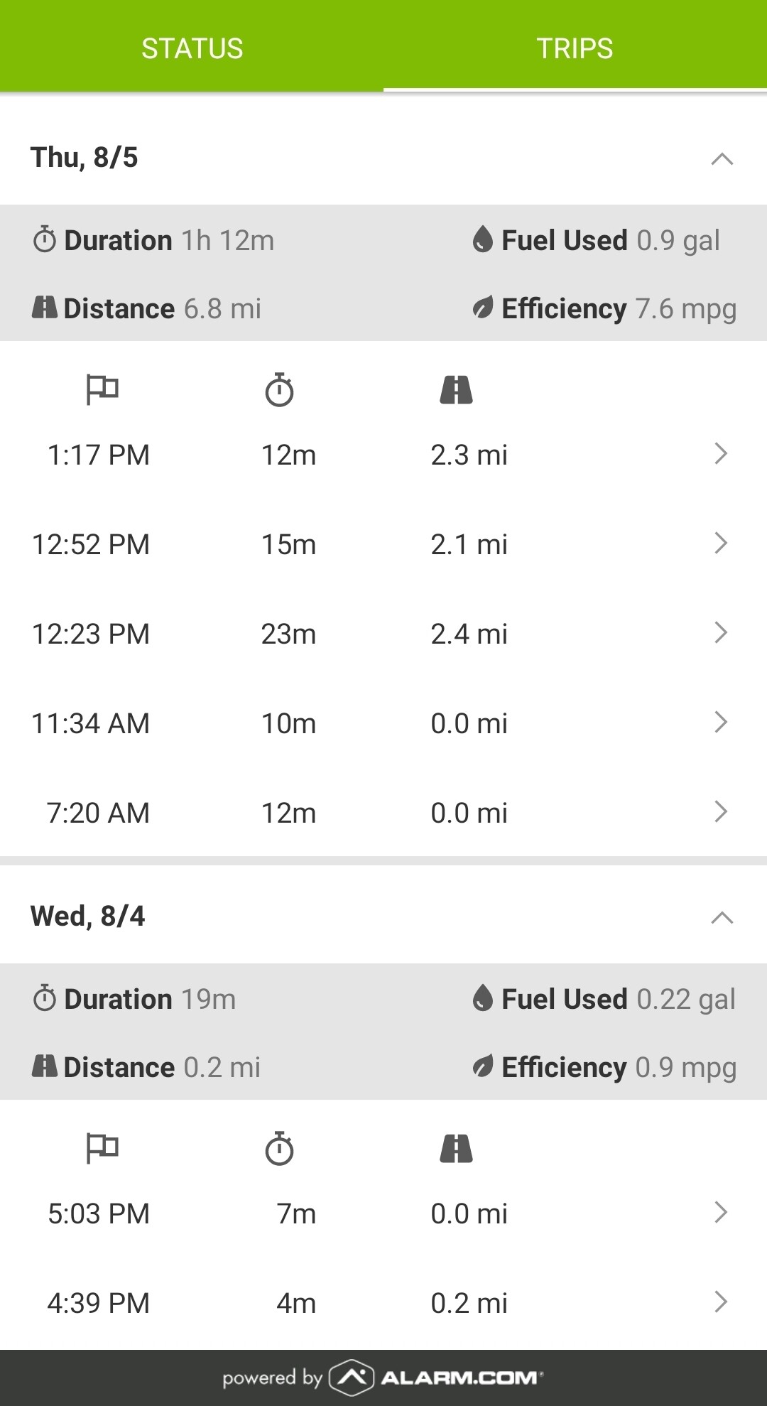

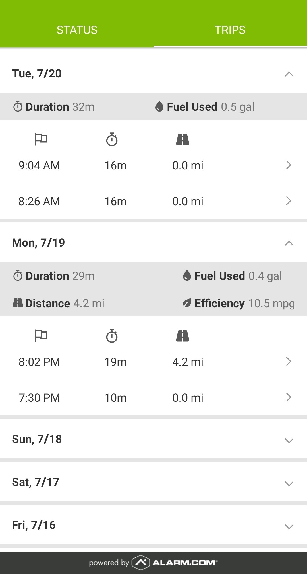

There have been several times where I tried to update the location of my vehicle and it doesn’t update. On top of that I got connected car so I could keep track of my trips and while it always keeps track of how long the car was on, it doesn’t consistently keep track of the distance driven or the path used. Is anyone else experiencing these issues?
The only time I personally have experienced issues where the distance driven does not appear is when the trip is really short (under a mile or so) or when the vehicle isn’t in operation for very long (less then a couple minutes). Usually these are one and the same.

So I just went on a 10 hour road trip with the car this is connect to. Part of the trip it worked but another part it just showed 0 miles. I’ll send you a private message with which one it is. I’m beginning to think that I may just have a defective unit. The other 2 units I have are working just fine.
