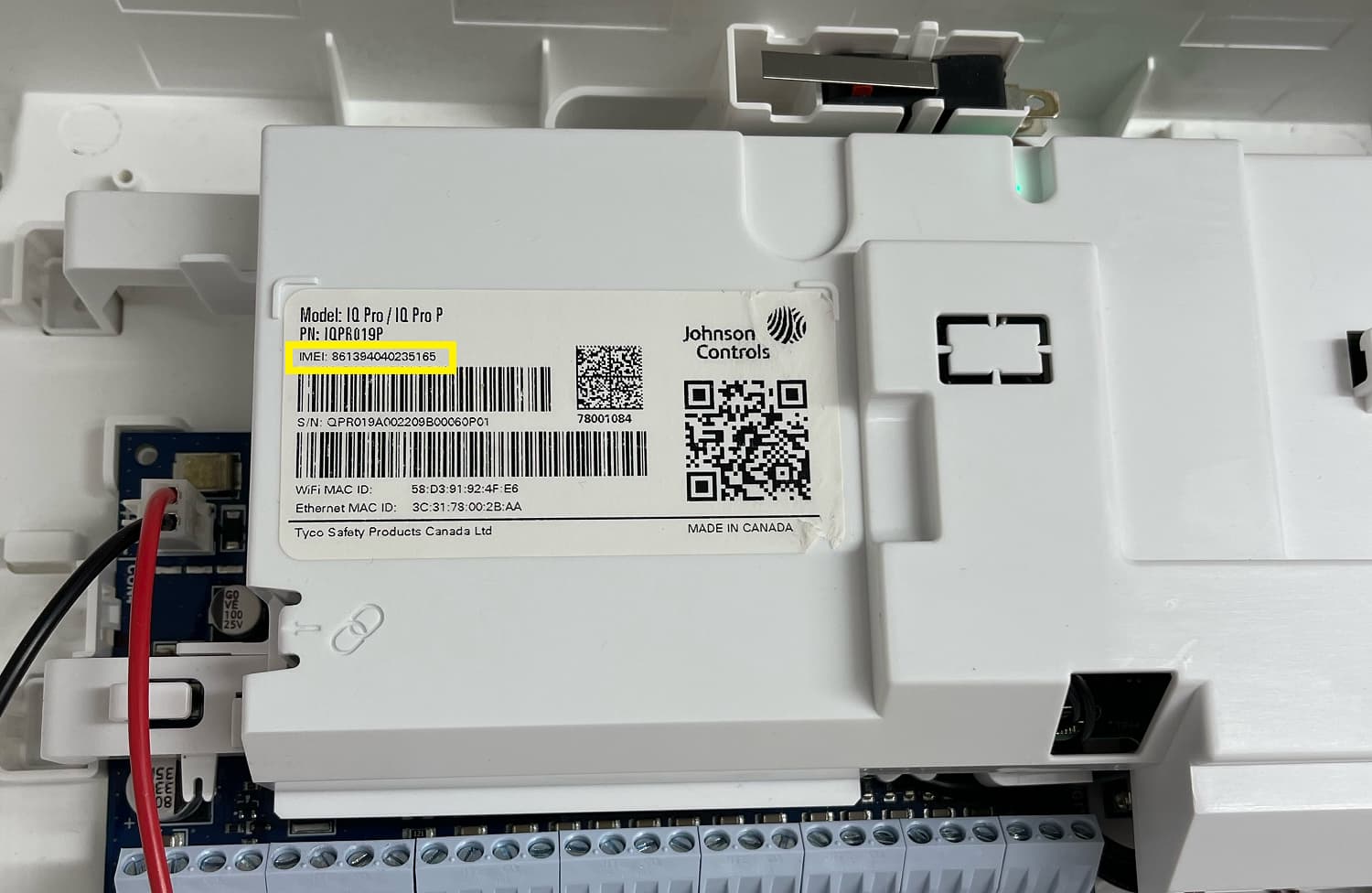

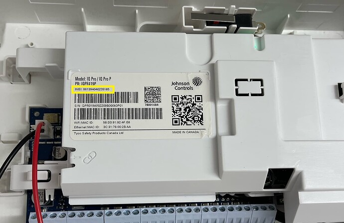

In that case is there a way to add a cell radio to the Pro since the one I have didn’t come with one?
IQ Pro has a built in Dual-Path LTE and WiFi/Ethernet. The IMEI number for the Qolsys IQ Pro is found on the sticker on the panel.
