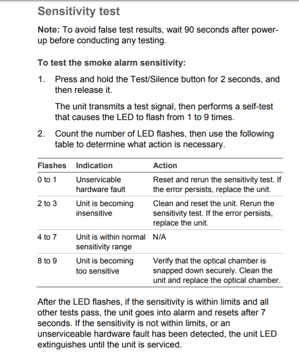

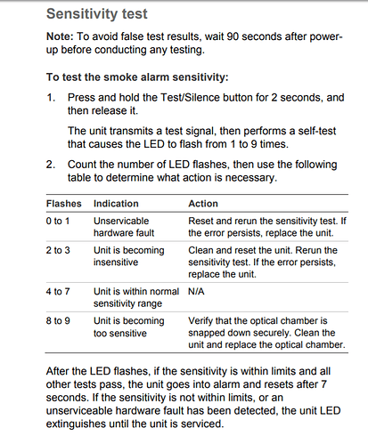

This malfunction may also indicate cleaning is required. Can you try the sensitivity test indicated in the sensor installation manual? See attached.

Performed 3 test on the sensor. Each time it returned 8, indicating it’s too sensitive and may have an issue with the optical chamber (I’m not familiar with what that is). I will look into either cleaning or replacing the optical chamber, if possible.
Cleaning instructions can be found in the installation manual found here.
I cleaned everything I could but did not replace the optical chamber. The sensitivity test now shows 5 and the smoke reset itself since it is within normal range. System status is OK. No smoke trouble showing for now on the keypad. However, the ADC app and web still shows a "Malfunction (Smoke) alert banner. Maybe this will reset after time as well.
