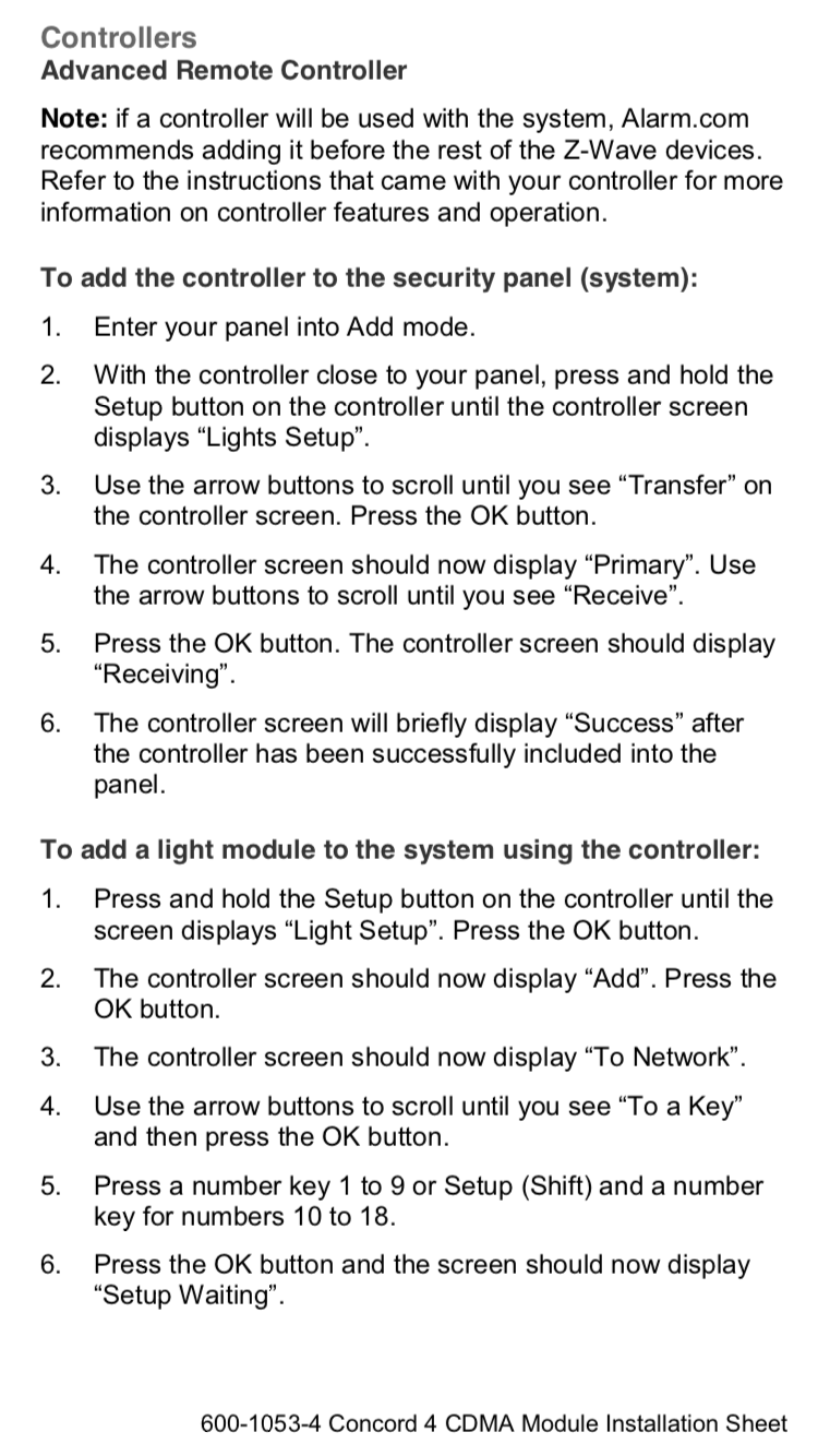

Can you offer a how to on adding the GE 45601 controller into the system so that I am able to use it for adding the rest of my modules? I know that it won’t add my locks or garage door controller but, I used to be able to add new lights and such with the remote. I can’t remember how I originally set that up. But the way I had it set up I was able to add or remove devices with either the remote and/or the concord 4 zwave module. I’ve attached the instructions I used to add the remote into the system currently which doesn’t allow me to do what I’d like.

Thanks. That’s very similar to what I posted and how I added in the remote however, the remote will not add anything to the network like I’m expecting it to and how it worked in the past. The panel confirmed the remote was added and I see it reflected on ADC but I can’t add anything to the network with the remote. Is there a primary/secondary change I need to make or somehow assign the concord module to act as a static controller?

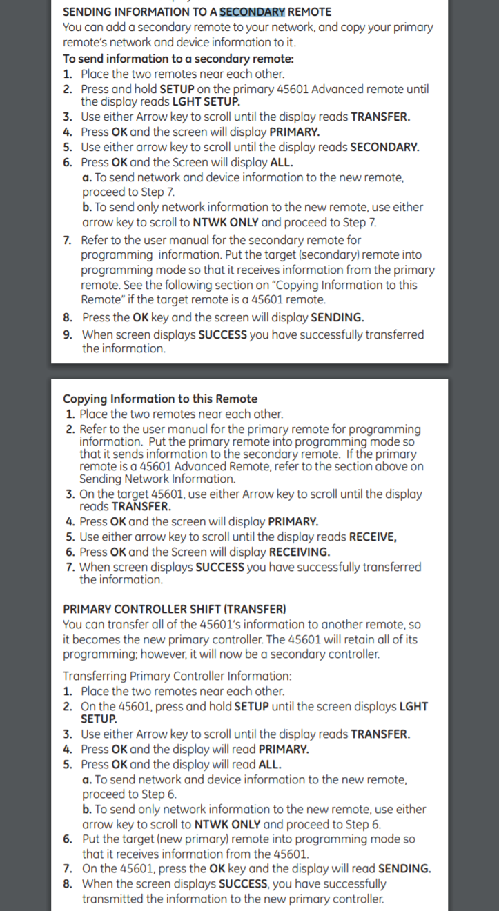

Note that the GE remote is not an officially supported device and dedicated ADC directions would not be available. Unfortunately I do not have a 45601 to test here.
I am attaching instructions from the manual for the GE remote you are using which may be relevant, however. They discuss transferring node data from the remote and passing Primary control to another controller.

It may be that you need to manually transfer the device info via the first part of the instructions in the attachment above. Have you tried that part yet?
I tried that, no luck. I’m wondering if it’s a compatibility issue with the newer firmware maybe? I’ve called Jasco customer support to see if they have any suggestions. I tried to call interlogix support but, they do not support end users.
