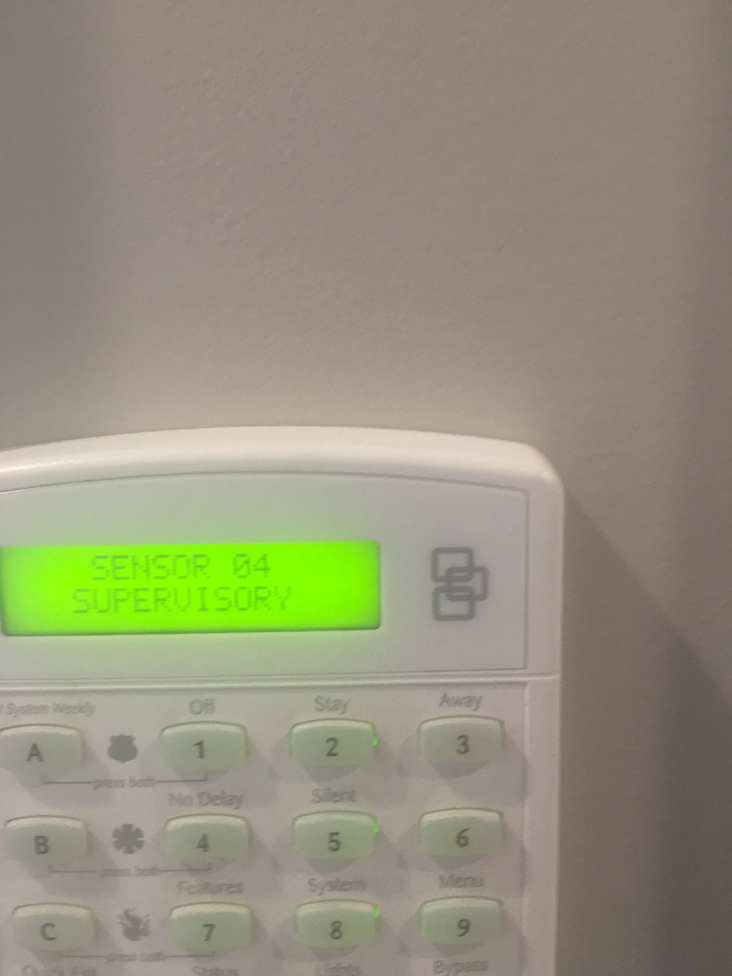

On my account Youngberg House, sensor 4, which is a water/temperature sensor has failed and is giving supervisory errors. Can you please remove it from my system remotely.
Also, in Alarm.com web site and app I have tried to turn off the error beeps in the security section, but that does not seem to work. Am I missing something?

Not sure why you aren’t seeing the problem with sensor 4. The sensor is physically removed, and the keypad is definitely indicating a supervisory error, and generating beeps to indicate an error.
Please advise.

The access code lock has been turned off as instructed.
Please send command to delete sensor 4, or see if you can resolve supervisory error in sensor 4 in a different way.
Phil
Looking at the account it appears the sensor in question was already removed. It is no longer showing in your device list. Any error related to that sensor should be gone on the panel.
We can also confirm that Access Code Lock no longer reports as on.
