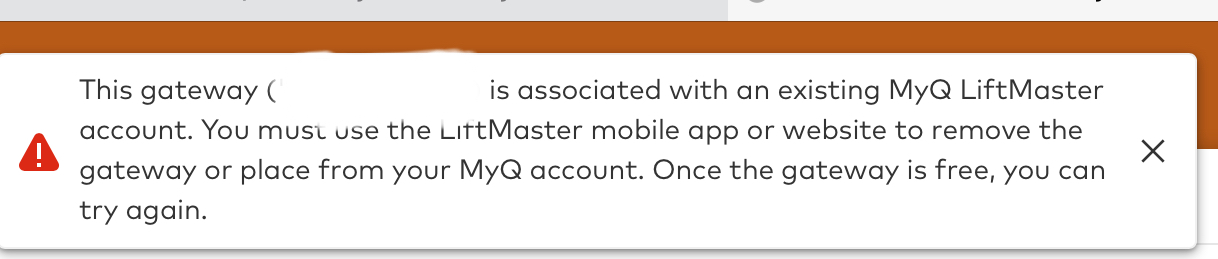

No, the account is not active and has not been for over 2 years.
Yes, I have tried adding the gateway 5 times and received the standard ‘already active’ message. Please see attached.
Go ahead and submit the serial via our secure message tool and reference this thread. We’ll take a look and see if there is still an instance of this in ADC. I would presume that Liftmaster would need to delete it. ADC would not be able to if it is no longer attached to any account.
