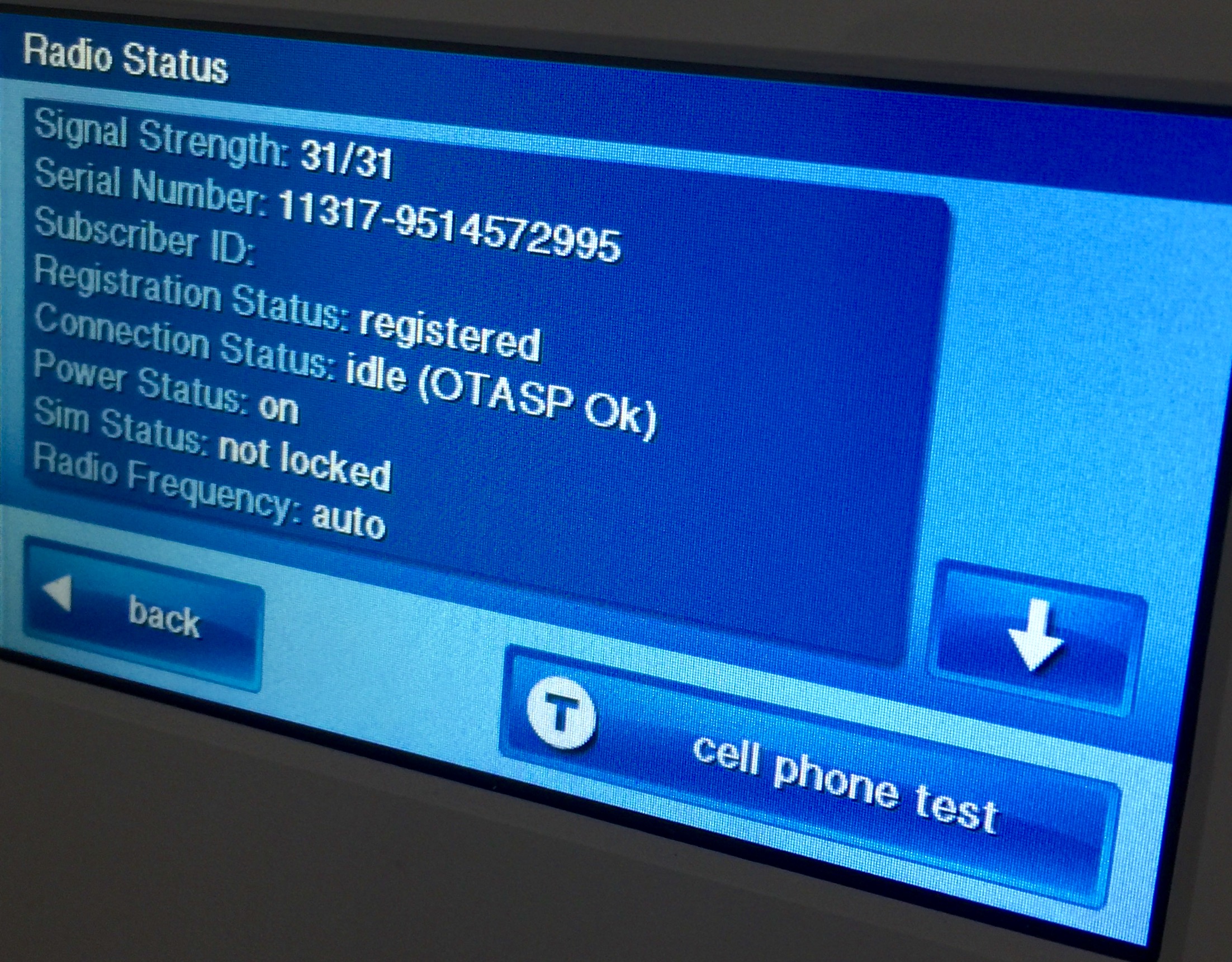

What is your current signal strength on your panel? You can check this by viewing Radio Status in the Installer Toolbox.

After power cycling and reseating the antennae, the panel now has Jan 1 date. I am not finding the radio status button in the toolbox, just the cell phone test.

Radio Status is bottom left button when first entering installer toolbox (logo in bottom right of home screen, installer code)

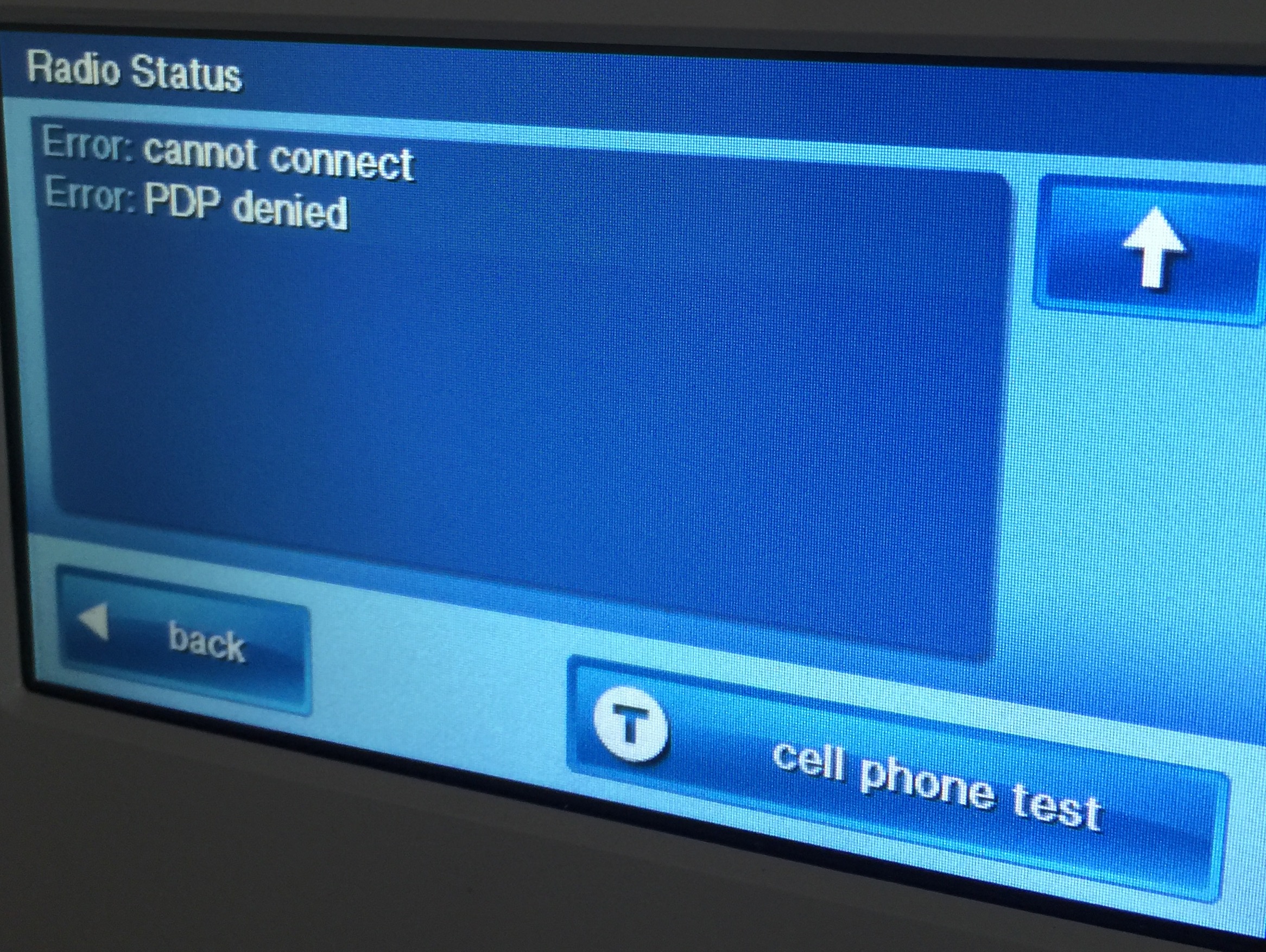

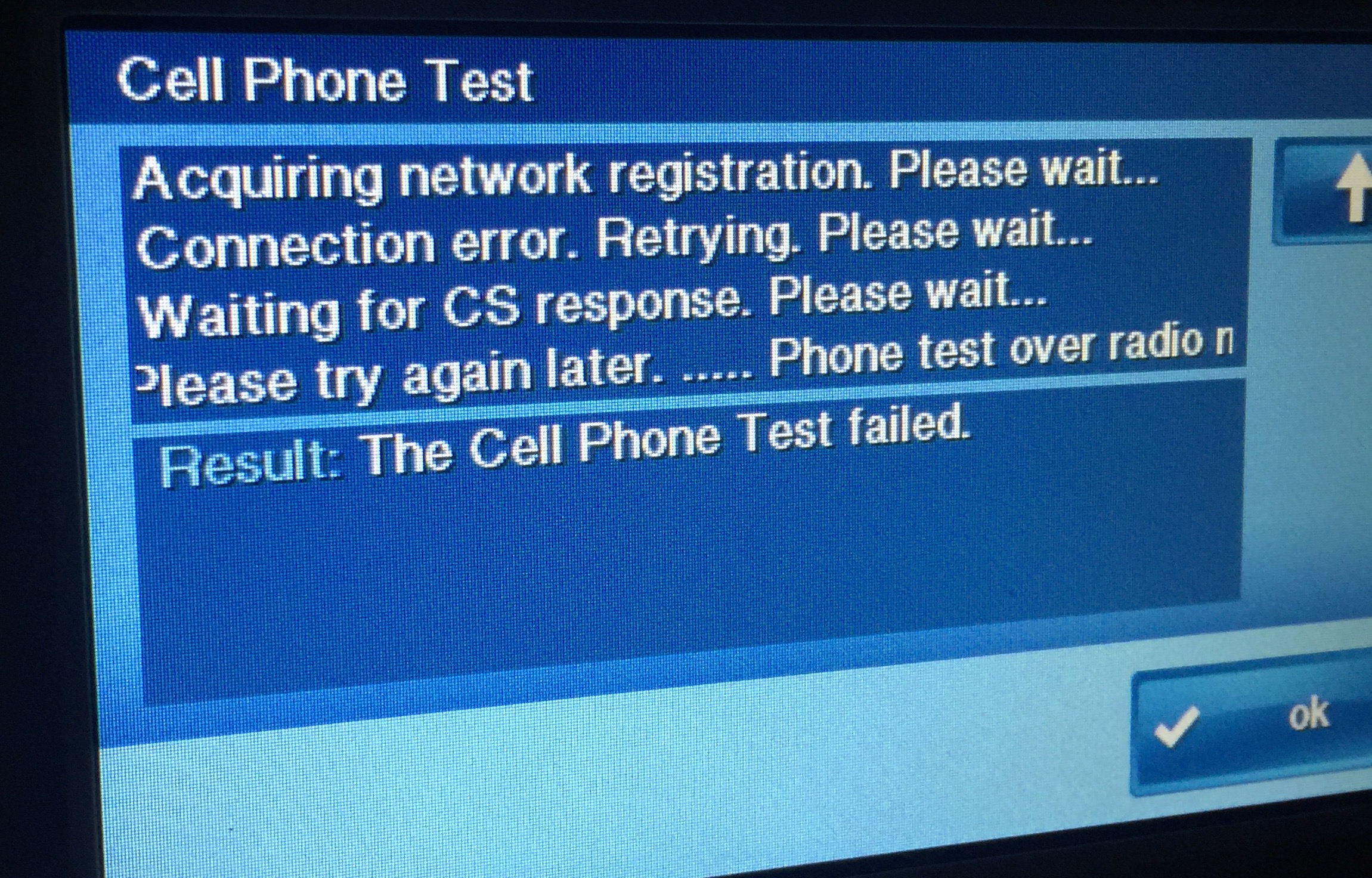

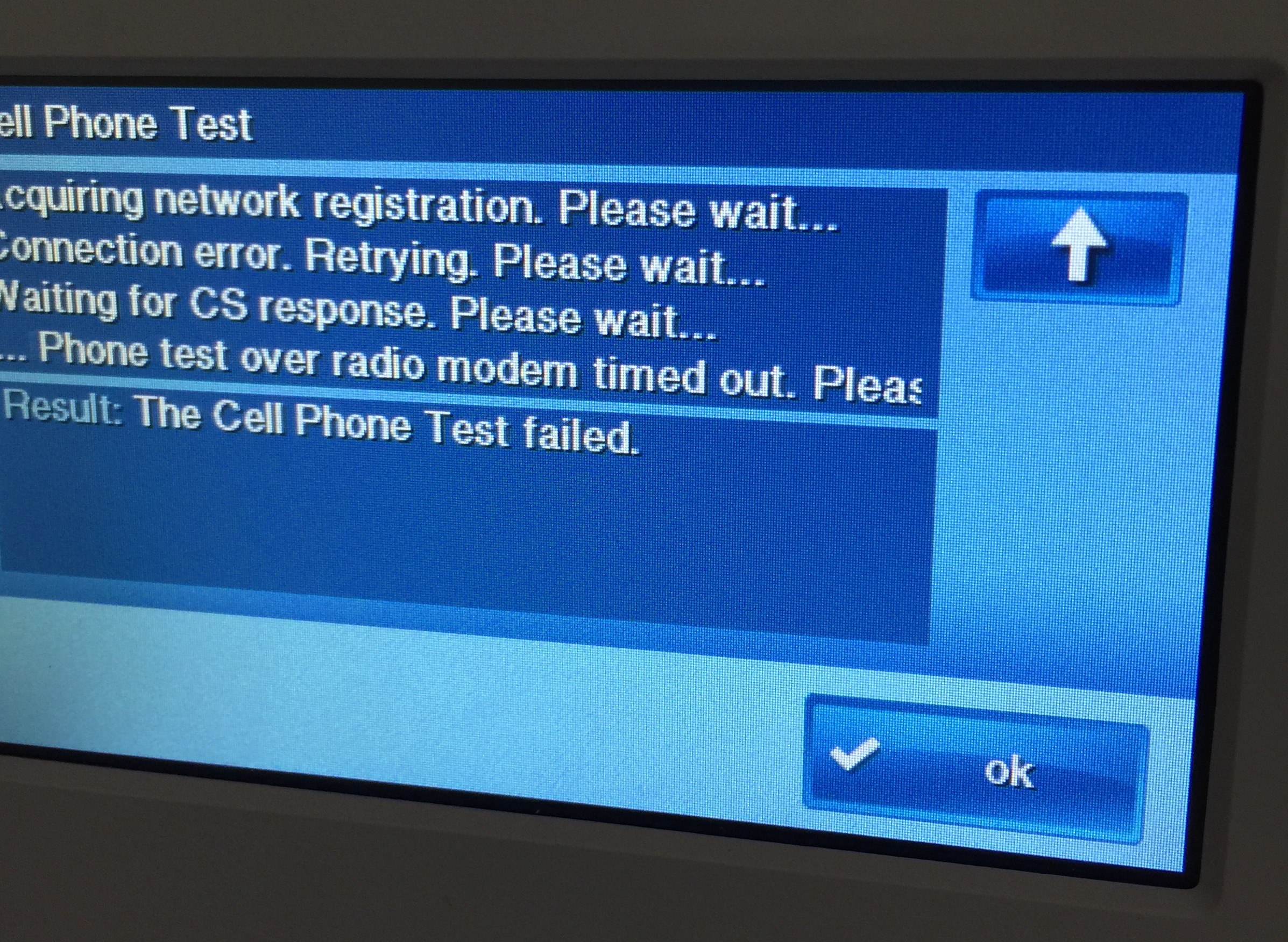

See attached images.

Well, we can try to re-initialize the connection with the tower. a PDP error is typically more common when first setting up, so it is a little strange.

Followed your instructions. However, cell phone test failed.

Powered down, and back up. Ran tests, and failed each time. Tried the three step again you suggested earlier today. Still failed.
