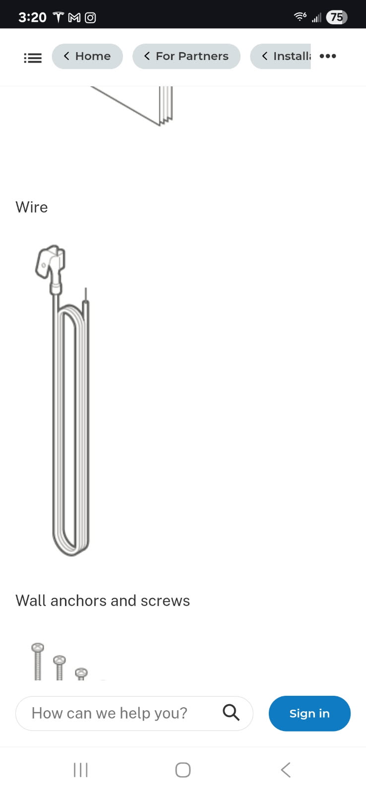

Hi Jason. I rcvd the SEM. Looking at the Installation Guide, it shows what is suppose to be in the box with the SEM. The wire (looks at though it is a cellular antenna) is not in the box. The box I rcvd was not sealed. Should I return this SEM to get another SEM that has the antenna?
Nvmd… Looking at the installation guide you provided, it states:
The following items will be needed for installation (not included with SEM):
Four-conductor, 22 AWG or larger stranded wire <<< is this the wire that is listed in the other IG (pictured below)
The wire in the image here is the battery connector.
Typically the cell antenna are connected to the board and inside the SEM. Can you open the SEM and provide a photo of what you see? I can help identify parts.
