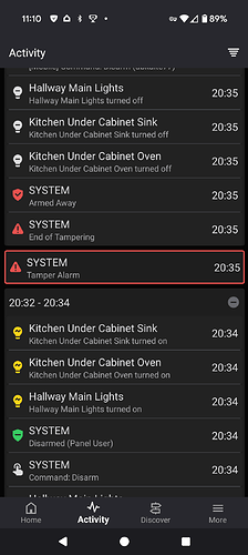

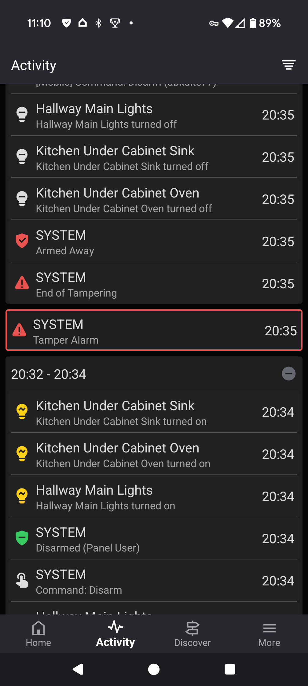

It looks like your panel last reported a power loss and is no longer responding. Did you unplug the panel power intentionally?
The system shows as being disarmed at the time it lost connection, as of the last reports. It looks like it was disarmed as part of a scene.

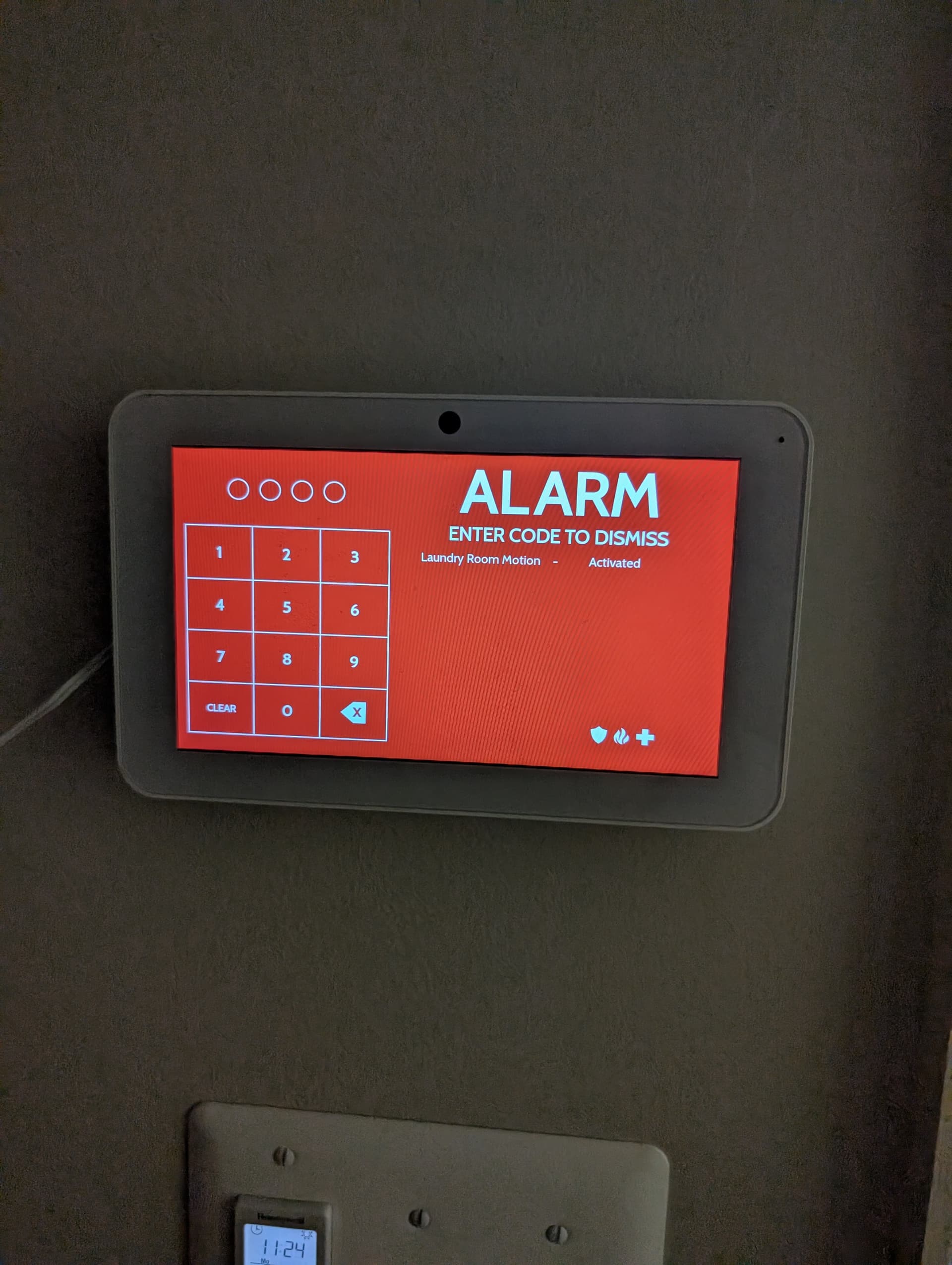

I turned my panel on and the secondary panel had an alarm on it that would not clear with the password. I entered it and it would just sit there. The main panel still looks like the picture I have included.

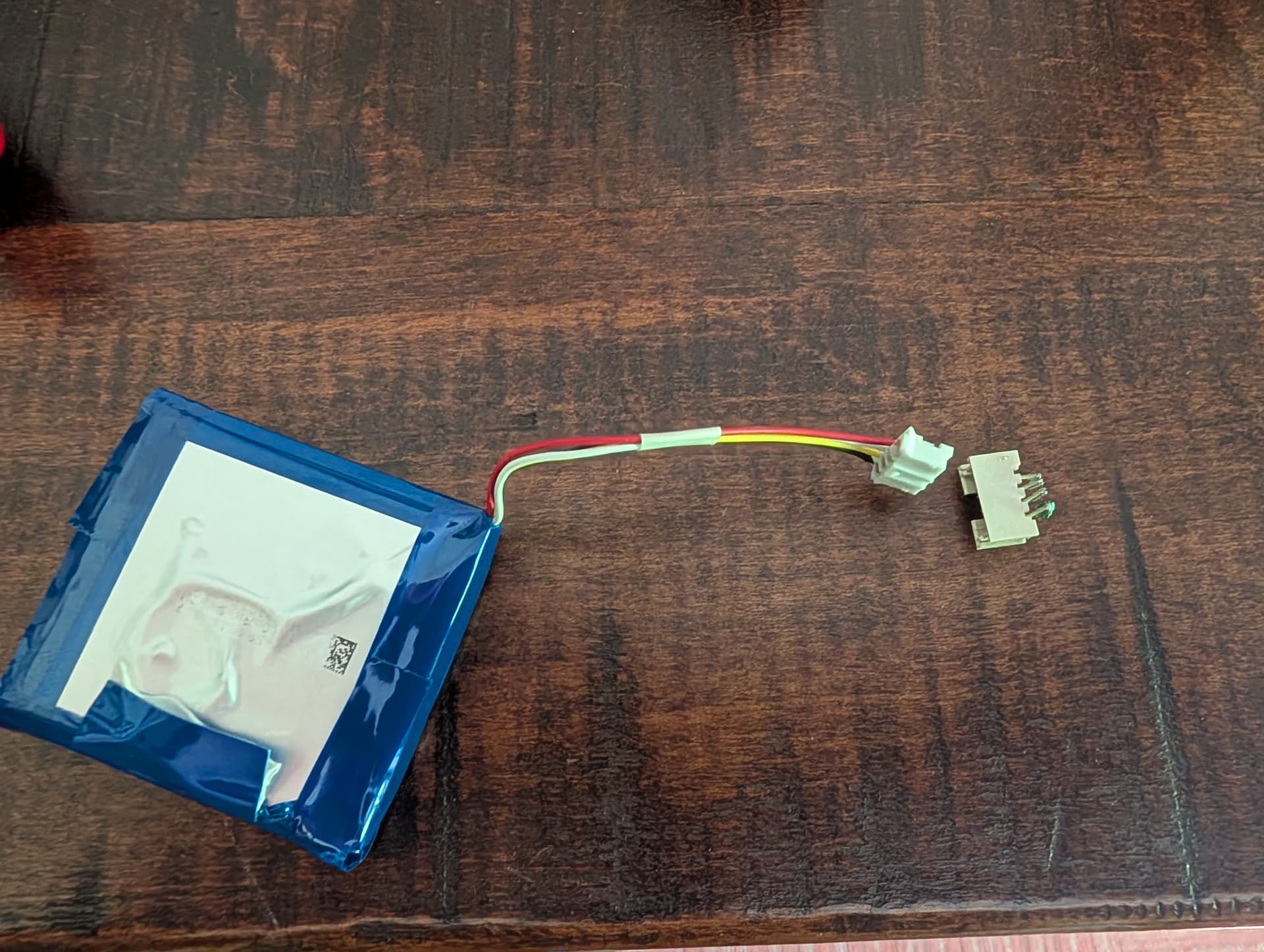

And, when I disconnected the battery from the main panel last night it apparently pulled the connetor along with it.

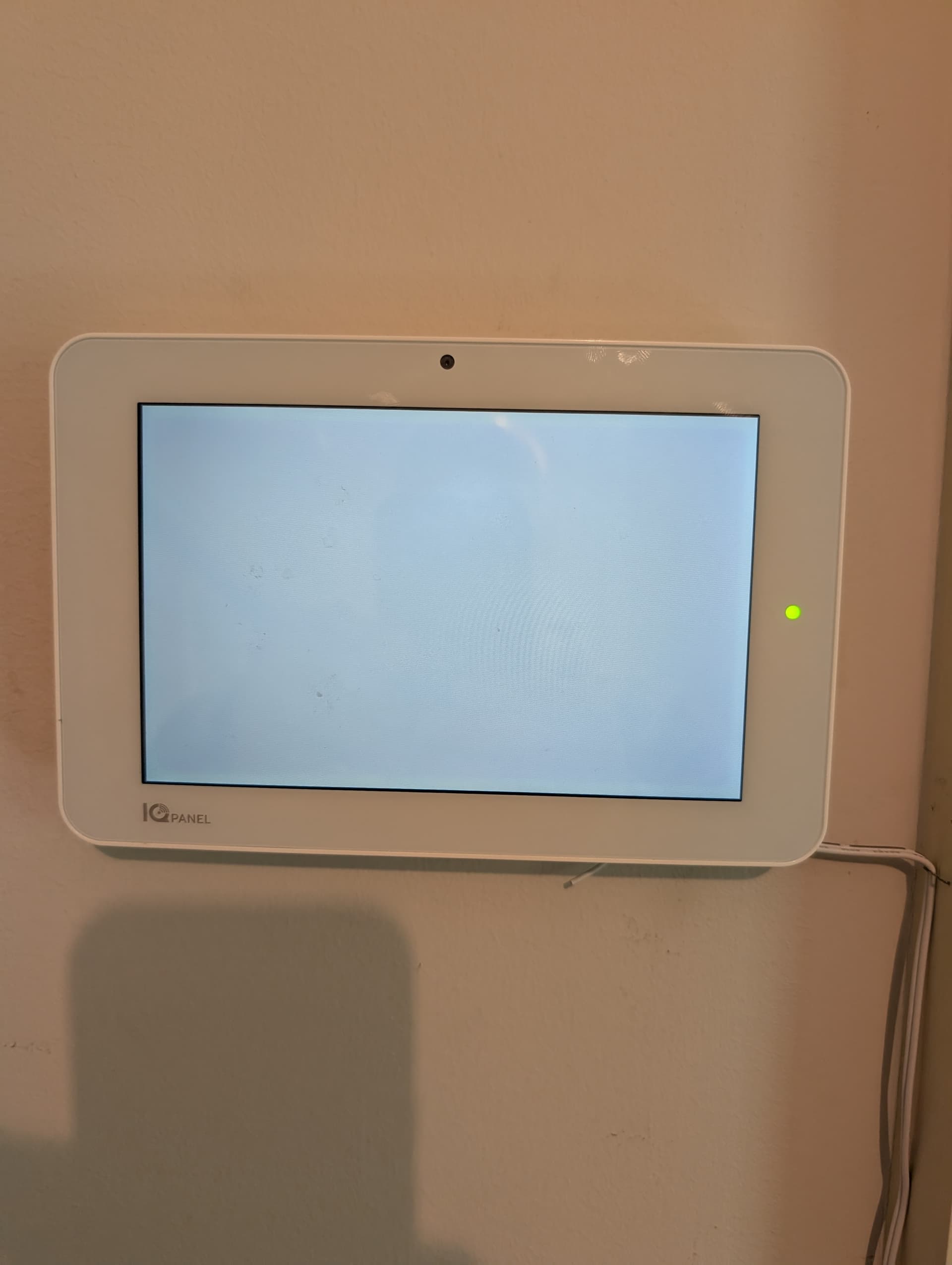

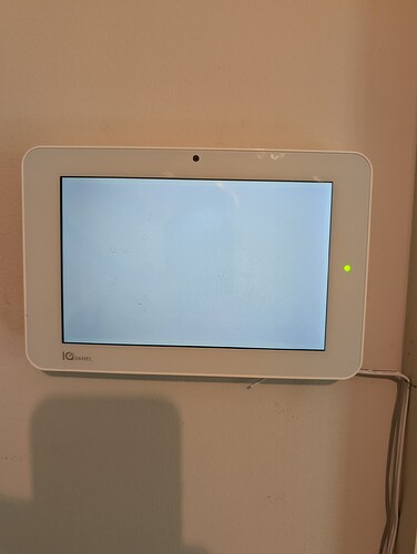

the panel finally appeared to be working and I’ve checked it again and the screen is black and won’t respond to any sort of touch.
I’m not sure what to do, especially with the battery connector detaching from the board. The Panel been back and forth between usable and unusable all day.

Are you able to interact with the IQ Panel 2, or is the screen still white and unresponsive?
If you can interact with it, power it down by navigating to settings > Advanced Settings > Power Down.
Once off, unplug the power supply from the wall outlet. Wait 10 minutes, then re-apply power. does the panel reboot?
Unfortunately, if the battery connector was damaged, the panel may need to be replaced. Are you able to submit a photo of this?
the Main panel was the one that was white, unresponsive, responsive and then black screen not responsive. I’ve unplugged it twice and it seems to be working now.

I’ve included a picture of the battery
The only way to fix the panel would be to solder the battery connector back on to the board but if the panel is giving you other issues, then the best option would be to replace the panel with a new one. The IQ Panel 2 has been discontinued and the panel that replaces it would be the IQ Panel 4 433 Mhz Radio
