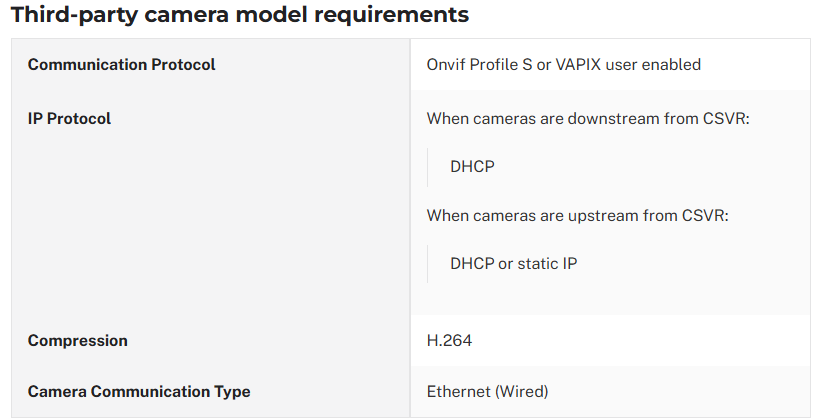

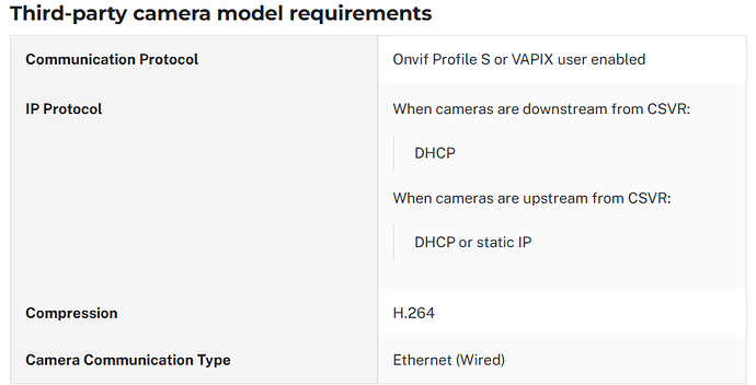

Below is the requirements for 3rd party cameras to work with a CSVR

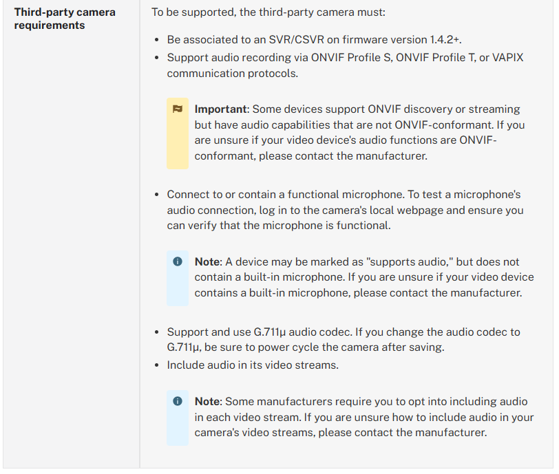

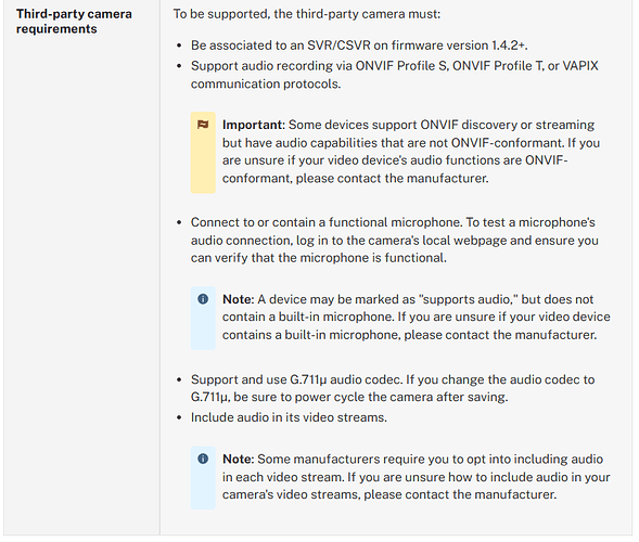

Below is the requirements for the microphone on third party cameras
Currently, only Hanwha and Axis cameras are compatible with video analytics on a CSVR. Other IP Cameras will only be able to record video and audio but you will not be able to create any video analytic rules
