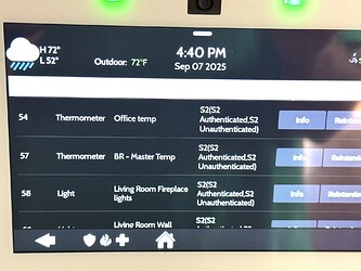

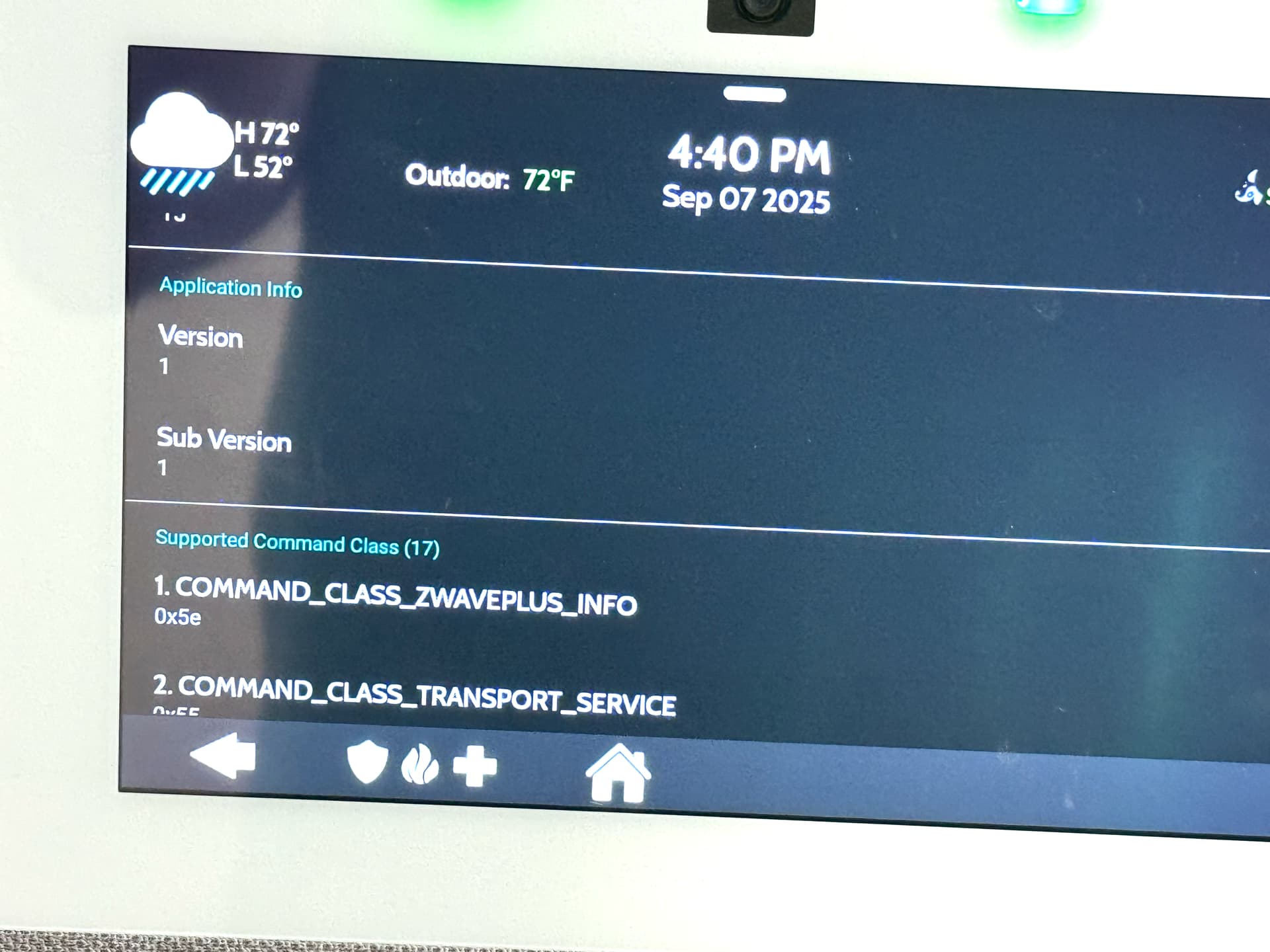

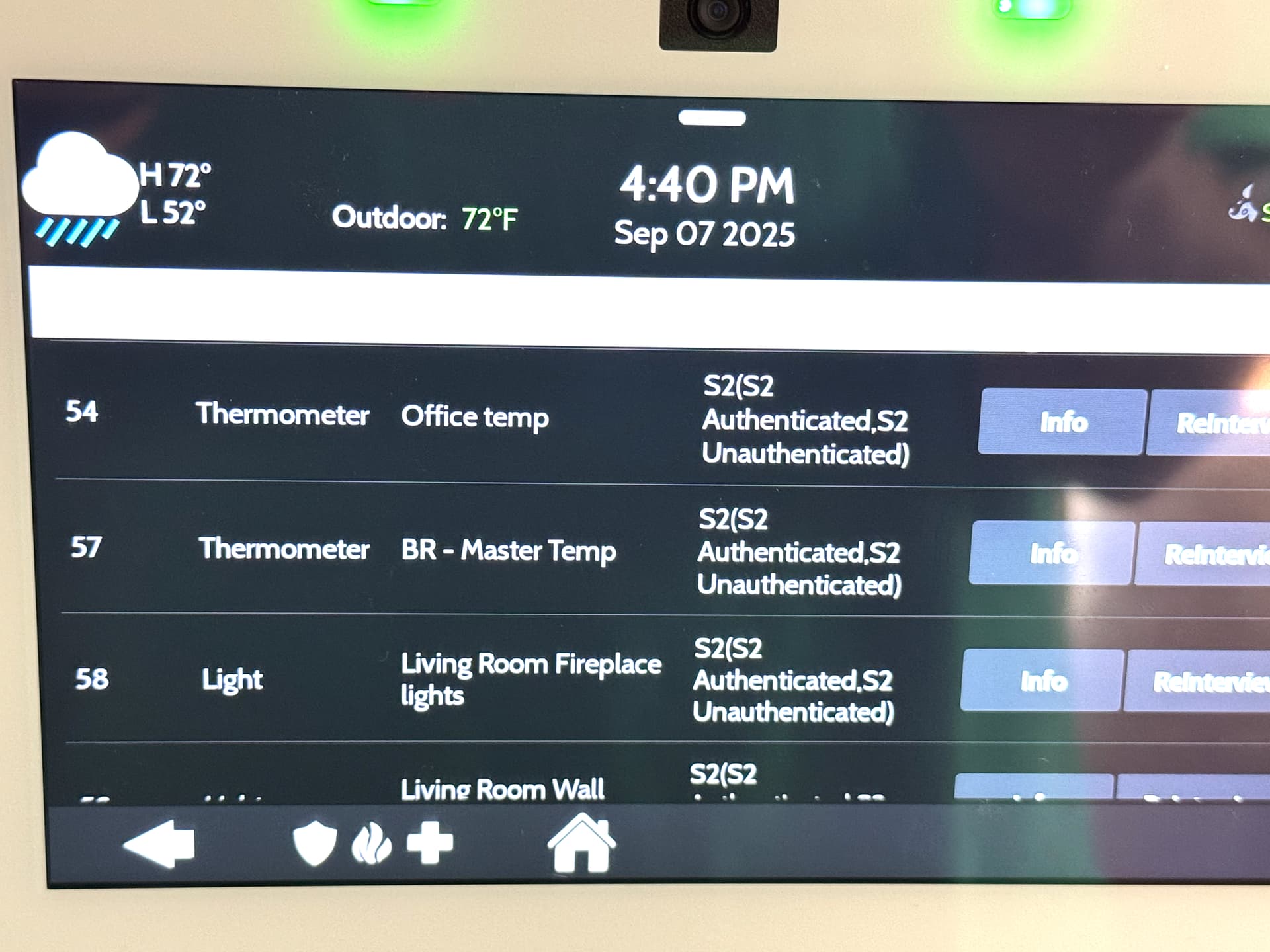

I found it here:
Settings, Advanced Settings, Dealer Code, ZWave Device List, Find the Temp Sensor, Then click INFO
Scroll down to “Application Info”
The Version and Sub-Version should be the firmware of the device.
Mind you I could be wrong - but cross checking this against other zwave devices where I know their firmware versions, these numbers seem to correlate.
