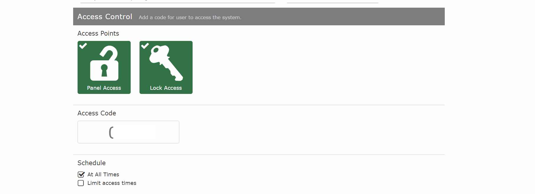

This is what I see, there is a access code, but that’s for the panel to disarm…
I meant to try giving a user just lock access, no panel access. I wonder if Alarm.com still shows the user code field for that lock as it does all others.
