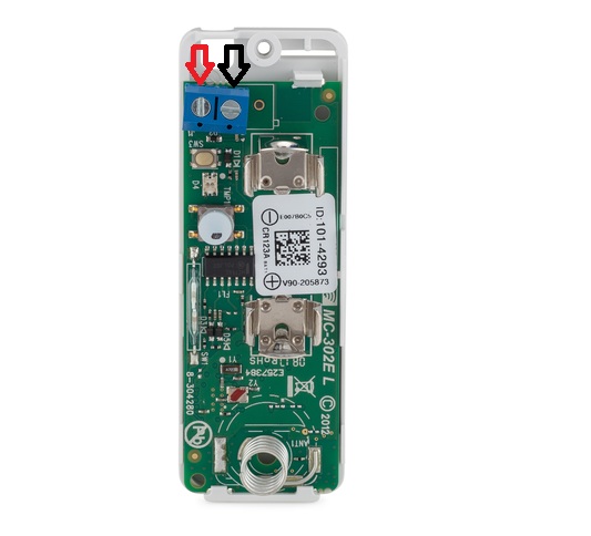

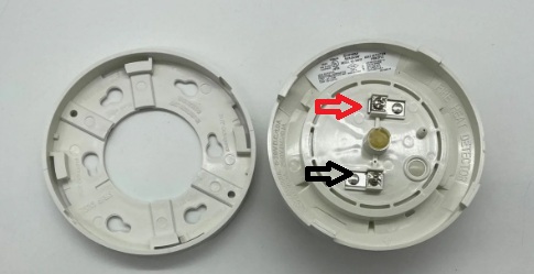

You could use a PG9945 sensor and use the terminals to hardwire a System Sensor Heat Detector 196 degree which is more than the 135 degree that is with the PG9936
You will need a short piece of wire to connect between the heat detector and the PG9945 sensor. The sensor will need to be learned in as normally open and as a fire zone.

There aren’t any instructions yet but it’s not that difficult. The pictures below show the terminals on both the PG9945 and the System Sensor Heat. You’ll just need a short piece of wire 18/2 wire recommended but you could use 22/2 wire.

Is it correct to assume that this is low voltage so red and black don’t matter? In other words if I used the red terminal in the picture and out the wire in the black terminal in the transmitter , it wouldn’t matter?
That is correct. As long as it is able to see the resistor at the end of line, the color’s don’t matter in this case.
