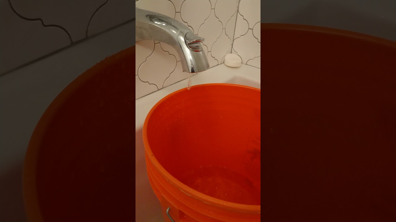

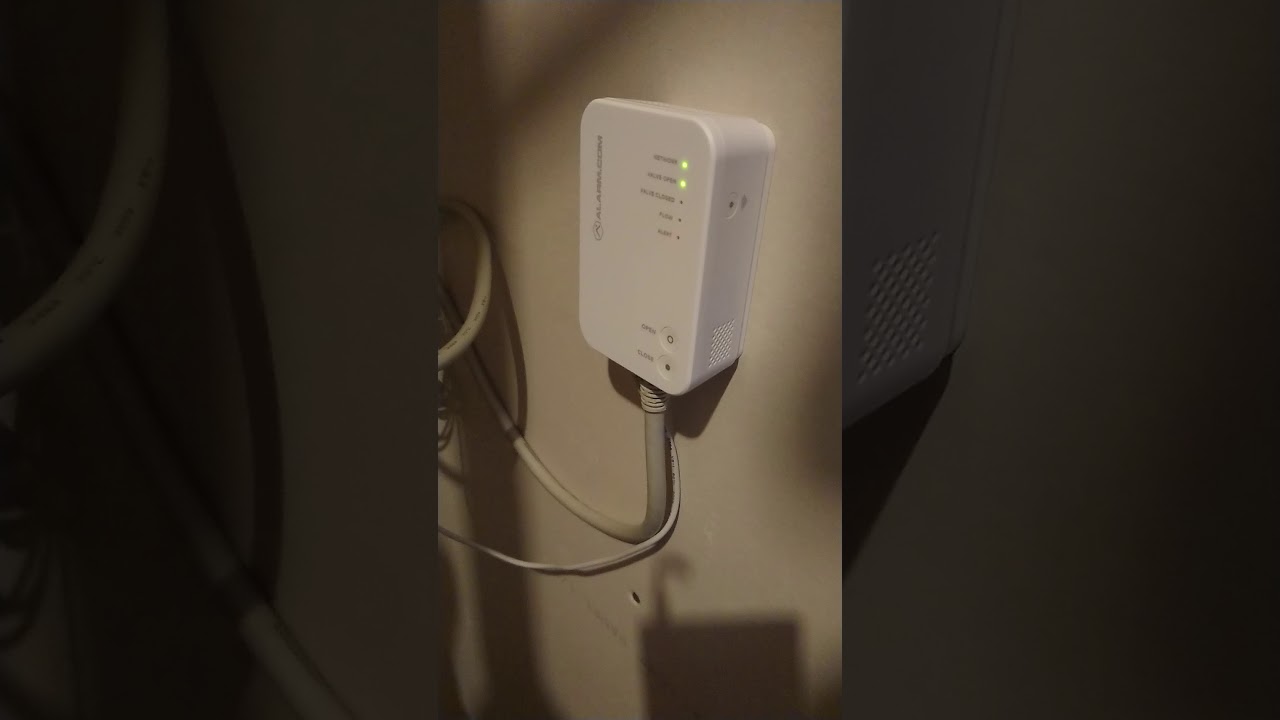

If you are curious, I was doing some testing with the Smart Meter + Valve. It has 3 conditions that it reports to you; high, medium and low flow conditions. There are thresholds for each (time, amount etc.), for which you can let it shut the main house valve and/or give you a warning. Testing the high flow, was easy, just open a few showers flush toilets, no problem it works, get the messages. It was the low flow I was skeptical about, supposedly, it can detect down to 0.1 L/h! So I tried to simulate this condition by opening a faucet, ever- so-slightly, and see what happens (the criteria for a low is 2 hr of constant water flow down to 0.1 L/h…which I think can be adjusted on the dealer to suit your needs).
Here’s the actual experiment:

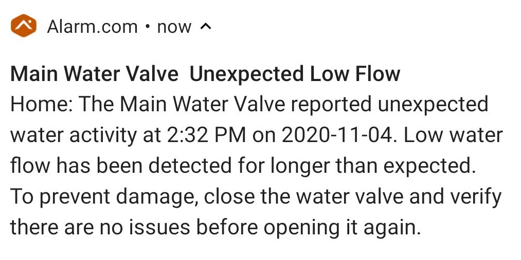

After exactly 2 hrs (and about 19 L of water) this happens:
After I turned off the running faucet, within 10 seconds, the audible alarm stopped and all operations went to normal. Then, after 5 minutes, I get another confirmation via the same notifications, that the issue has been resolved.
