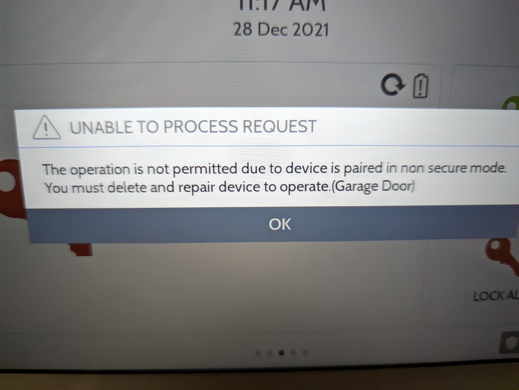

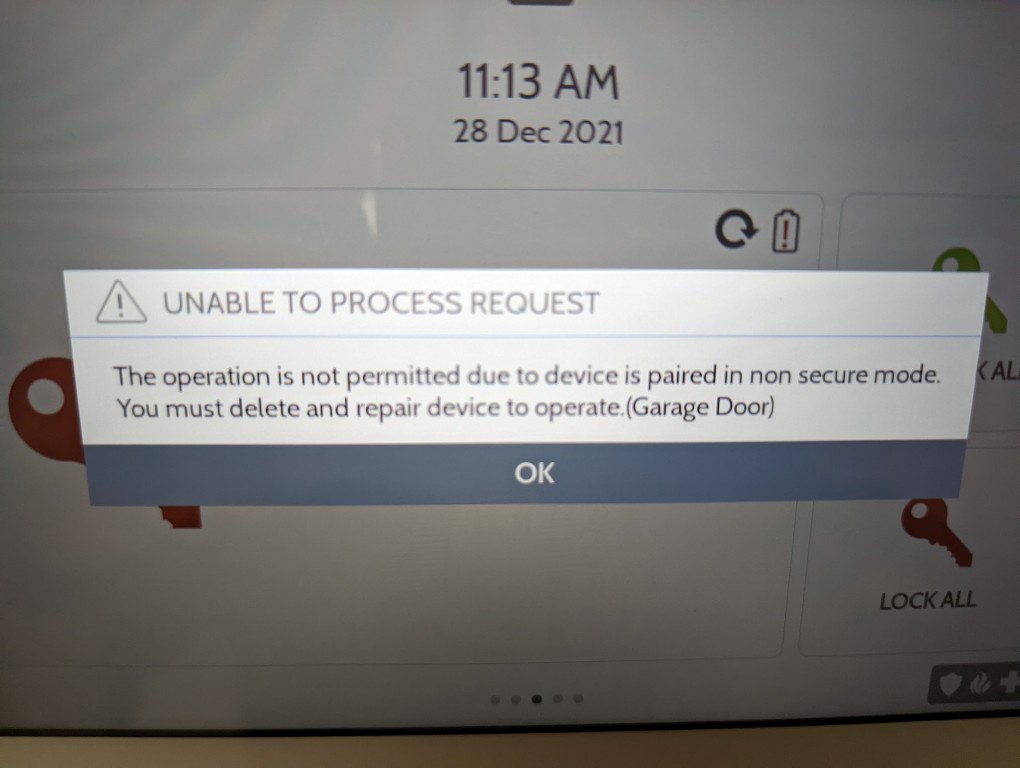

It comes up with S2 access and S0 options both checked during enroll. Once enrolled, the panel displays the lock screen, but no status on the battery, and some error message when you try to operate it. Lock does not move.
So, let’s iterate:
S2 access only: same error. lock doesn’t move. (S2 i guess is the encrypted mode)
S0 only: battery level DOES work. Panel lock screen changes locked/unlocked. But actual lock does not move. Hand operating the lock does not create change of status at the panel either.
So, it does enroll, but it’s useless.

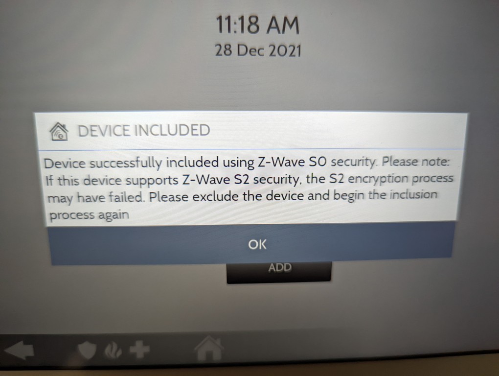

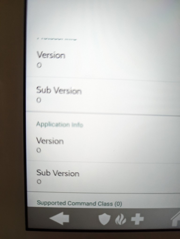

These are the results (same for S2access mode, but S0 unsecured does now work after being enrolled closely)
S2access & S0

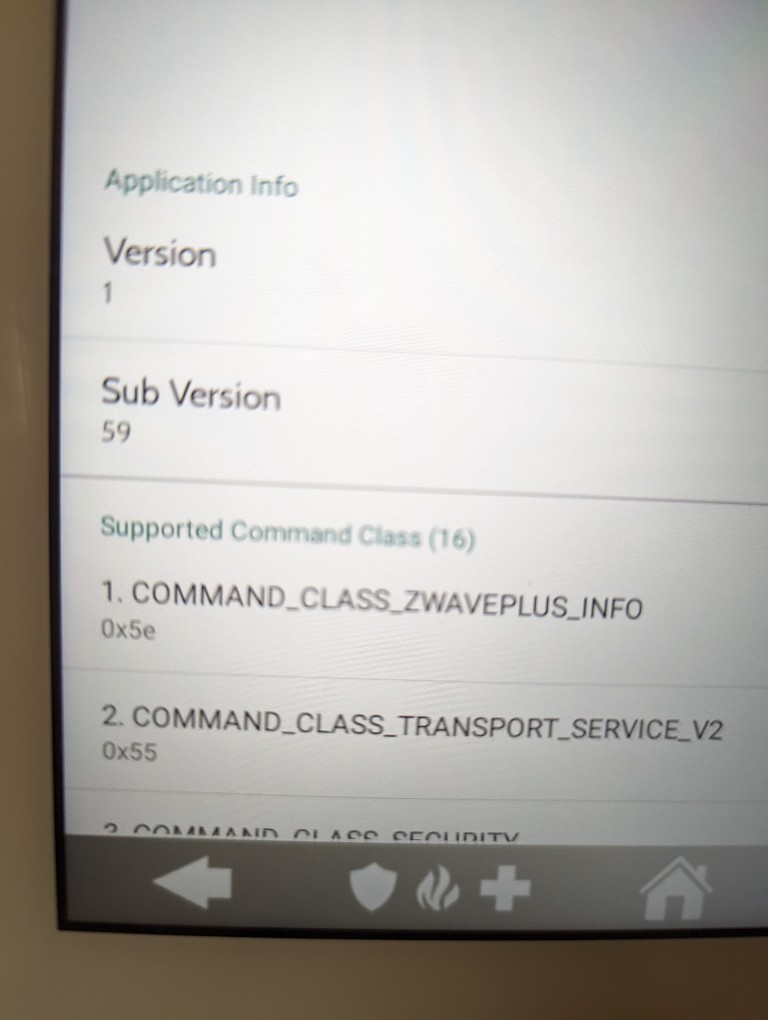

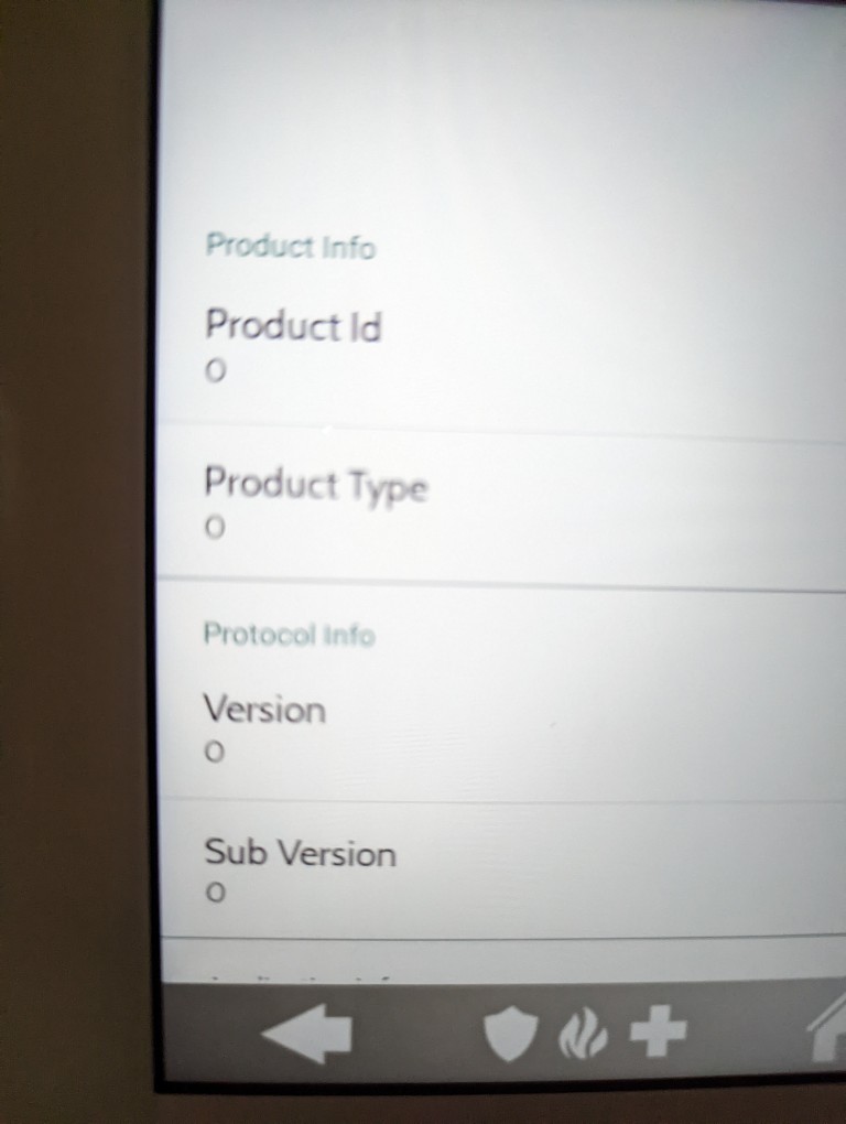

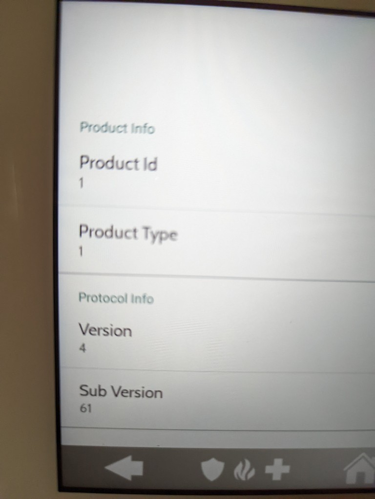

then the device properties show NOTHING

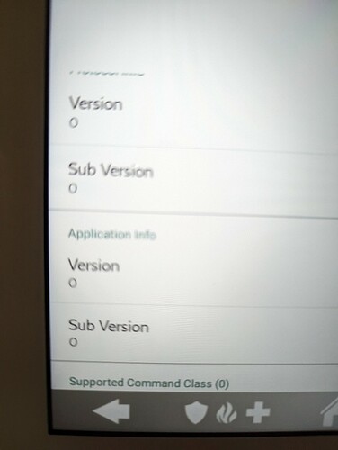

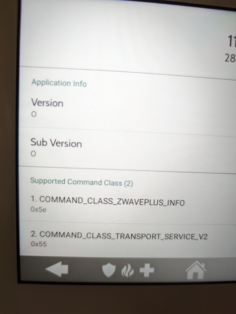

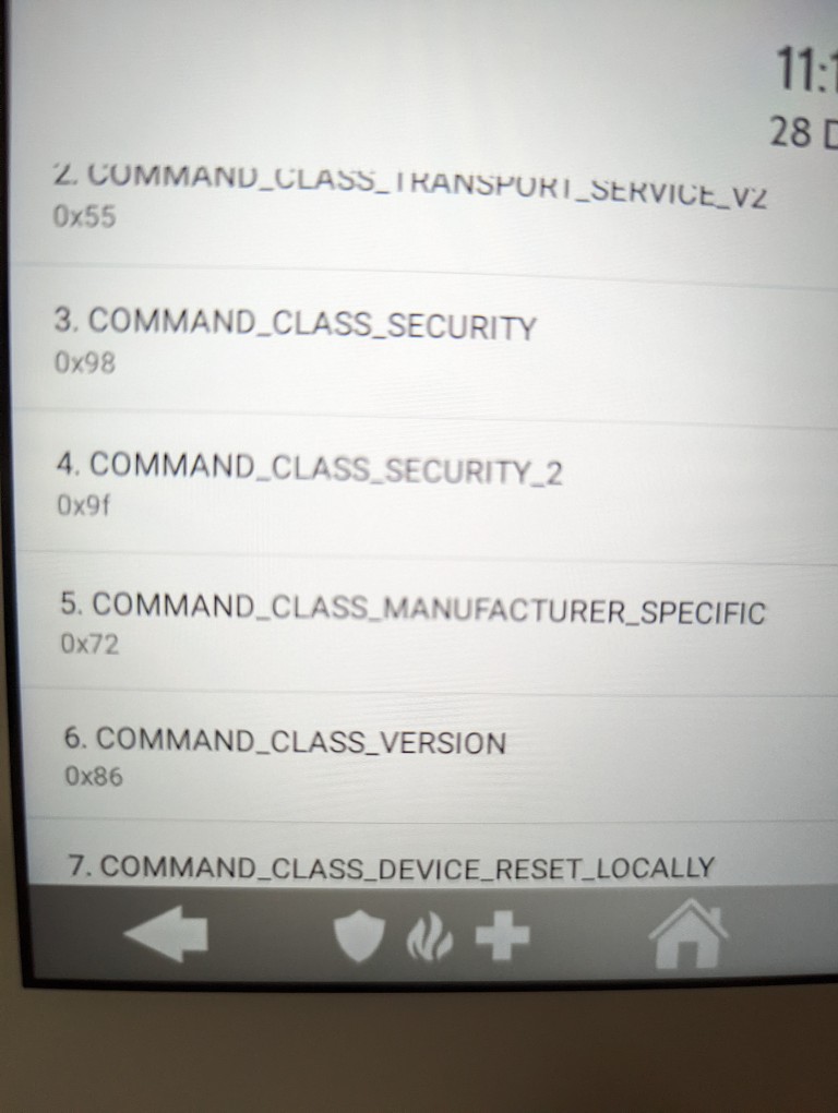

Going to JUST S2access mode during enroll gives pretty much the same thing. same error screen as before, with these properties (lock still does not operate):

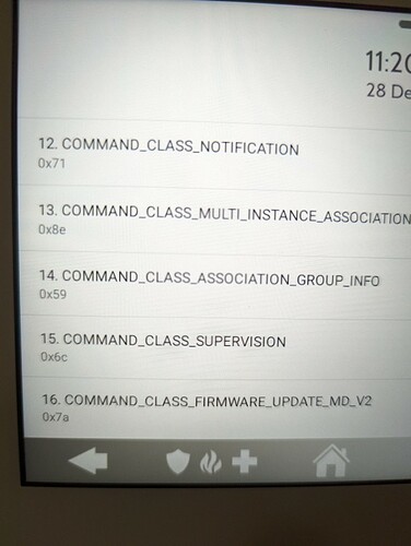

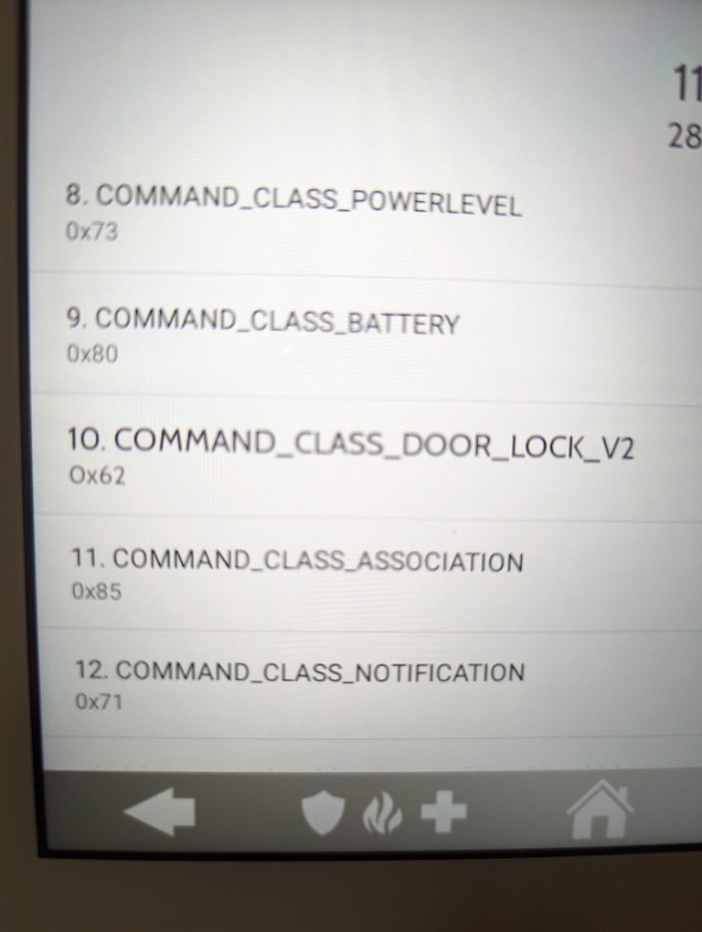

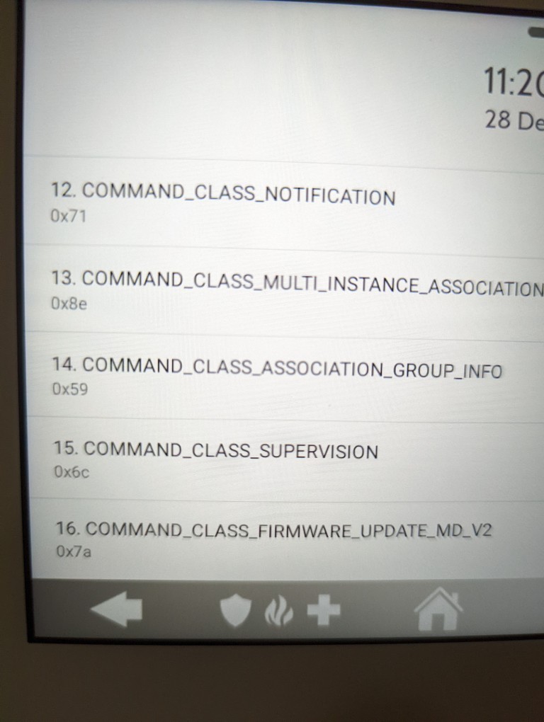

Then there is the S0 option. Here’s the stuff:
So that appears to actually load stuff up, and it actually now operates the lock at it’s install location.
But it is in unencrypted mode.
So not fully supported. And the error screen even said that. I did add the DSK key each time when it was enrolling in S2access and S2access+S0 modes, without issue.
So I think it is a panel software problem.
