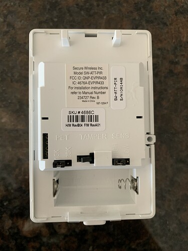

It would be easier to confirm compatibility with sensor model numbers. What are the model numbers of those sensors you have? Can you post a photo of the sensor labels?
Hi Jason,

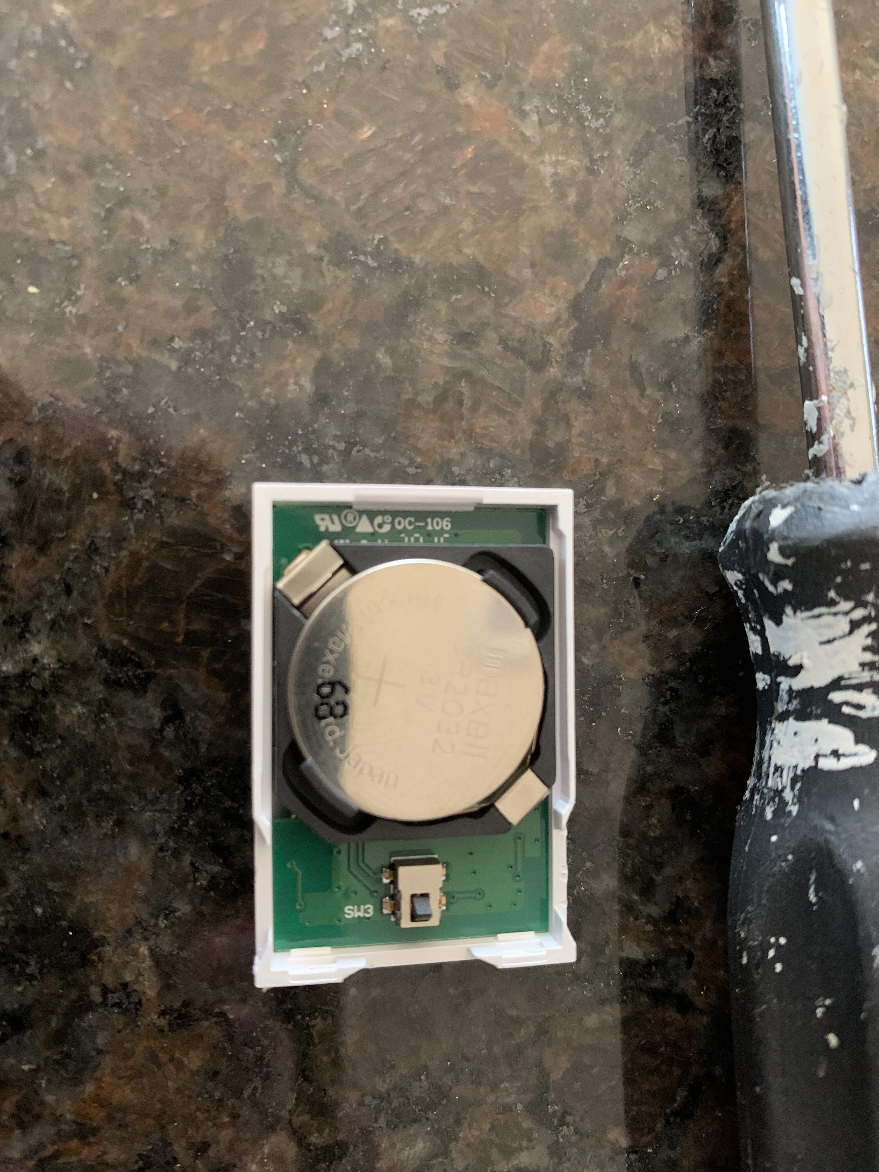

Thanks for your prompt response. I am including photos of the security sensors here. The Contact Door/Window sensors have stickers on the back, and unfortunately they are all mounted to the doors so I don’t have a photo to share of the back. I was able to show the inside of the contact sensor, though I don’t think it will be helpful to you. Is there anyway to confirm with Qolsys on compatibility?
The FCC ID suggests that the carbon and the motion are 433MHz (theres no useful information on that DW). So they may be able to be learned in to the IQ Panel 2 with 433 MHz radio.

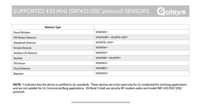

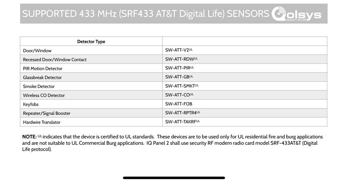

I removed the motion battery while in auto learn mode and replaced it. I did this about 1/2 foot away from the panel with no luck. I repeated this process with the door contact sensors (2) and CO detector. I tried this with (2) motions total. I did see a manual online that references compatible AT&T digital life sensors. The bottom or portion of the manual says,
“ NOTE: UL indicates that the device is certified to UL standards. These devices are to be used only for UL residential fire and burg applications and are not suitable to UL Commercial Burg applications. IQ Panel 2 shall use security RF modem radio card model SRF-433AT&T (Digital Life protocol).”
Perhaps there is a unique daughter card that reads these legacy AT&T Digital Life sensors. At this point, I’m thinking this is the case, and since I don’t have this particular daughter card, I probably can’t use those sensors. Does surety home have connections with Qolsys to confirm this is the case?
Thanks
That appears to be the case here. It is likely that a separate daughter card is needed and that the ATT433 digital life sensors are different enough that they wont work with the standard 433 version of the IQ Panel 2+.
I have reached out to Qolsys for confirmation and any additional information. It is likely that the version of the panel that uses digital life is proprietary and not available for purchase outside of specific vendors (ATT, etc).
Yea, looks like they are proprietary sensors and cannot be used with the QS9201-4208-840. They can only be used with a proprietary panel obtained from a specific dealer.
