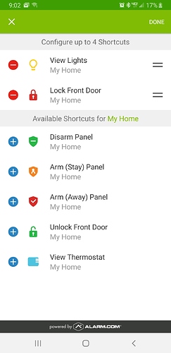

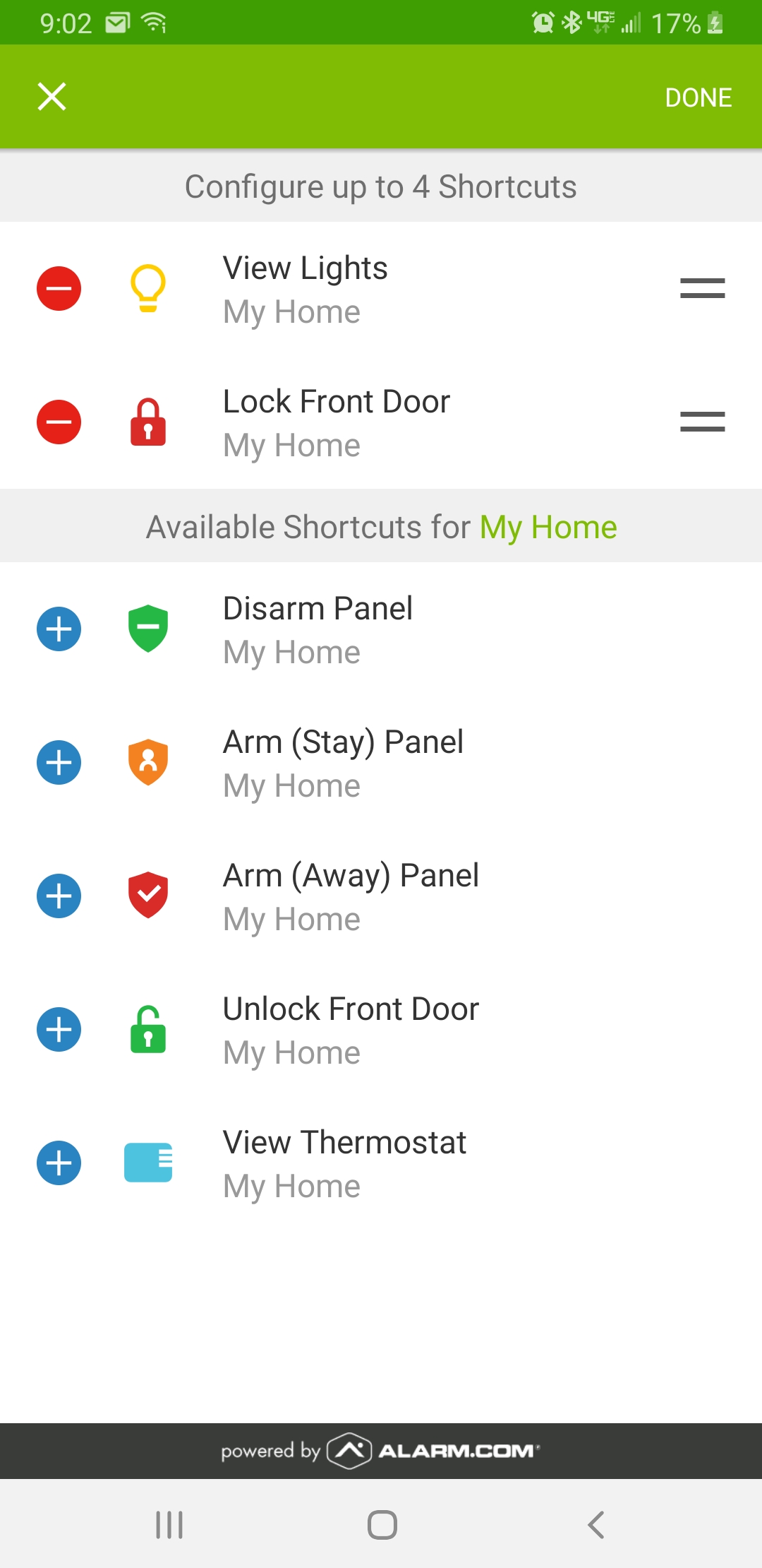

Per the screenshot, please tell me the complete detailed steps to get ‘lock front door’ on home screen, I tried according to your instructions and it didn’t seem to work after getting to point shown on screenshot. Please be specific and dont assume anything in walking me thru from this point as I have already tried many scenarios. Thank you ever so much!!
Based on the screen shot, you have already selected Lock Front Door to be a shortcut. After pressing Done, this will save that selection as a shortcut.
After clicking Done and exiting the app, you want to long press the Alarm.com app icon on your phone (long press means hold the app button down for a bit instead of tapping).
After long pressing, a menu associated with the ADC app icon will pop up, in this menu you will see the shortcuts that you have selected (in this case both View Lights and Lock Front Door are selected to be shortcuts) , along with options to uninstall the app, find more app info, etc.
You can then hold the shortcut icon and “drag and drop” those shortcuts to be actual buttons on the phone. Clicking on the shortcut icon will then send a command to complete the associated task.
