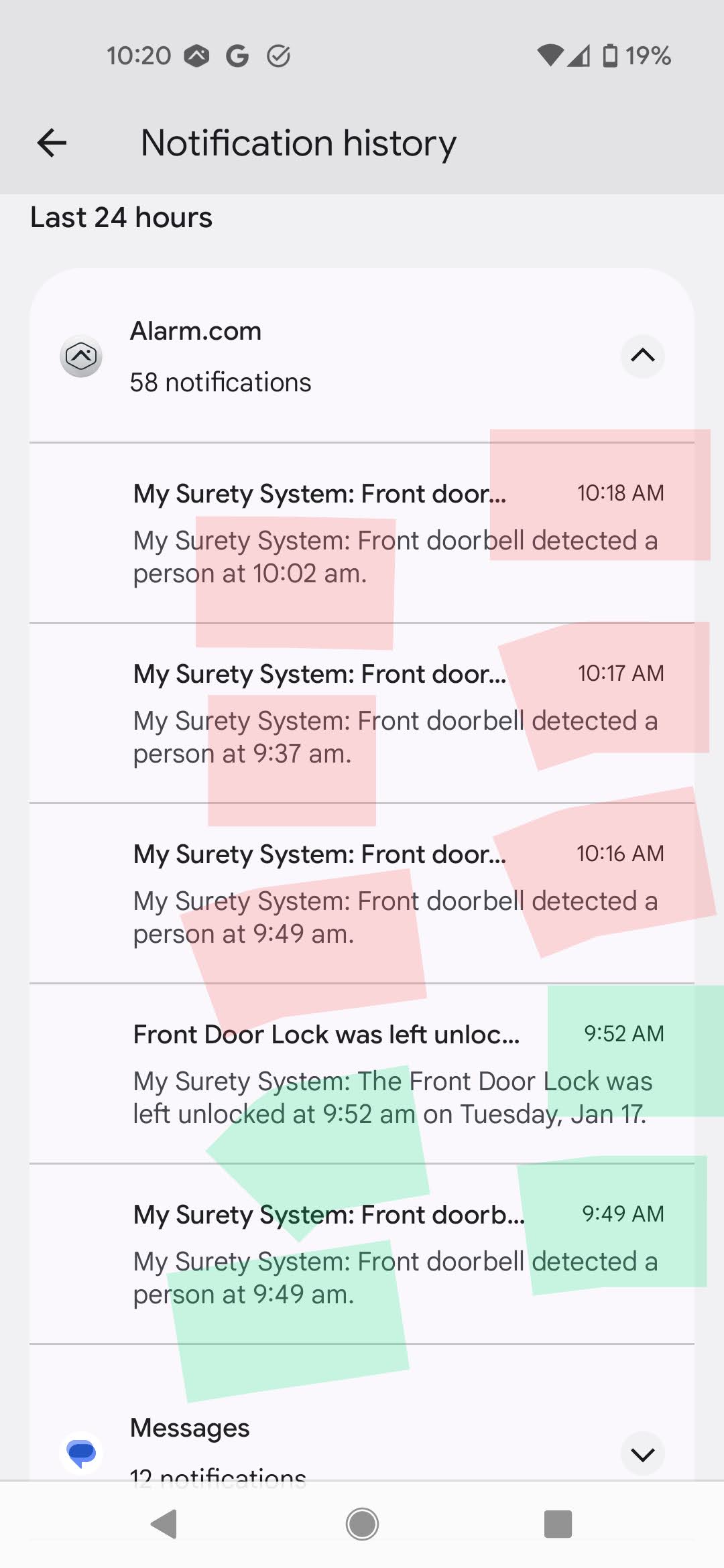

How can I troubleshoot notification delays? I have seen this off and on since I installed the system, most consistently with doorbell push audio triggering on the phone, most often the person is long gone by then. This week though I also see sporadic delays of 20mins or so to some, but not all, push notifications. Are there known network issues right now? Anything I can check? I would like to get all security related notifications immediately. FWIW, notifications from other apps don’t appear to be delayed.
Looking at your history, the push notifications in your examples are being sent within 1 second of the event occurring.

OK thank you for looking. Solid cell and wifi connections, adc app has unrestricted permission, battery has good charge, phone gets restarted frequently. I’ll continue to poke around on this end.
