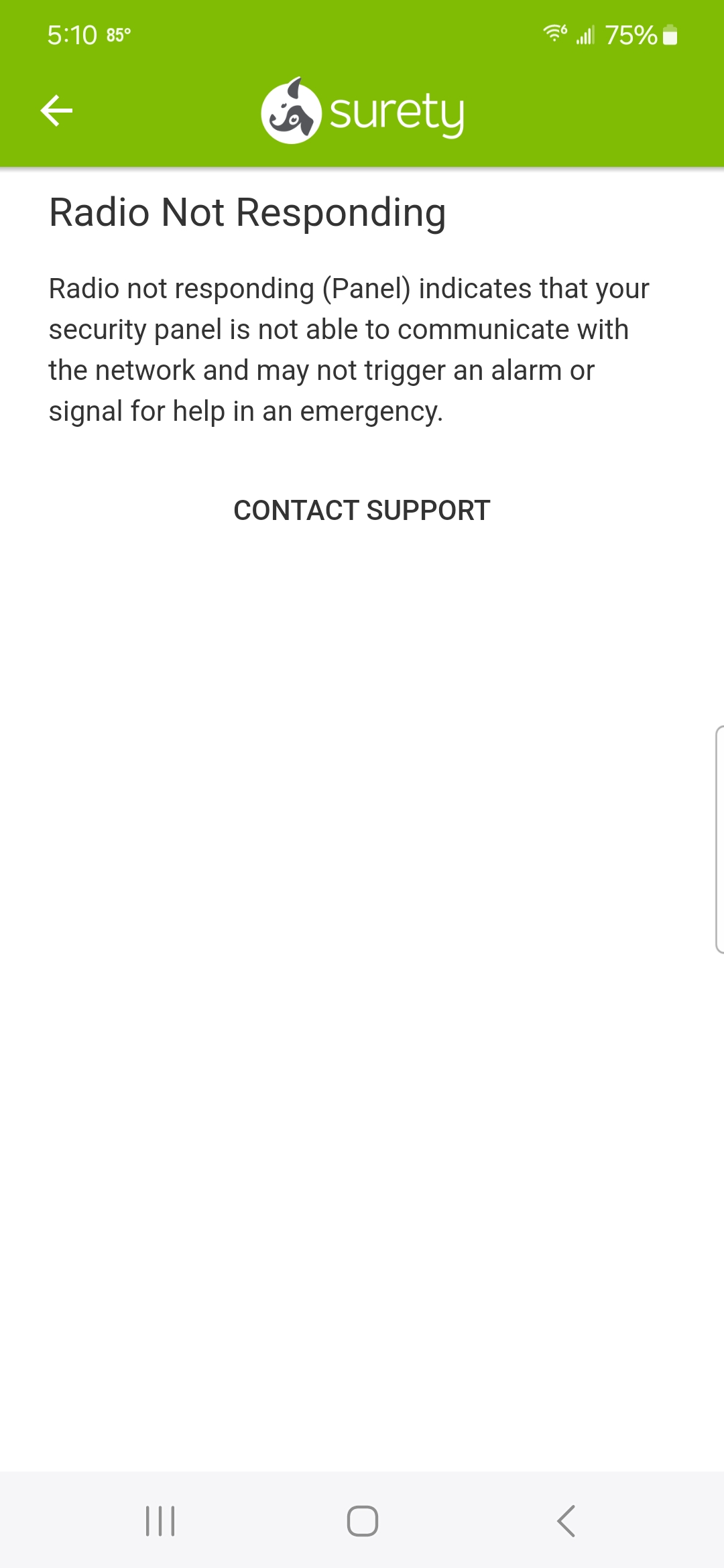

My alarm.com app has an alert that reads Radio not responding. I can not control any devices through the app or website. The IQ panel is still controlling the devices. I have already updated my app and it is still not working.
That means your control panel can’t communicate with Alarm.com. Updating the app wouldn’t change that.

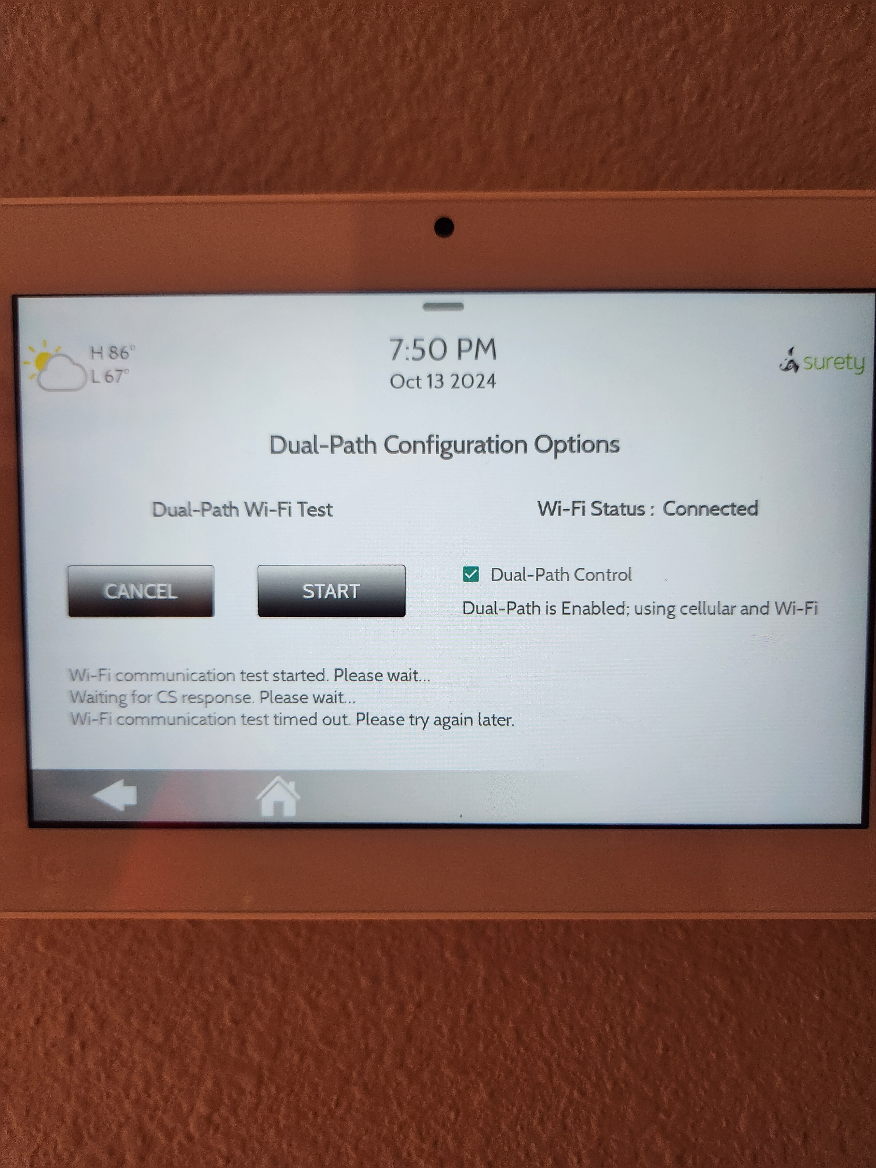

I am in the Tampa Florida area so there are a lot of outages but I tested the wifi at the panel and checked out ok. Do I need cellular?
That dual path broadband test is indicating that the panel cannot communicate over your internet to Alarm.com. Cellular is out too, resulting in the Radio not Responding status. There are a lot of systems in the area which experienced this due to the hurricane, but it looks like most have resolved. There may be isolated areas when cell service is impacted, but in this case it looks like the panel may be causing the issue instead now.
