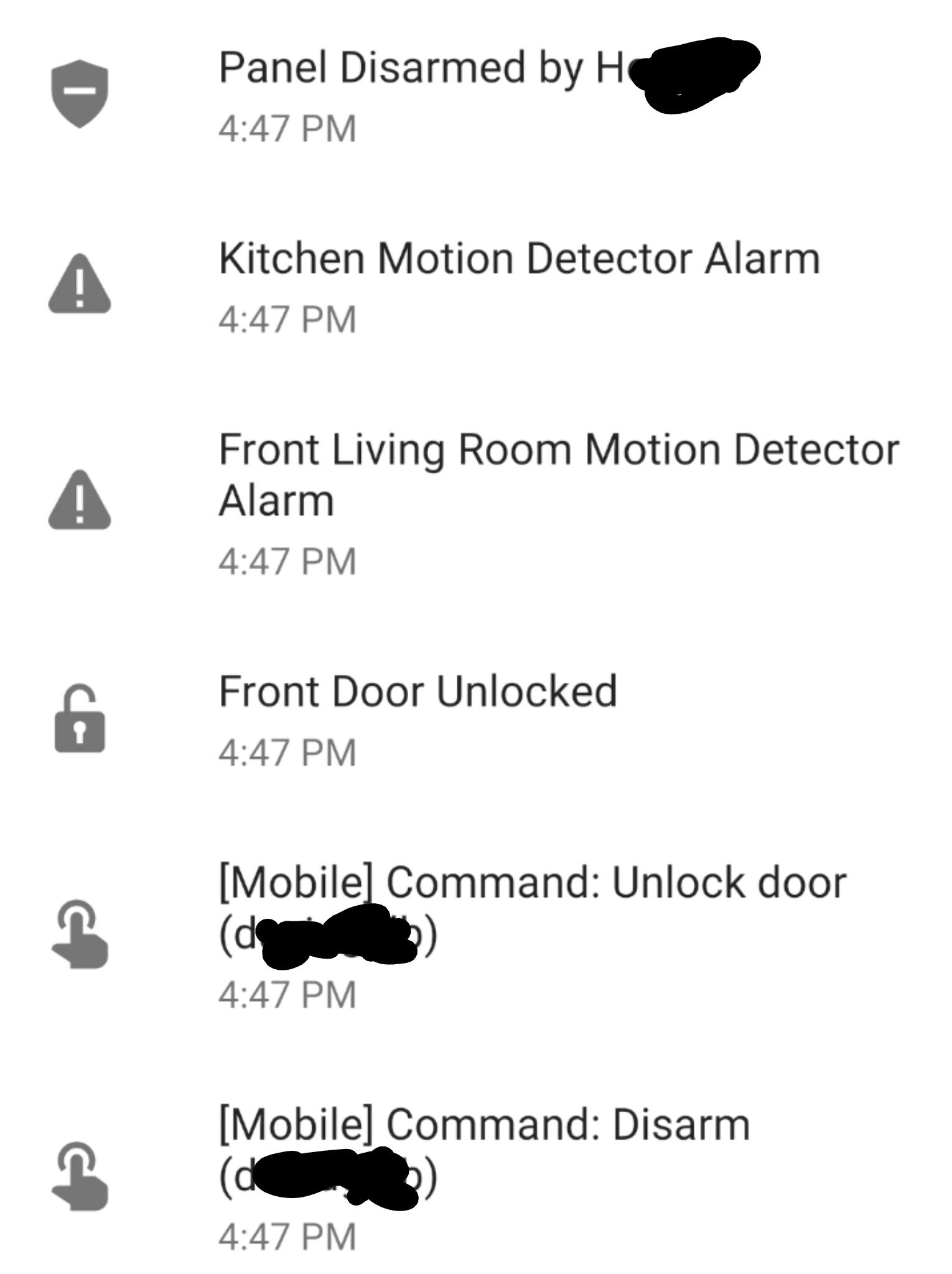

So, I am a bit perplexed as to the series of events that took place here. I have attached a screenshot of the alarm history for your reference. Can you take a look and let me know what may have happened here?

Depending on how long after you sent the command you walked in, this would be pretty normal. Always allow a minute or two for remote commands, even though they usually hit the system much quicker, there may be latency.
Immediately after going in, 2 PIRs tripped and sent an alarm state to monitoring. We immediately disarmed the system from the GC3e panel.
I’m sad to see this affects the GC3e as well. There is an issue with 2GIG GC3 panels, starting with firmware 3.2.0, which causes them to basically treat zone type (04) Interior Follower like it was a Perimeter sensor instead. It will not be disregarded during entry delay like it should.
The work-around for this currently is to set the motion detectors as (10) Interior with Delay.
We’ve been reporting this to 2GIG for quite some time. I am comfortable frankly stating that I am disappointed in their response to this problem. I’ll be forwarding this case as another example today.

Based on history it looks like the disarm occurred immediately following the alarm, so an alarm signal went out, but the alarm was immediately disarmed (the time-stamp in your ADC history on the first alarm and the disarm is one second apart).

I have never heard of this type of behavior, specifically, where it waits until activity at the panel to sound the alarm, but it would be related to the broken Interior Follower zone type. I do see in event history that the motion detector triggered the alarm, and that alarm was picked up during entry delay.
It doesn’t look like the sensor type was changed yet on the motion detectors. Can you confirm whether or not your motion detectors were switched to Sensor Zone Type 10 Interior With Delay?
If they stay at Zone type 04 Interior Follower, there will be false alarms from them if you walk in front of them during entry delay.
