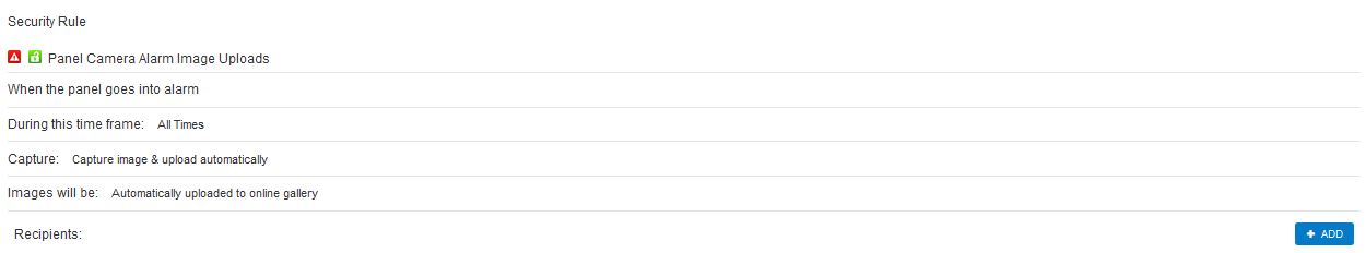

On the ADC Website if I go to Settings>Manage Devices>Security System 3 dots> Device Settings>Rules>Panel camera Alarm Image Uploads and try to edit the rule I get the following screen:
It does not give me an ability to verify the sensor pool image will be triggered after alarm.
How can I make sure all 6 image/video are active after an alarm?
  • Video Cameras take video during an alarm state using the recording rule Alarm Schedule
  • The Automation rule Panel Camera Alarm Image Uploads is for the panel camera and Image Sensors, in this case the sensors labeled Sensor Pool, Sensor Garage, and the Panel Camera are associated with this rule
    • The Image Sensors are automatically associated with this rule, you can confirm which devices are associated with the rule from the Automation > Rules page.
