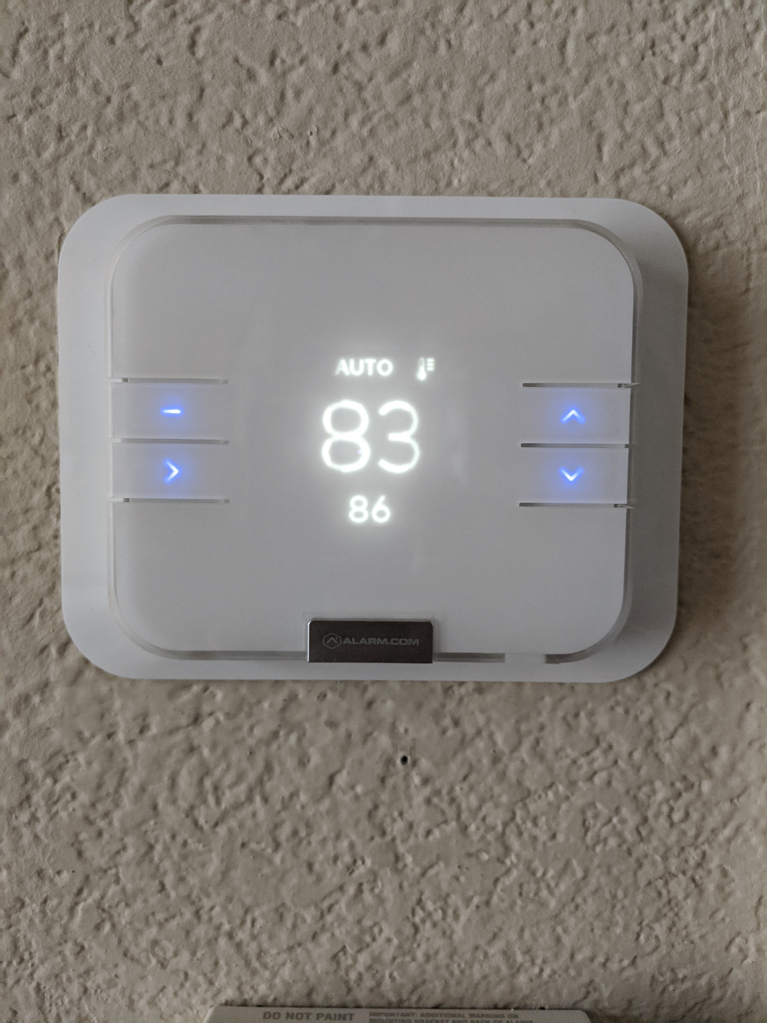

Now it’s 5 degrees above the schedule. I have the smart humidity turned off. I used to have the temp go up 5 degrees on hot days but I turned that off about a month ago but it seems to be still in effect. Or the A/C just not turning on when it’s supposed to. Not sure what to do.
There are a number of other interactions that may occur. Please be sure to go over your thermostat rules in Alarm.com. A possible cause may be Smart Away. You have Smart Away enabled, which uses your Away schedule temperature when you arm the system Away mode.
You also have Sensor Left Open energy saver rules in place. It looks like they are set to turn the thermostat off if any one of a group of sensors are left open for 2 minutes.
While it is possible that the old extreme temp rule never got purged successfully from the thermostat if there was any signaling issues at the time in the Z-wave network, I would make sure to look into other issues first.
If it seems the extreme temp override is still occurring, try turning on and off the extreme temp rule again. this should clear it.
