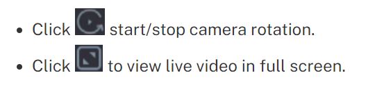

  • Click and drag the live video panes to rearrange them. The ADC-CSVR126 retains this arrangement after it is rebooted.
  • Change the layout to any of the following options:
    • Cycle through different video pages if there are more cameras than the selected layout can make visible.

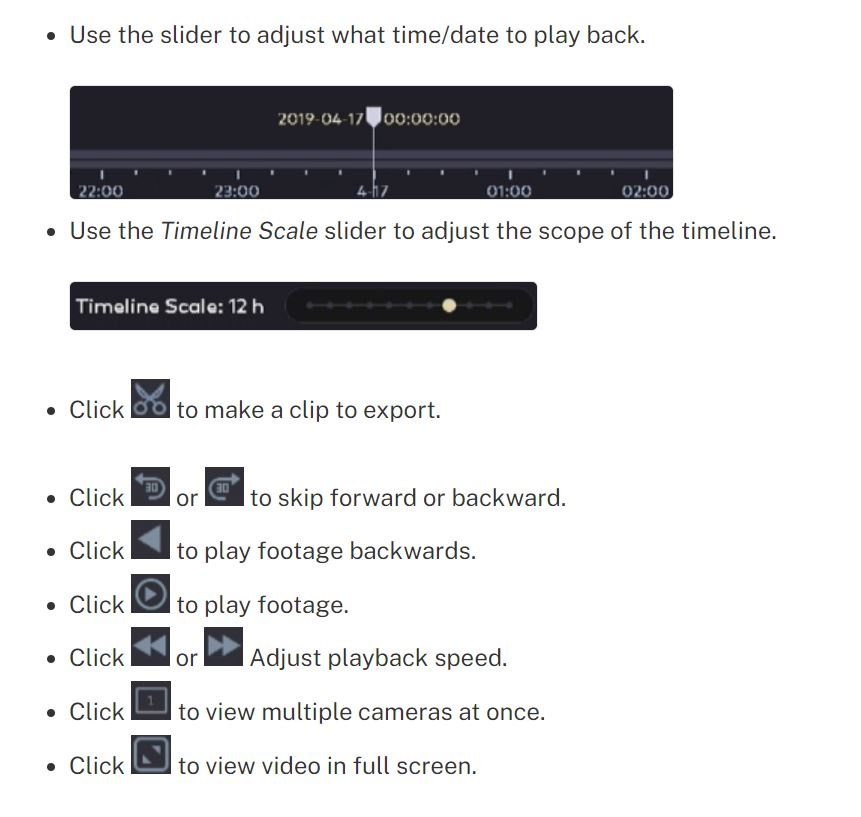

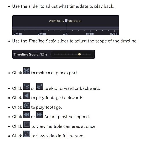

To access recorded video using the local interface:
  1. Log into the local interface if it is password protected.
  2. Click Menu
  3. Click Playback.
  4. In Camera, select which camera to play back.
  5. In Time, select a playback date.

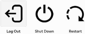

Users can turn the Commercial Stream Video Recorder on and off, factory reset it, and log out of the system.
  • Click Factory Reset to reset the device to its default settings.
  • Click Power to access options to log out, shut down, or restart the ADC-CSVR126.
