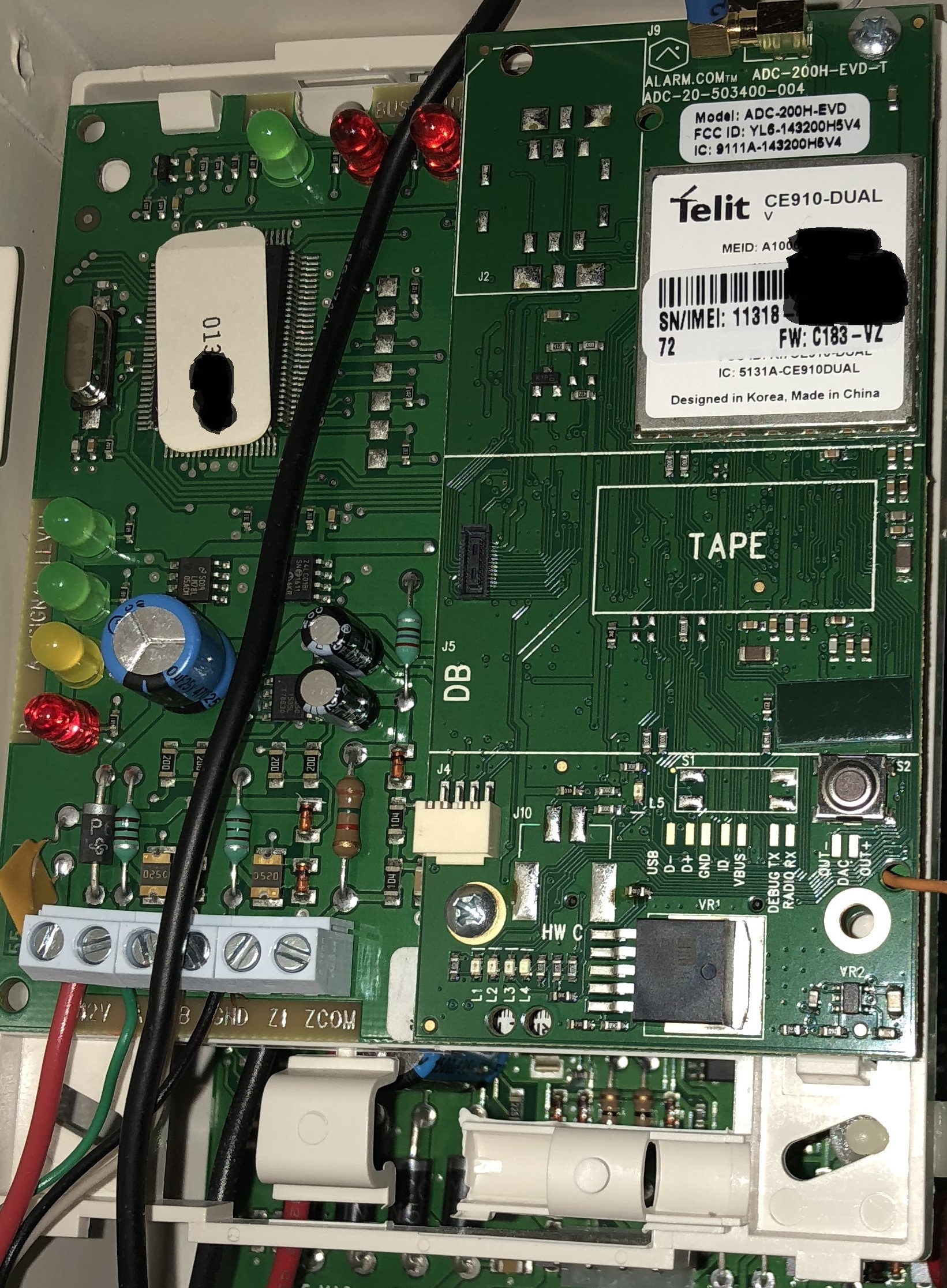

I could not locate the button to activate the z-wave inclusion mode on the alarm.com board that is shown in the alarm.com manual referenced in the last message. So, I set this project to the side for a year.
Now, the Leviton VRCPG-SG has failed and am attempting to setup the network with the Leviton Installer Tool. The immediate problem that I have is that I still cannot figure out how to get Alarm.com’s hardware into inclusion mode.
I have attached a picture of my board with some redactions. Please let me know if you need the numbers I have hidden and how to get it to you securely.
