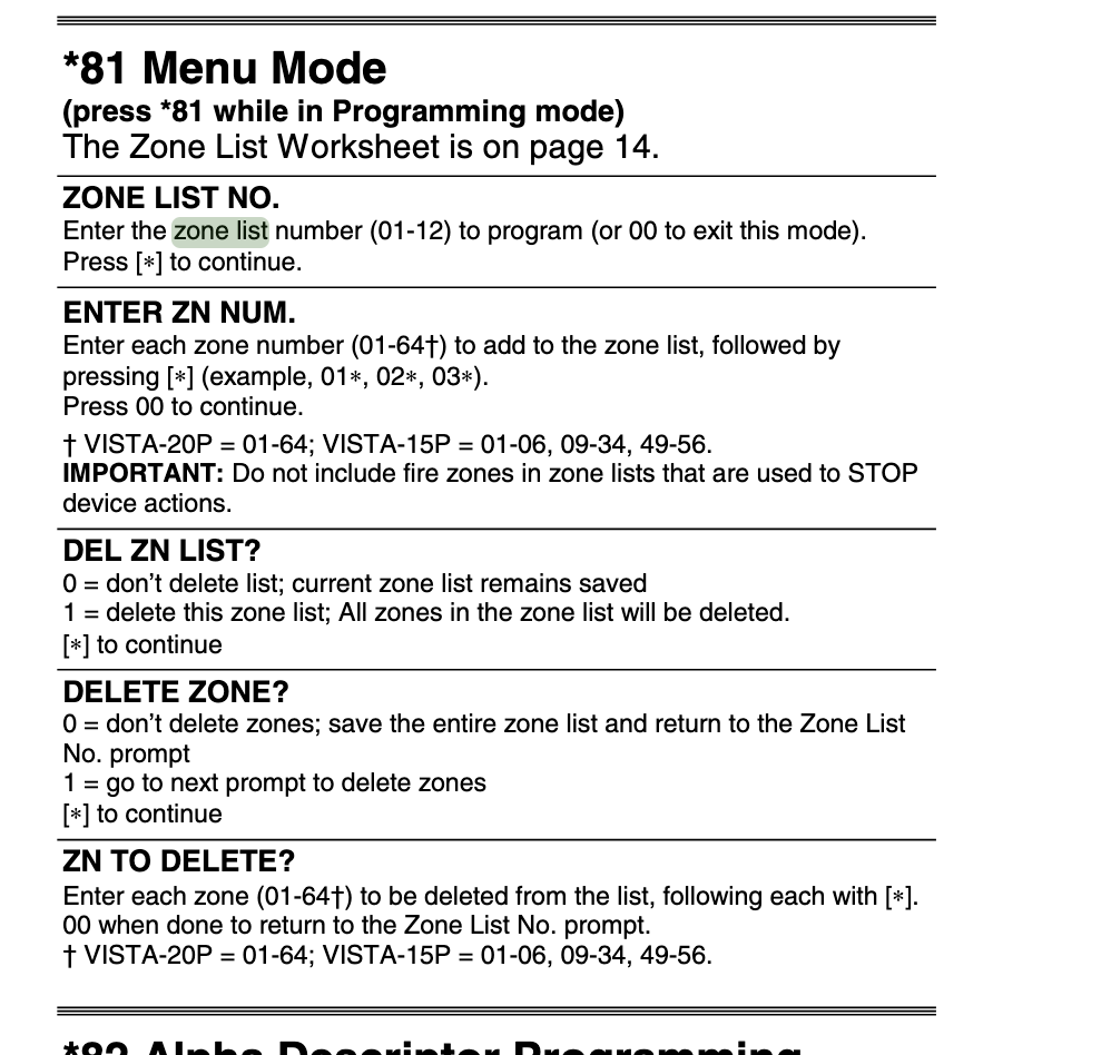

So struggling here a bit, still learning this system. An issue I’m having with understanding programming is viewing programmed info. No exception here, I might just not be fully understanding how data is presented.
  • I enter programming mode - + 800
  • I enter *81
  • I’m prompted to enter zone list no I enter - 05*
  • I’m prompted for zn no, the following entries give the following result
    00 - displayed at start
    01* = 02
    02* = 00
    03* = 00
    04* = 00
I’m not sure how to interpret that information.
Apologies for the ignorance, I don’t have the fundamentals down just yet.
If you are at the “Enter Zn Num.” prompt in programming and you enter zone numbers, you are adding those numbers to that list, not checking them. The zones your panel is reporting to ADC appear to begin at Zone 7 however, 1-6 are not reported in your sensor list as being used.
If you are trying to make sure the motion detector is not a night zone list sensor, you would move on to the DELETE ZONE? prompt, press 1*, then at the ZN TO DELETE? prompt and enter 12* (that is the motion detector zone number I see reported by your system.)
Hmm ok, guess I need to unwind the zones I added too.
So to try and comprehend some:
Under Zone list, zone 5 is a “night mode list”?
So to I should go into programming, then 81, enter 05, then (to clean up) 01*, 00 to continue, then 1 to delete * to continue?
Then repeat for motion on 12 - enter programming, then 81, enter 05, then 12*, 00 to continue, 1 to delete, * to continue
Lastly, how do I actually view configurations without adding/changing?
Edit: Looks like pressing (*) after entering the zone list will cycle through programmed zones. I only see 02,03,04, I assume from adding them earlier. So I’ll clean those up.
When prompted for Zone List Number, yes #5 is the Night Zone list. Adding zones to it makes them night mode zones.
It has been a while since I used night settings on a Vista, but based on the manual I would think you would hit * 81 - 05* - 00 - 0* - 1* - then each zone you want to delete from the list, so, for example 02* - 03* - 04*. Then 00

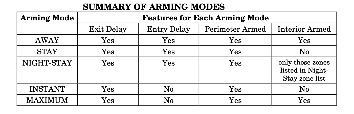

Ok, so i’m not fully understanding this mode yet. So “Night Stay” arming would include any zone normally in stay PLUS anything in zone list 5 that isnt’ normally included?
Correct. I am adding a table from the manual below:
Got it thanks. Do you have a link to this manual? The programming manual I have seems to not contain this table and some other information.
I removed the erroneous zones from zone list 5 and removed zone 12, tested in night stay mode and it operates as expected.
Thanks for the manual.
