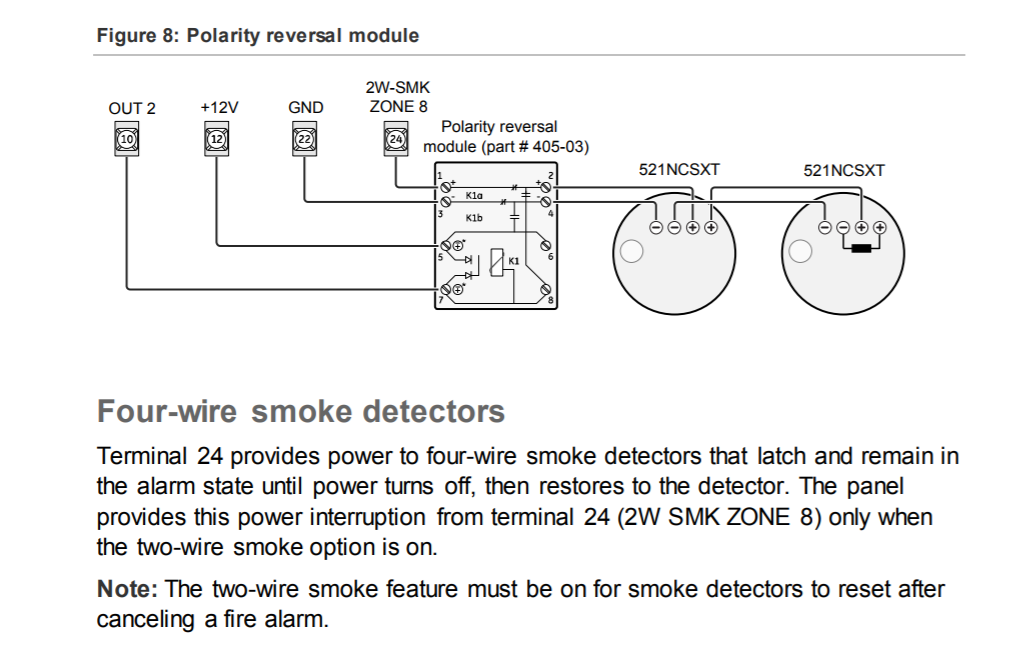

If you install a hardwired smoke that is latching, I believe the reset must be done locally at the panel via disarm twice in a row. I do not believe remote commands can accomplish this, but I will verify. See the attached image from the Concord installation manual for 4-wire setup.

To clarify, per Concord instructions, you would want to wire smoke detectors on Zone 8. Terminal 24 (Zone 8) provides the power interrupt for resetting the detector.

Yes, my apologies. My point was there was only zone 8 which can cut power and reset the smoke detector circuit, which would limit zones, but I did forget that you can program the outputs for smoke power and reset. The actual output programming code is 01500. That will provide the output terminals with smoke 12vdc power and will reset them by momentary power removal. (by the same reset process, disarm twice on keypad.)
