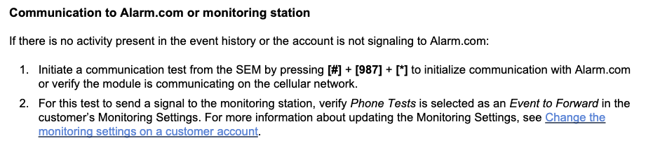

I’ve cycled power and attempted a communication test as instructed on the Surety System Manager page but nothing changes. I noticed the following troubleshooting tip in the SEM installation guide. Any suggestions? Appreciate the help!

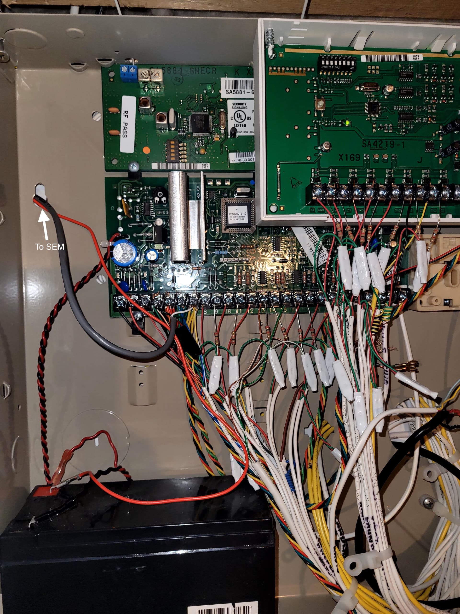

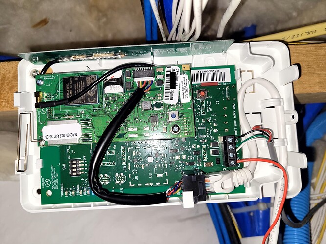

So that we can best assist can you provide a clear photo of the wiring at the SEM and at the Vista panel?
Can you confirm the version info on the prom label as well? A photo of the panel board should show us what we need.
Hi, the PROM version is 9.12 from 2010. I’m attaching photos of the SEM and panel.
I used the black, green, and white wires from a 22/4 cable from the SEM connectors to connect to terminals 4, 6, and 7 on the panel respectively. The red wire was left unconnected.
The red power wire included with the SEM connects from the SEM screwpost to the battery in the panel box. The panel’s existing battery connection is piggybacked on top at the battery terminal.

Could you provide a list of devices on the panel? Keypads with the model numbers, zone expander and any other devices.
Do you have a multimeter to check voltage on the panel? Could you check the first two terminals on the panel checking for AC power? Could you check the power on the SEM300 by checking for DC power on the black and red wires?
