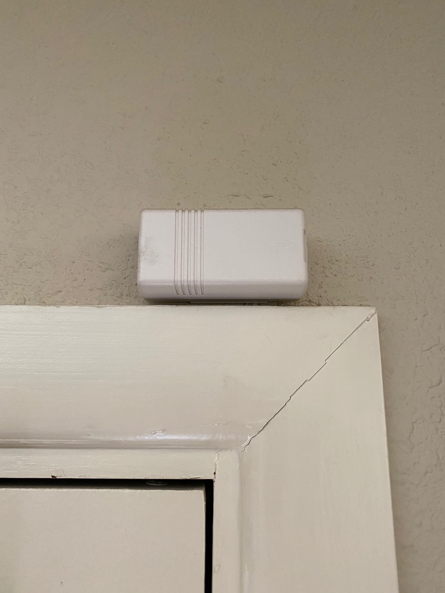

I’m buying a house that already has an ADT system installed and I want to replace it with something better like the IQ Panel. (I have an IQ Panel/Alarm.com through Brinks, all of that equipment is being sold with my current house.)
My question is can I keep any of the ADT sensors or should I get new ones?
Those appear to be wireless Honeywell 5800 series sensors. They could be used as is with the 345 Mhz version of the IQ Panel 2+. That’s found here.
