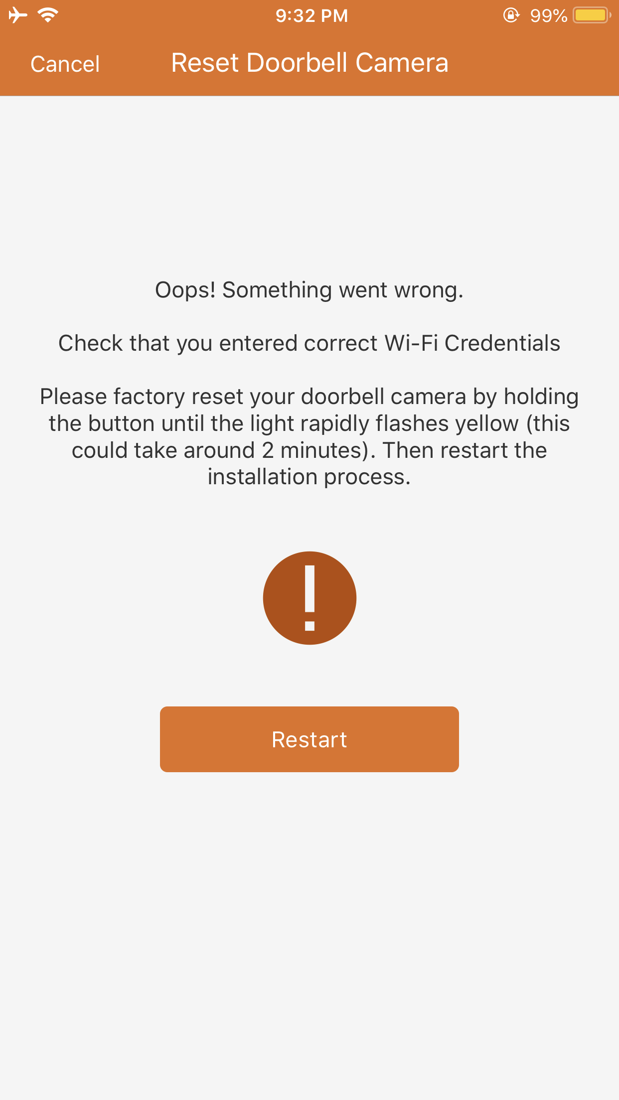

Hello, I purchased yesterday new Monitoring and Video services for Alarm.com through SuretyDiy and once confirmed, I activated the account and configured the App, I am however facing difficulties with the DoorBell Camera, it always gives me the attached error when attempting to add it to the account from the App, regardless how many time I reset it. Also, the other Cameras are not showing on the App and I get the attached message and I am unsure on how to add them for Video Monitoring. Could you please help ? They are Alarm.com outdoor cameras.

Here are the steps that I take, I reset the Doorbell, (Yellow and Blue flashes), then I open the Alarm.com app, i select DoorBell and select Add, It requests that I create the Name for my Doorbell (and at this point, i am still connected to my Home Wifi), once the name entered for the DoorBell, It takes me to the next Screen where it asks me to Connect to the "DoorBell wifi) and i leave the App to go to my Wifi network connections, i see the SkyBell42574kol45 network and connect to it,once connected, i get the check mark next to the SSID, but it still spins and takes a while to connect, and once i receive the Wifi logo on the tablet/iPhone showing that the phone is now Connected to the Doorbell wifi, I return to the Alarm.com App, and Right Upon Opening the App, i get the Error message provided above.

In order to factory reset the SkyBell as described in the error message, you will need to hold the button down for about 80 seconds or so until the light flashes just yellow rapidly.
