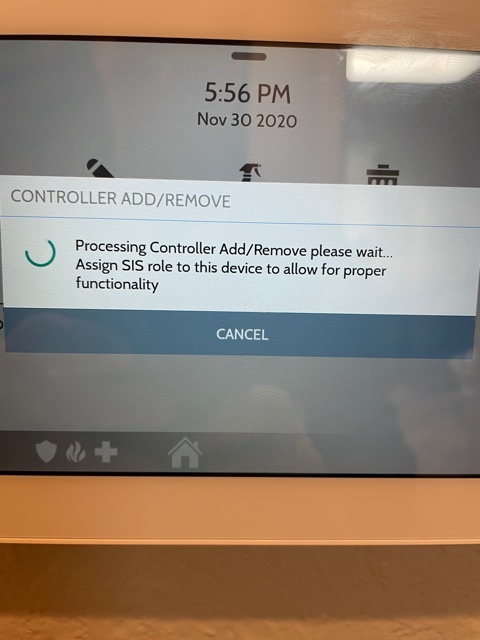

So, I go to add it. Vera as primary, Qolsys as secondary. When I hit the add/remove panel on the Qolsys I get a message to add a pin to the main device. I’m not sure what I’m supposed to do with this.
I tried it again and it made it past this part. It has added 3 unknown devices. I’m not sure what these are. On the Vera side it is stuck at ‘Please wait! Getting secure classes’.
Here are the screenshots from my panel.
I know my Vera is set as primary.
