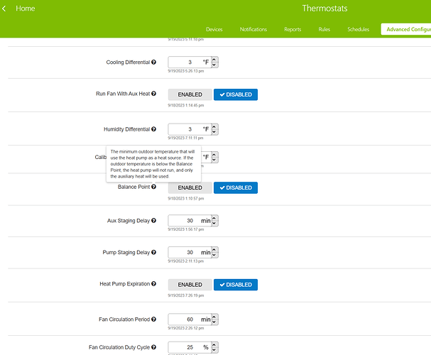

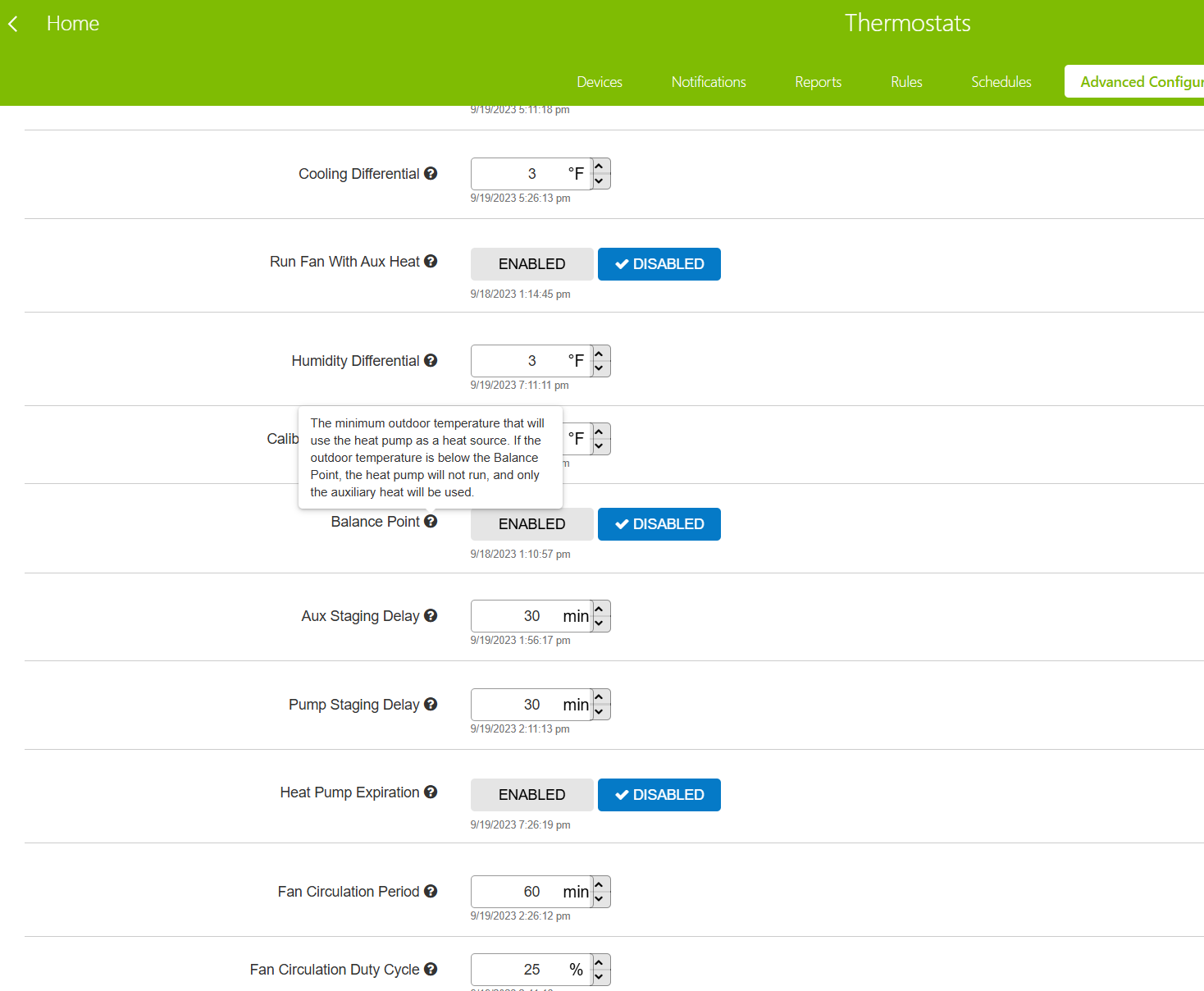

Here is a quick screen shot of one of the thermostats, but I believe I would need to enable that, and set that balance point (which I believe is the outside temperature it will disable the heat pump and use aux/emergency heat, correct)? Mainly I’m trying to protect my unit from premature failure
If you are not manually setting it on emergency heat, you would need to configure the Balance Point to bypass the heat pump based on temperature.
When you click the Enable option for Balance Point, you will be able to select the temperature value below it. Temps below that value would bypass the heat pump.
Balance Point is only available for Alarm.com Smart Thermostats with firmware 1.50+.

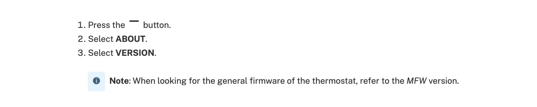

Thank you. So checking on my adc3000, since it has 1.4, even if the feature is present through alarm.com in the config (seen above), it would not operate, correct?
I would expect it not to show up actually. Is that the MFW value?
I believe so. Thats why I was surprised it was available through the URL options, but I dont see a place to set it on the actual thermostat itself
HFW 1.40
RFW:1.30
ZFW:1.44
HW:8
Alarm.com got back to me and stated that the Balance Point feature works on all versions for the T3000, T40K, and T25 at this time. The T2000 is the only thermostat with version limitations according to ADC.
