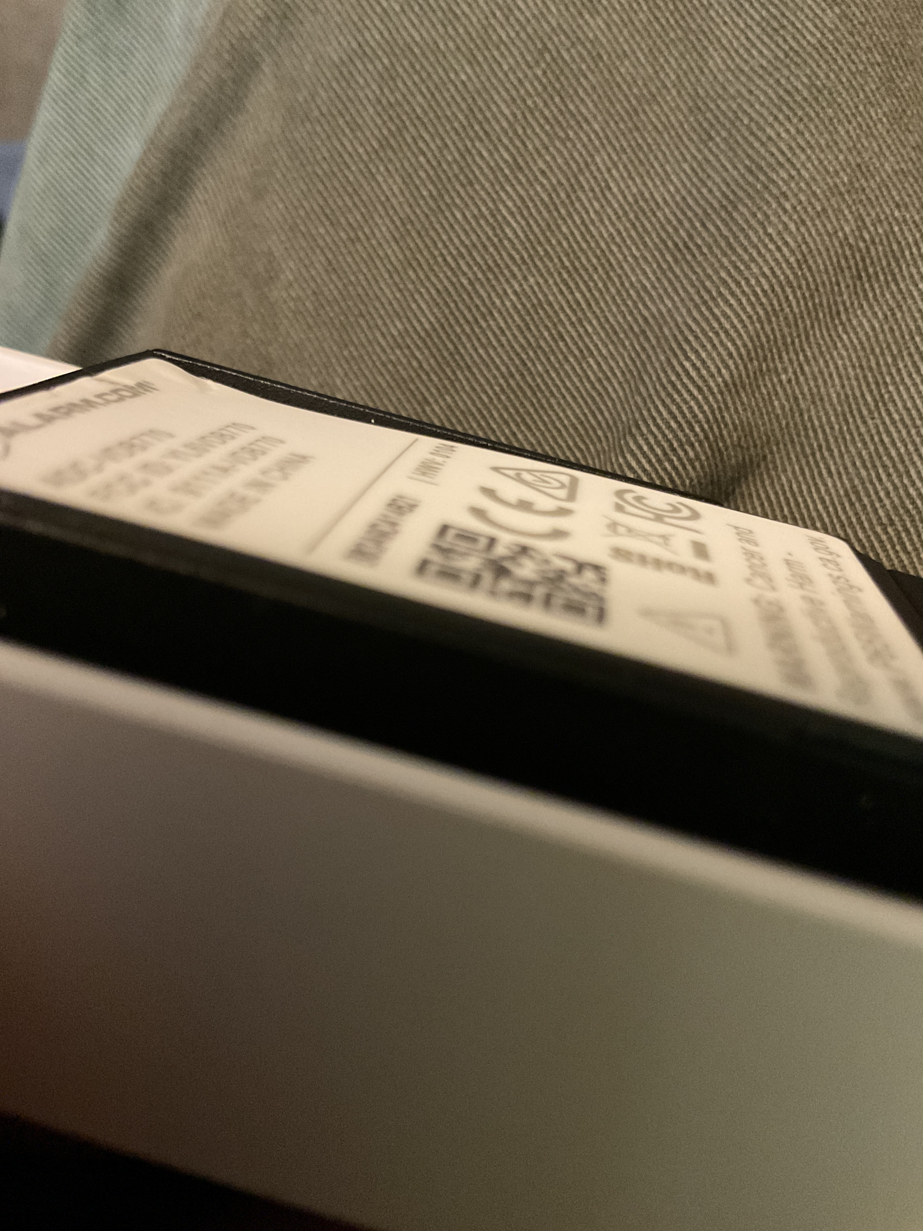

    • we have seen a small number of cases where the internal battery will go bad and swell. This can cause the doorbell to not make a proper connection with the back plate. You can tell if the battery is swollen as the white sticker with the SN and QR code will not be level but instead a bit pillowed.
As far as I can tell there is no swelling of any sort. Everything is in order the way it should be, I’m thinking it may be something else. Can the power module go bad? I will spend $40 on a new one if that will fix it.

Hi Jason, I am having the same problem. Doorbell stopped working recently after roughly 2 years of operation. It appears to be an issue with the contacts because it will try to power up when I attach it to the back plate, but then it loses power. It does maintain power via the micro USB port. I see more of an indentation vs a pillowing at the battery area, but it is certainly not flat. What should I do?

Reporting back to confirm changing the battery restored the device. Fwiw, I did not have puffy back which seems to be indicative of dead battery. Sharing in case anyone else is troubleshooting similar.
