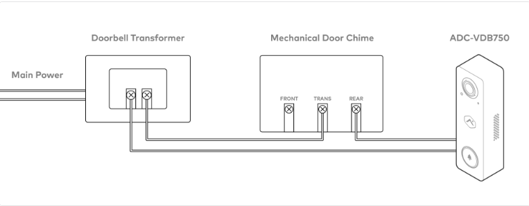

What is the VA rating of the 2nd transformer you put in? The power requirements for an ADC-VDB750 are 16-24 VAC, 10-40VA for AC transformers and 15-24 VDC, 6-20W for DC transformers. If the transformer meets the power requirements, then the issue may be with either the doorbell itself or the wiring leading to the doorbell.

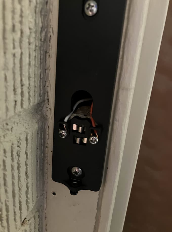

Could you post a photo of the wiring at and behind the doorbell? What is being described sounds like a physical short circuit.
Installing and pressing the doorbell button may be placing pressure on the wires and falicitating that short, depending on how they are routed behind the doorbell.

Thanks, yes that shows plenty to verify it is not likely wiring related. I wanted to be sure we rule that out.
Changing the doorbell chime setting to Digital unfortunately would be the cause. When you do that it results in the expectation that there is:
An appropriate chime load wired to the circuit
The power module connected to regulate the power.
If the doorbell expects a chime and there is no chime connected, then the doorbell button is just shorting the transformer wires when pressed. There is no load in between the two sides of the circuit in that scenario, both wires just lead directly back to the transformer.
