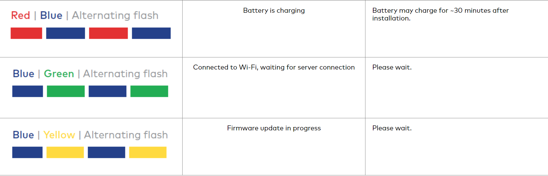

Is it flashing only blue, or alternating blue and other colors?
The doorbell should only flash blue by itself as a status when holding the doorbell button down for about 70 seconds, this initiates a reboot.
As for other blue LED related statuses:
Does it actually respond as expected when holding the button down to power cycle and factory reset?
