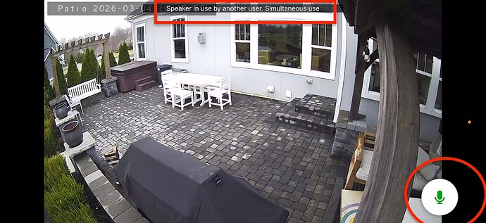

I have an ADC-V724. When I try to engage the speaker and talk through the camera, I get the message “Speaker in use by another user. Simultaneous use”. I am using the app on an iPhone 17 Pro Max using the latest firmware. I have not tried to use this speaker button in a long time so I am not sure it is operator error or an issue. I did just put a memory card in the camera and setup a 24/7 rule with audio recording as well. I thought that may be the issue so I disabled recording audio for the 24/7 rule but that did not help. The “siren” on the cam works so I know the speaker works. See picture.

Yea thought this was weird. Got the same message on the web browser (safari on MacBook ) as well. No other user is using the camera. Please send command.
