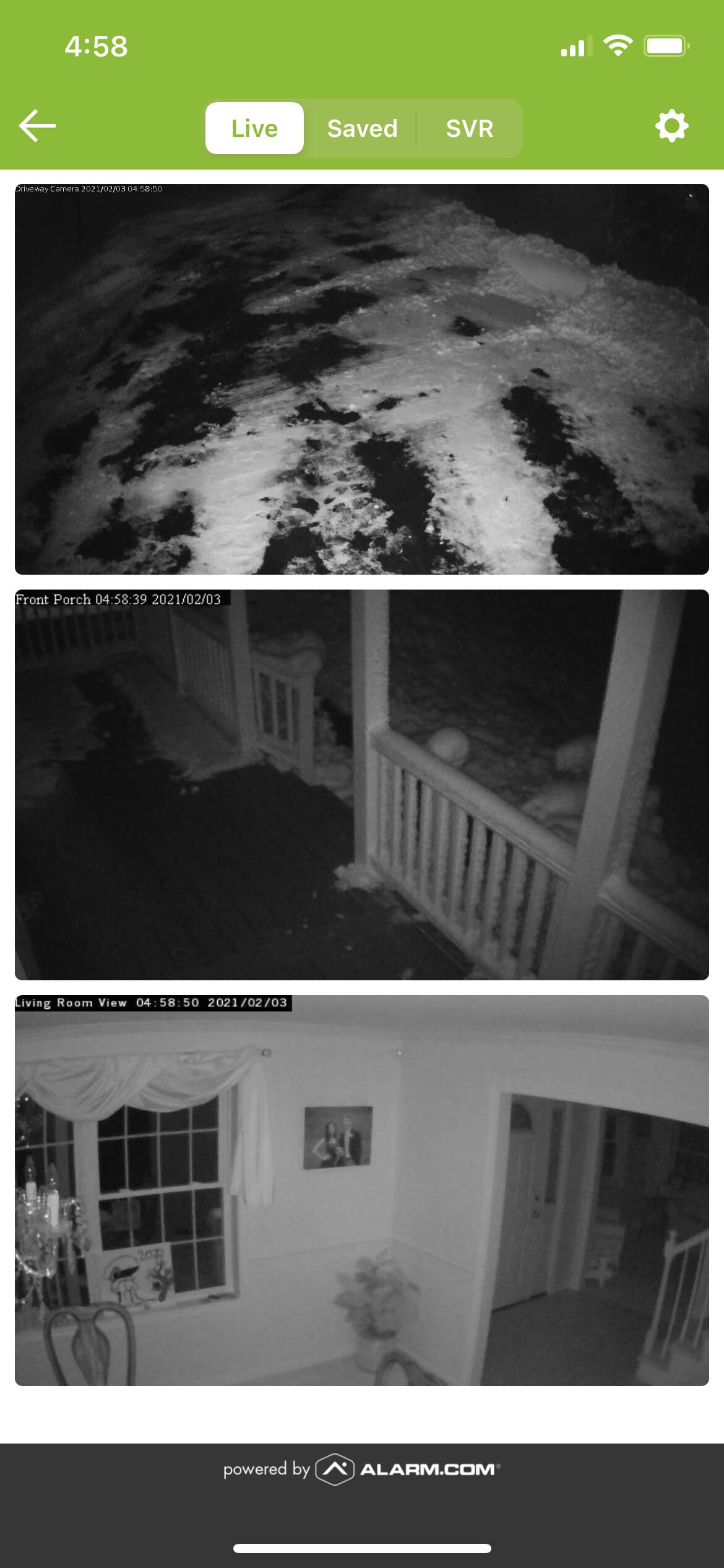

Changing the sensitivity to high definitely helps. It’s not quite as “illuminated” as my 722 camera but it’s more than adequate. In the attached pic the V720W is the center image.
