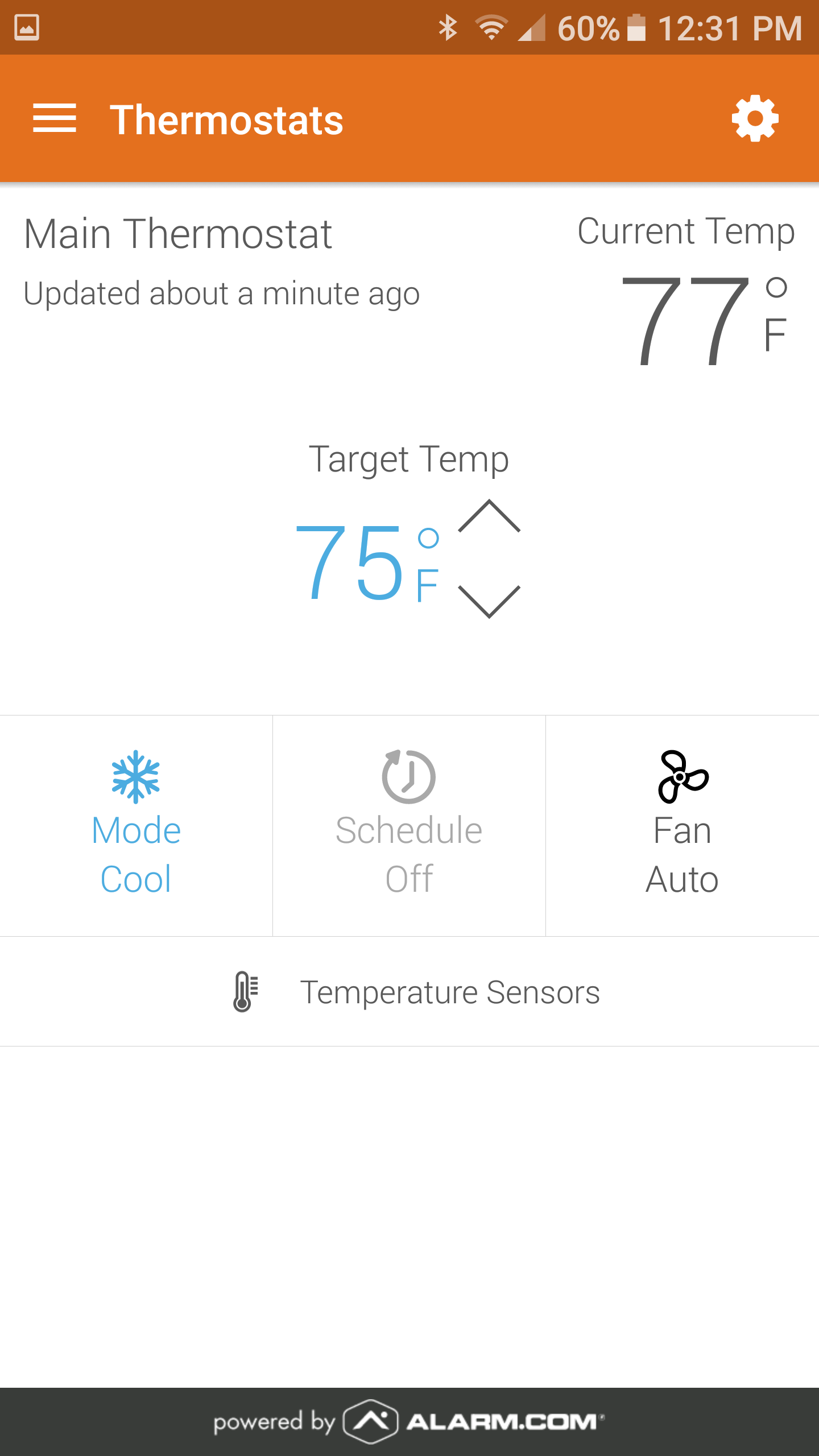

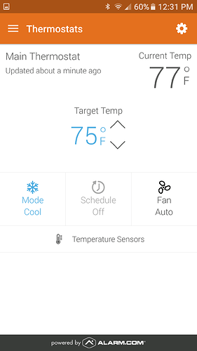

Here is a pic of the thermostat readout and my readout from my phone. These were taken at the exact same time and I had refreshed the app at least 3 times and it still wouldn’t update. It only updated when I cycled the thermostat mode.

Pic is too big. But my main thermostat shows the temp as 76*. I changed the mode to the off position to very first I was seeing the current temp and not setpoint.
Second pic try
When you notice the Tstat temp to not be matching between the app and the tstat, is it always 1 degree?
looks like this time indicates another 1 degree difference. to recollection, has it ever been more than 1 degree?
