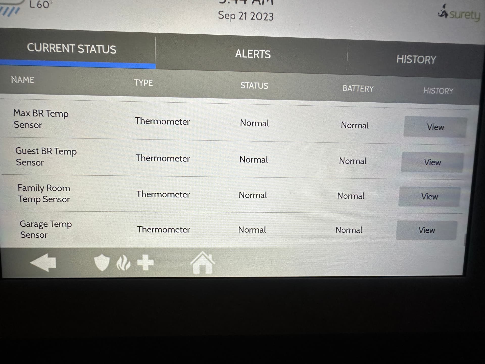

Also every single time they go off line I don’t get anything on the panel like “malfunction” they just show in the app off line and do not report temperature any longer. usually you will get red popup with number over surety logo. I don’t get that. on the panel it looks like everything is fine.

Jason same thing this morning, I also went to check the panel and it looks like everything is working at the panel just fine. picture bellow.
