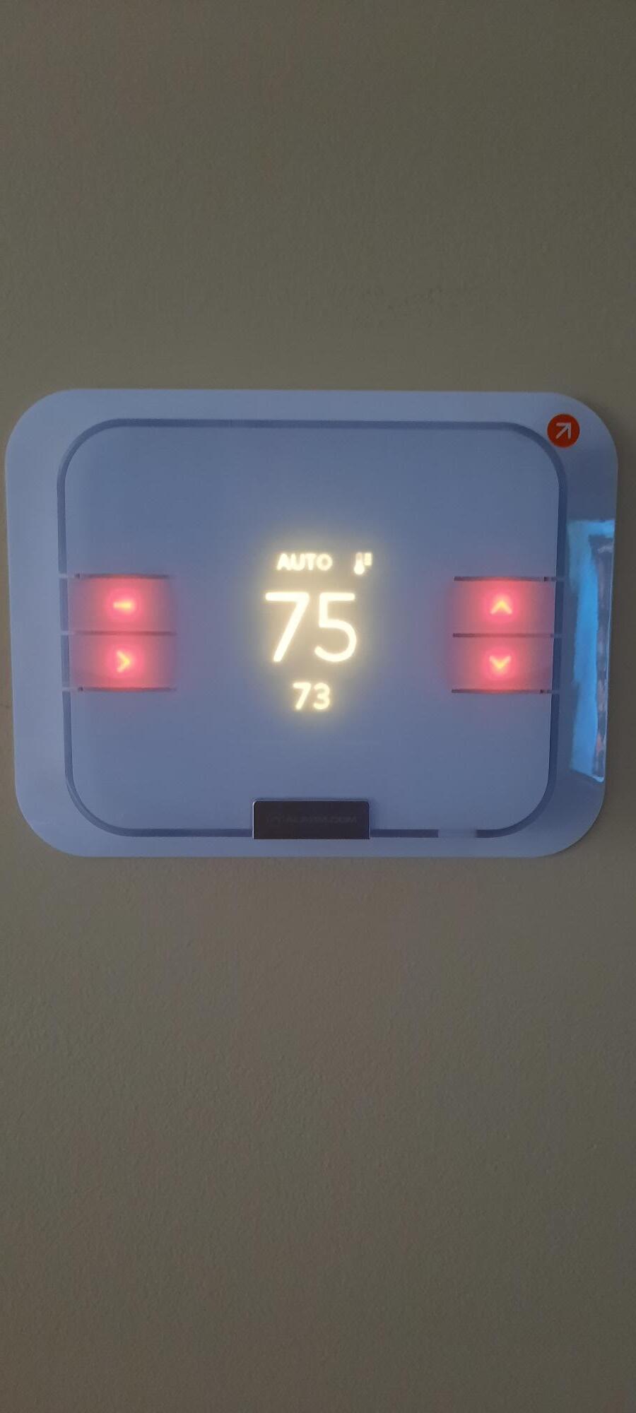

ADC-T3000 tstat - Working fine BUT ALL buttons solid red
Using 2GIG GC3-345e panel with with 2 - ADC-T3000 Thermostats. All is working i.e - yesterday before my arrival I increased temperature on both tstats they increased but when I arrived all 4 buttons are lite up solid red. Able to control from the app with no issues?
Unable to find anything on this condition/error code anywhere. Thanks so much Rob,
The Alarm.com Smart Thermostat (ADC-T3000) display changes color based on whether it is in cooling mode or heating mode. There are no settings locally or remotely to manually change the color of the display.
ADC-T3000 LED colors
Thermostat mode LED color
COOL Blue
HEAT Red
AUTO When in AUTO mode, the LED color will reflect the most recent call (i.e., blue for COOL or red for HEAT).
