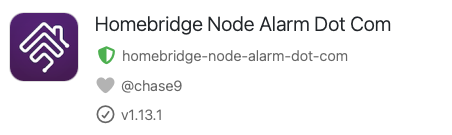

I missed that with ADC. I was able to find a nice plugin that integrates ADC - and allowed me to see and control the panel, locks, garage door, and sensors.
