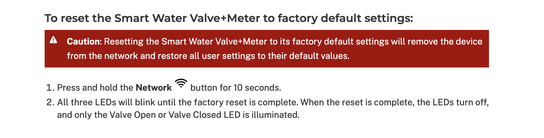

If this device repeats the malfunction and reports flow alerts when it shouldn’t, the next step would be to factory reset.
